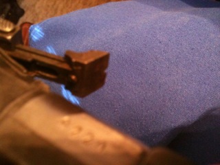

Hi,
If you look closely at the rear sight, you will see that there are 3 thin lines on either side of the rear sight and one single thin line on either side of the screw adjustable part. The screw is used to set the height of the rear sight, the lines are used as guidelines.
On my 1917 LP08 the adjustable part is set to align with the center of the 3 lines.
Sorry for the bum scan quality, but I think it gets the message across anyway
Unread 11-13-2010, 06:10 PM   #8
Gerben, I hope this helps. Regards, Norm
Unread 11-13-2010, 06:13 PM   #9
Norme, it does. Great shot

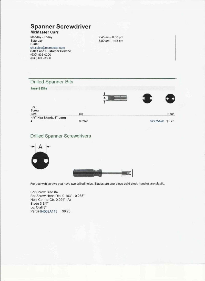

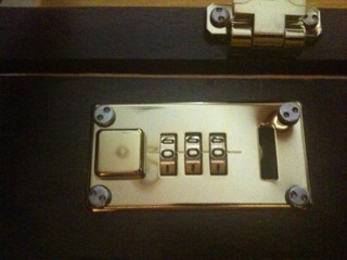

Default Rear Sight Adjustment Tool
The screw is a Drilled Spanner head (slang) (Snake-eye) also called Security screws or Tamper resistant screws. They have been used on Elevators for many years. I use them on my gun box lock I got them at McMaster Carr along with a bit. See Pic#2
When I got my Artillery I checked with them but they had no Metric drivers or Spanner screws so I paid $40 for the little brass tool.
After I got my sight adjustment screw working I realized that the screw is the exact same size as a 4-40 Spanner Head screw. (0.094" c/c holes) McMaster Carr bit price $1.75 or $8.25 for the whole scredriver See Pic#1.
As I see it I can justify paying $38.25 more and waiting a week because the round pins in the brass one are less likely to deform the edges of the holes in the screw and the pins are exactly the same depth as the holes in the screw so the brass flat of the driver rests on top of the screw. (less potential for damage) Also because I played $40 for the tool I was careful not to force it. Most important is that My $1300 Artillary is not damaged and the sight is now adjustable.
If your screw is not stuck the modern tool is OK (It is lower cost) but it sure does not look as neat as the wooden handle one I saw with a price of $500.00 or my little $40.00 brass one. Pic#3
