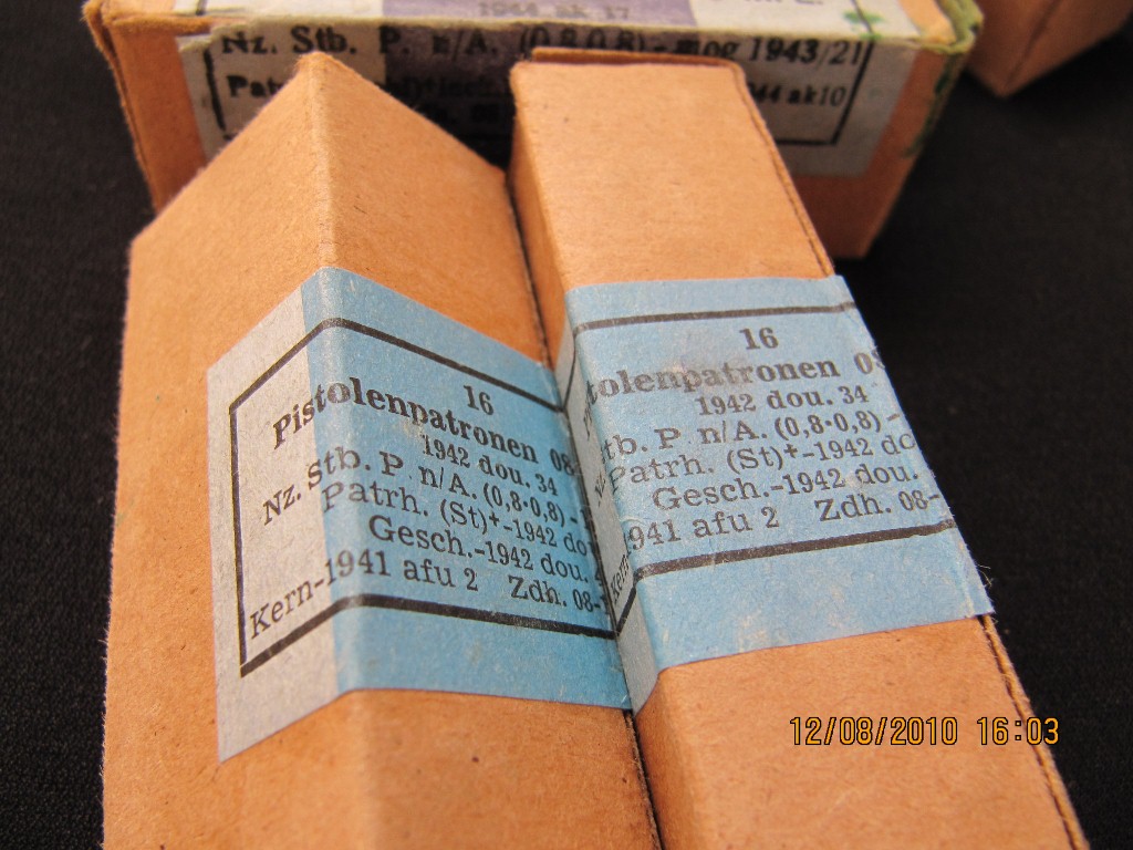

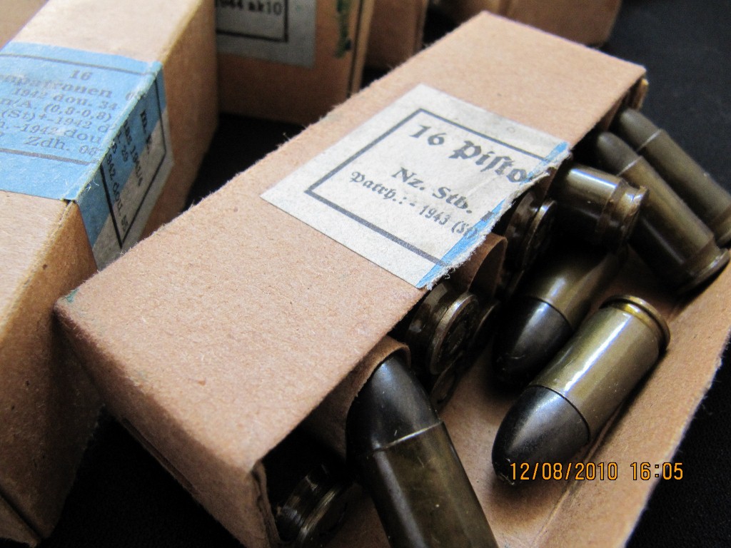

I have some boxes of ammunition from ww2,many of them is not opened.
But can I use them in my 1940 mauser Luger?
Has anyone tried this ammunition in a Luger before?

In the spirit of the FORUM, no, you should absolutely not shoot this ammunition in a Luger or any other weapon.
This ammunition is extremely collectible. If you do not want to collect it, there are ample markets to sell it. You can then buy all the 9mm Parabellum you could ever use, barring participation in WWIII. It is extremely valuable.
However, you did ask a question and I will answer it. Yes, you can shoot it if the ammunition appears to be intact. Look for leakage, corrosion, bulging, etc. But also remember that ammunition from this era is corrosive and if you do not properly neutralize and clean your gun, damage will occur. If you over neutralize, frosting of the bore will occur.

Echoing John's note, please do not shoot this ammunition. Please make it available to a collector, and buy new ammunition with the funds.
There is the possibility that the primer in this ammunition is corrosive as well. I know that US military ammunition didn't switch to non-corrosive primers until the mid 1950's, and European manufacturers didn't switch until even later. I don't KNOW that it is corrosive, but others on the forum with more expertise can followup on that.

This ammunition has some other issues as well:
Bullet type that can cause more wear to the barrel and that is outlawed on most firing ranges because of the steel core. (mE = Steel jacketed steel core. SE = Sintered Iron bullet).
Corrosion due to bad storage can take place on the INSIDE of the steel case. This may weaken the case (and spoil the load).
The German army limited the use of laquered steel cases in the P08. The P08 has a gas seal ring in the chamber that works great with brass cases, but can cause steel cases to jam. Late WW2 ammo crates carried a warning label for this.

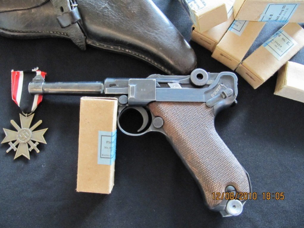

This is my Luger with some of my ammunition :

Very nice.

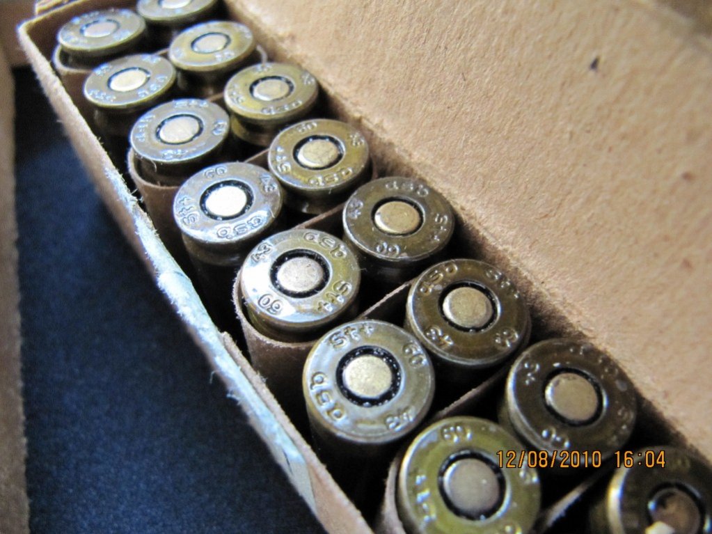

The fun part about German ammunition is the detailed information coded into the labels. They describe the manufacturers of all components.
''asb" for exampe. visible on some of your cartridge cases, is DWM itself

Definitely do not shoot this collector grade ammunition, and if you want to retain the value, do not break any more of the paper seals holding the boxes closed.
I don't know how many boxes of this ammo you have, but in the USA each box may be worth $20 or more to a collector depending on the condition.
This ammunition is definitely corrosive primed...
In What country are you located?

Vlim: asb is DWM this was new for me.Thank you
