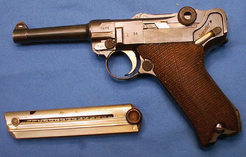

I was at the Colorado Gun Collectors annual show, with another Forum member. Ya meet the nicest people here. We looked at Navy's, Simson's, Swiss, all kinds of stuff. And I learned a lot. But right at the last my new friend spotted this one. I was slightly vision impaired having caught a dog paw to the eye the day before.
A 1917 Erfurt all matching inc. mag. for less than $1500! I took it home. It was so filthy/cruddy, I stripped it down and took it outside with a can of carb cleaner. I think it came out pretty well.
But a few questions: I cleaned the grips with Murphy's oil soap, and then gave them a coat of linseed oil. The left came out fine. The right is blotchy. They are both numbered to the gun, but obviously came from different parts of the tree. The right is a little chewed up, and looks like it may have been used in a spring clip type holster. Another coat of oil, or redo with the paint remover?
Or leave it alone? I can see where late in the war, things did get a little sloppy. The checkering is not uniform.

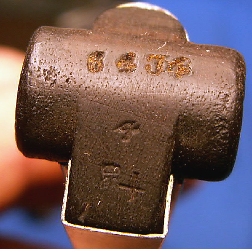

I've examined the mag bottom under 10X. At first it looked re-stamped. Now I'm not sure, just chewed up. It is an Erfurt proofed mag, with a G suffix. comments?

Fred, Nice pistol..No matter how the mag got that way, it's a tad buggered for sure. Almost has to be an attempt at renumbering but the suffix is good.

Too bad they had to screw up the mag.That is a very smooth 1917.
I would leave the grip alone.

Mag is definitely renumbered.

Hi Fred, The gun sure cleaned up nice. The grips don't look too bad to me, and I don't believe that mag has been renumbered. It's a correct Erfurt mag with one inspection mark, as is proper for 1917, and has the same suffix and identical font as the gun. Best regards, Norm

You commented that you don't believe that the mag has been renumbered. I am fairly new to all of this. To me it appears that the mag has been renumbered. What am I not seeing?

Well, the metal is good. The proofs are correct and where they should be. The inspection stamps are C/?, C/O, C/ P. The first letter could be B, D, or F. 'Central Powers" pg 442 has the same ID problem with numbers close to this one
While I'm not qualified to rate, the finish is somewhere in the low 90%. One grip may be beech. It has a more yellow cast to it on the backside. Did they mix grips towards the end?
In the photos the mag definitely looks buggered. I did clean that with the wood soap and a nail brush. Yet the proof and the suffix are correct. So that's OK with me.

Someone tried to "freshen" the numbers, which were probably filled with grease (As Norm pointed out in his initial cleaning of the gun). They used a pin or a sharp object, which now makes them look altered.
I say correct matching mag, which previous owner should have just left alone.

I don't see how this can be called a matching mag. The photo clearly shows that the last number was originally a 3 or an 8 which has been badly over stamped.

Hi Aaron, I believe that the treatment with Murphy's Oil Soap caused the exposed grain in the bottom of the struck numbers to rise, making them hard to read. As you probably know, walnut gun stocks are alternately wetted and sanded to remove the raised "whiskers" prior to sealing. I was present when FNorm purchased this gun, and can tell you that the magazine looked very different before cleaning. Regards, Norm
