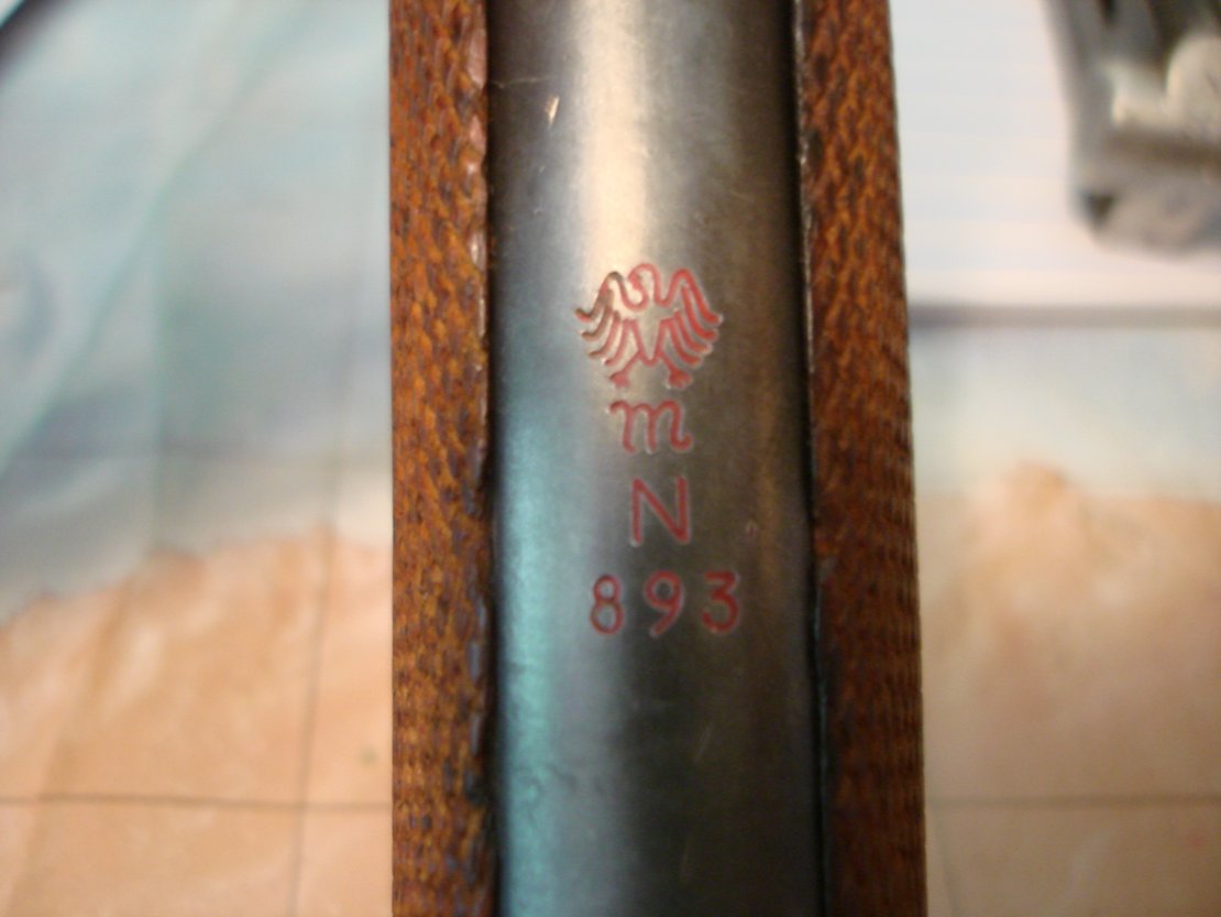

Hello, seeking expert opinions on the authenicity of this possible gem. I have received some opinions that the magazines are no good. What say you?

I'm no expert, but I'd expect the spare mag to have a "+" ? And, the stick eagles look different (right one looks wider?) (edit: and as Tom points out in the post below, stick eages are not correct for G Dates)
The eagle over m on the strap doesn't look good.

Like Lugers, I would run away from this one.
The magazines are all wrong. There should be indications of a spare "+" below the number ans a "X" after the Navy Number.
Tom is correct with respect to the Waffenamt Marks. Should be DE/211 or DE/154.
The front grip strap marking is also wrong.
RUN, RUN, RUN!!!!!

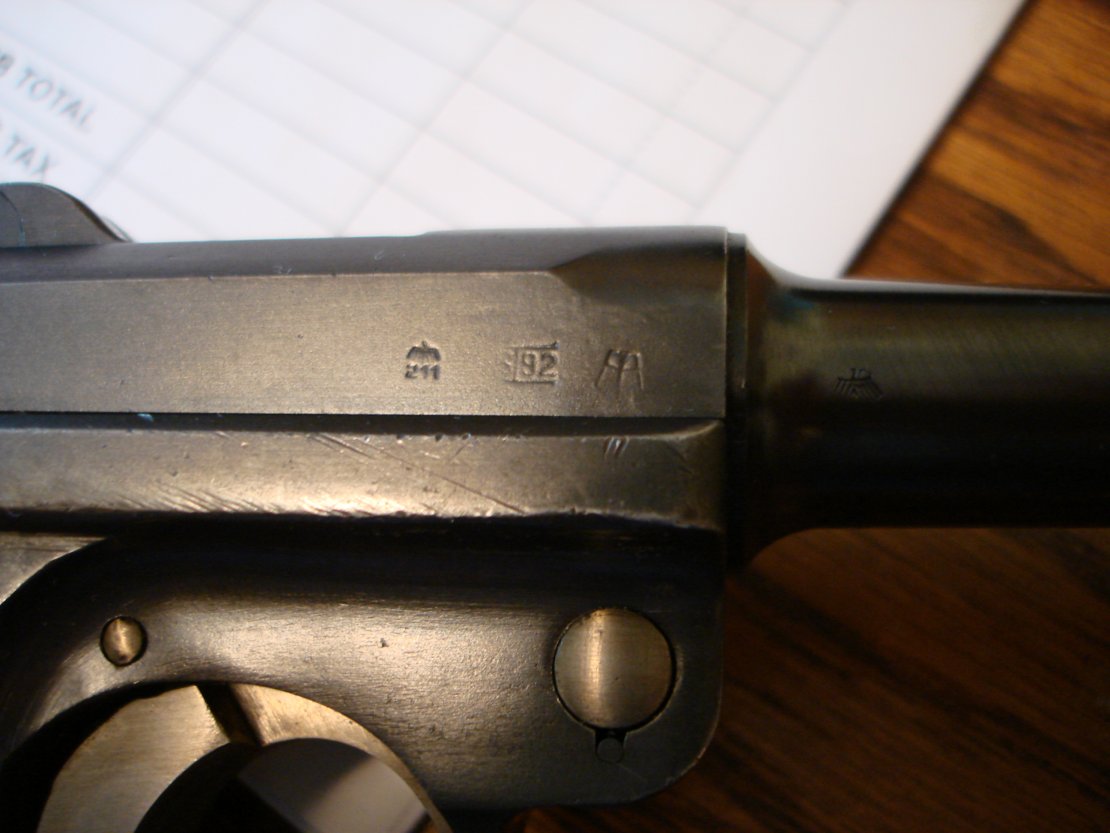

I'm curious about the stamp on the left side of the barrel. Do you have a photo of it?

The "wings" of the chicken on the backstrap (or is it the frontstrap?) are not symmetrical...but it is surprising to me that the lines are so well defined, cartouche and letters/numbers...this is a curved surface; stamps would not work, they must all be engraved, probably by mallet & chisel...maybe by a Dremel-like tool...It is art of its kind, but probably not something anyone other than a police agency would want to collect...

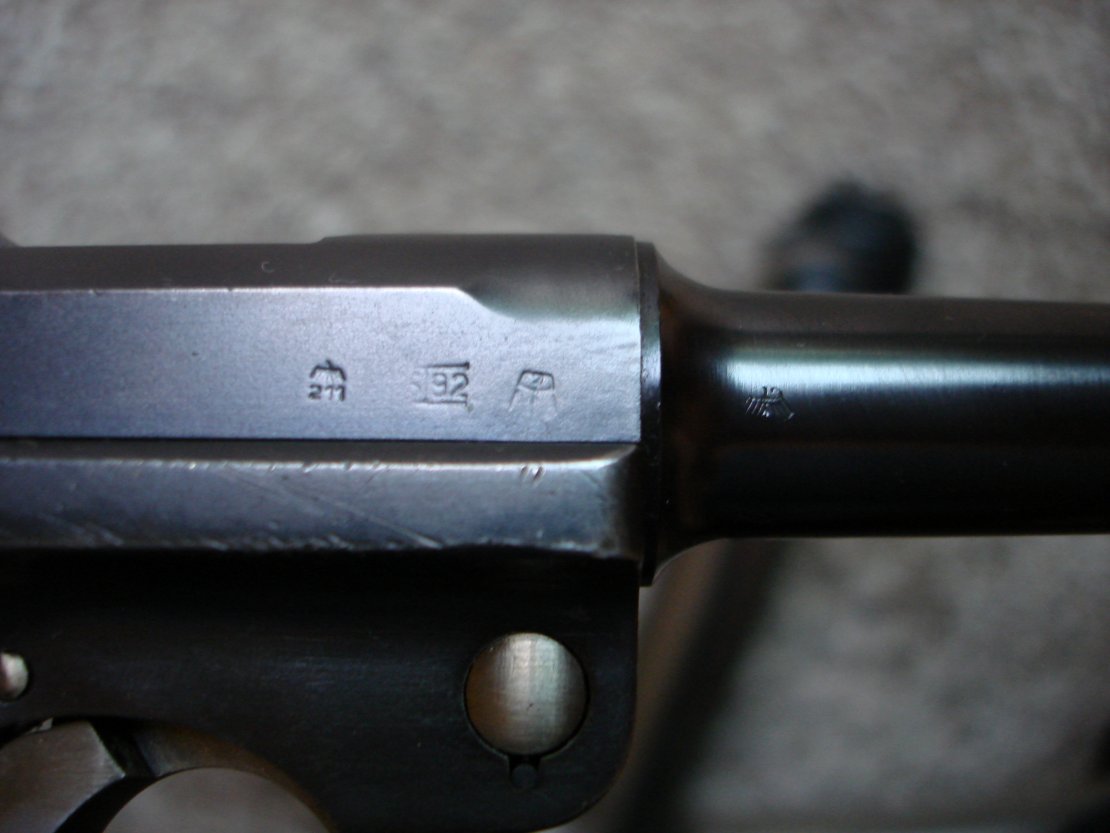

Here are a few more shots. It is the front grip strap that is marked. There are no marks on the left side of the barrel , only the eagle on the right side-hard to get a good shot of.

fred p: S/42 toggle is correct for a G Date.
Likelugers2: it's possibly not even the original barrel... the stamp (if that one is correct) on the right side I believe should be rotated clockwise 90 degrees, and I believe there should be a 211 or W154 stamp on the left side (I was just curious if it had an incorrect S92 stamp on the left side as seen on another faked KM G Date).

Unread 06-03-2010, 11:38 AM   #11
I think Eric is right, the barrel is a replacement. It is missing the bore gauge marking. Regards
