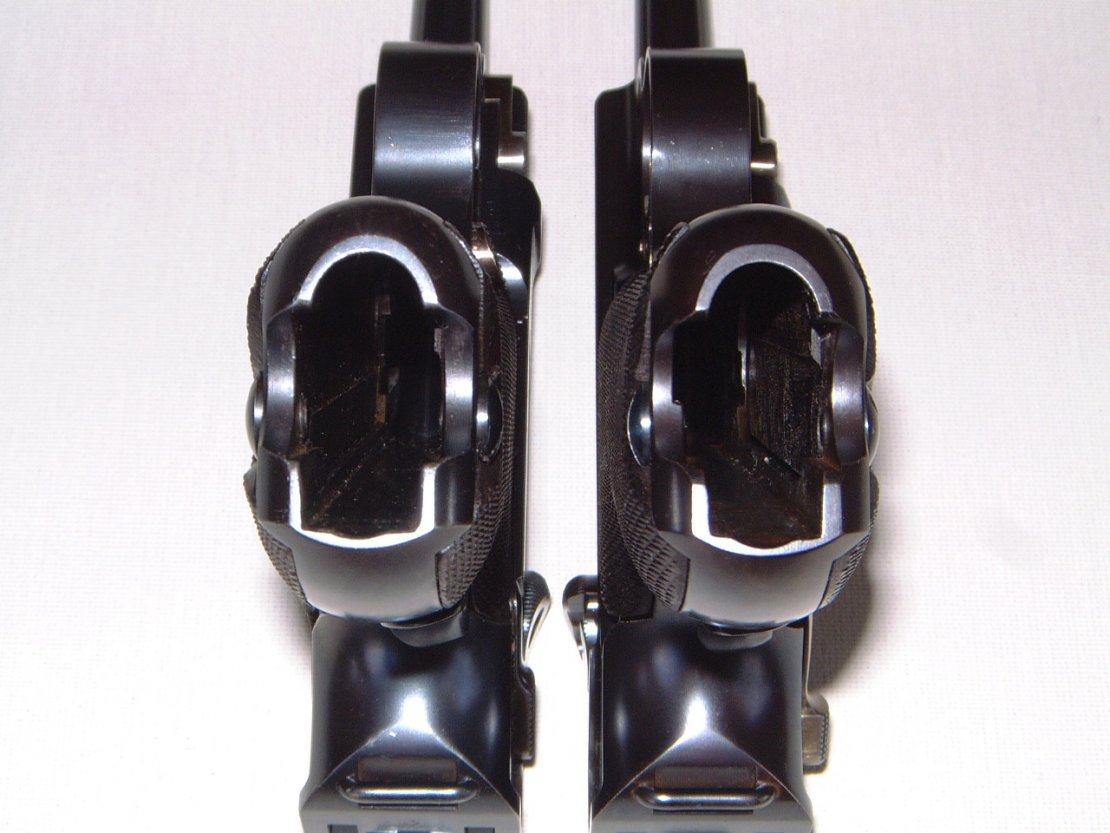

Swiss military serial numbers started at #1. Need to see clear photos of the left side of the receiver and bottom of the barrel to determine if this gun is military or commercial.
The magazine appears to be of the early flat button type but we would need to see the other side of the magazine to tell for sure. The frame has been relieved for the later type of magazine.

Tom and Doc are correct, it is positively military. It is a superlative gun with excellent early features, i.e. Type I flat thumb safety and genuine flat button magazine. The frame has been relieved for the later type magazine, but this is of small consequence. The magazine alone would have the value of a good shooter Luger. It is a delight to see such a noteworthy example. Thank you for sharing.

Ron, you tell me the frame has been relieved for the later type of magazine, I'm not sure what
to look for to see this. Can you elaborate please, what am I looking for?
thanks,
Mark
wildoats is offline   Reply With Quote
Unread 05-31-2010, 02:23 AM   #14
In Ron's great photo of two side by side magazine wells posted above, look at the right hand gun at about 10 oclock in the mag well opening. You will see a cut there that is not present in the left hand gun's mag well.
This cut allowed a larger magazine button to slide into the gun.
