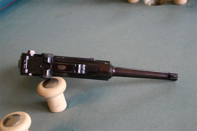

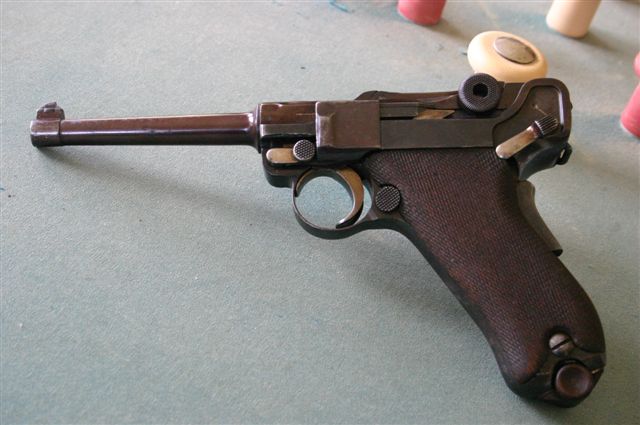

I'll attach photos of what I think is a 1906 30 cal Brazilian Luger. It has a "B" stamped on the left side of the receiver, no other markings other than "DMW" on toggle. I am also interseted in the bluing condition. It looks pretty good with some pitting on the barrel, and some light ware on the frame and grip safety. The frame its normal looking dark blue, but the receiver, toggle, and barrel are more of a purplish blue and highly polished. Is this normal? I have taken it down and "ALL" the numbers I can find match, barrel, frame, grip safety, toggle, etc, even the clip. I don't know if it has been refinished, but if it was, it was a long time ago.
Also any clues to value?

I have found that quite a few Brazilian Lugers are refinished. The high humidity and tropical conditions were not kind to the guns, particularly those carried regularly in leather holsters. Consequently a significant number of them were refinished in country with a salt blue process rather than the original rust blue. This refinish varied quite a bit according to the skill of the refinisher and the amount of deterioration that needed to be fixed. The contours on your gun appear to be well preserved and the "B" is still visible so evidently some care was exercised in its rework. It is nice to find these guns in original condition, but they are quite scarce. Refinished Brazilian Lugers reflect their history. The condition of your Luger appears to be among the better ones.

Mostly Brazilian Lugers I have seen are refinished. Even to find a matching gun is a tough mission, as many had their parts "cannibalized" to be used on serviceble guns. They serve for more than three decades in the Brazilian Army, under very variable and rigorous weather conditions (from the rainforest in the North, to the semi-arid Northeast, up to the colder and and tempered Southern areas).

took the pistol to the range today. It shot very well, only a slight problem with the original clip not allowing the round to chamber from open bolt. with new clip, it worked perfectly. From pass experience, the top of the old clip needs to be bent tighter because the round is sitting to high. The cases expanded about .002". Might get the barrel relined to improve rifeling if I can find some one that can do it with the original barrel. But for now, very satisfied with how it work for a 100+ year old gun. Will probably just keep it as a collector (investment).
