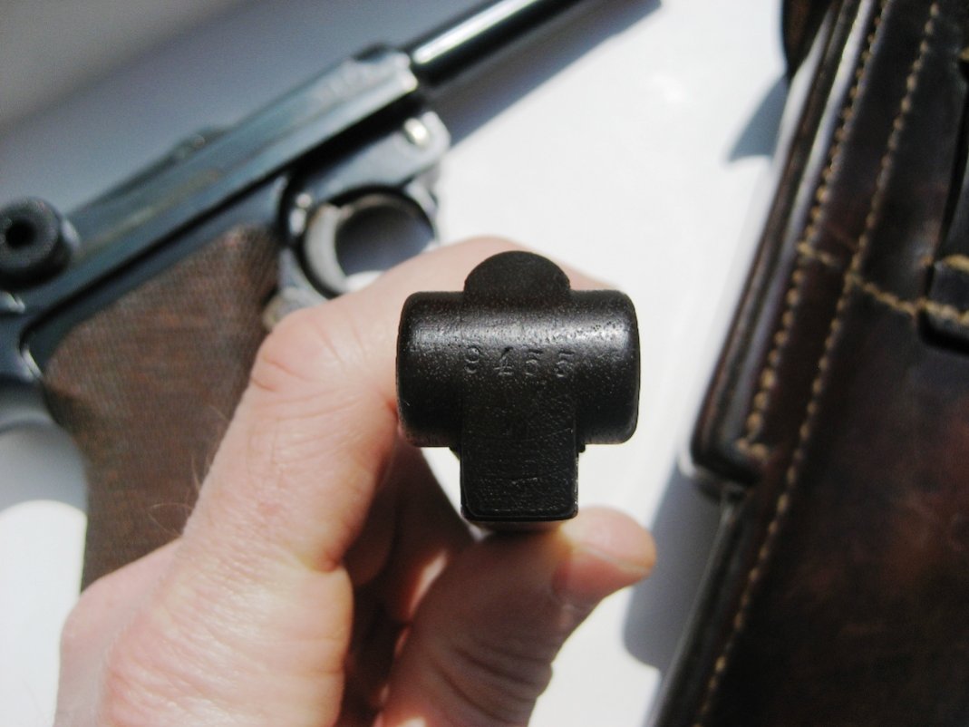

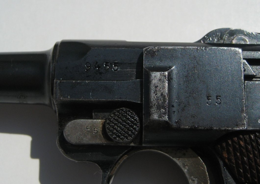

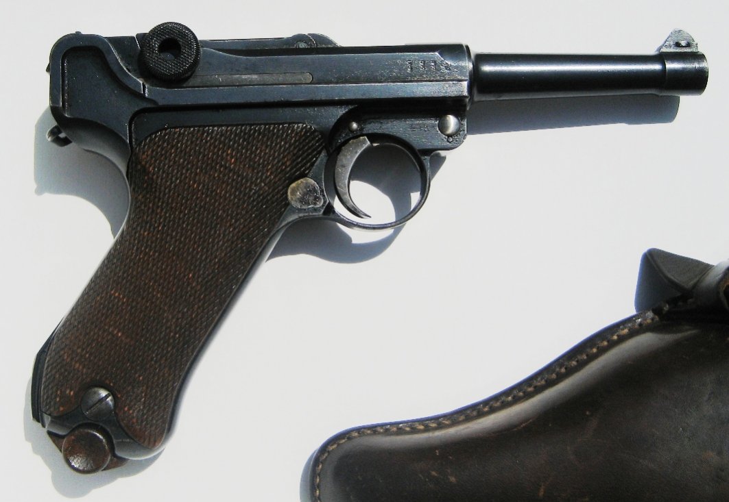

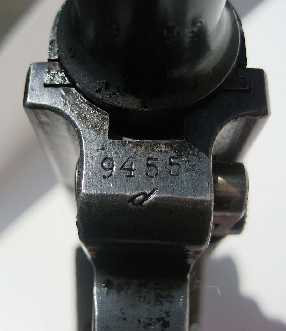

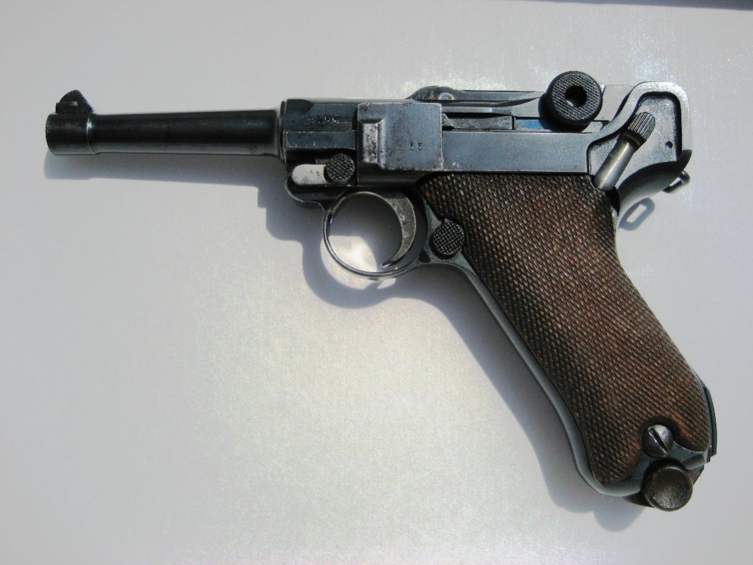

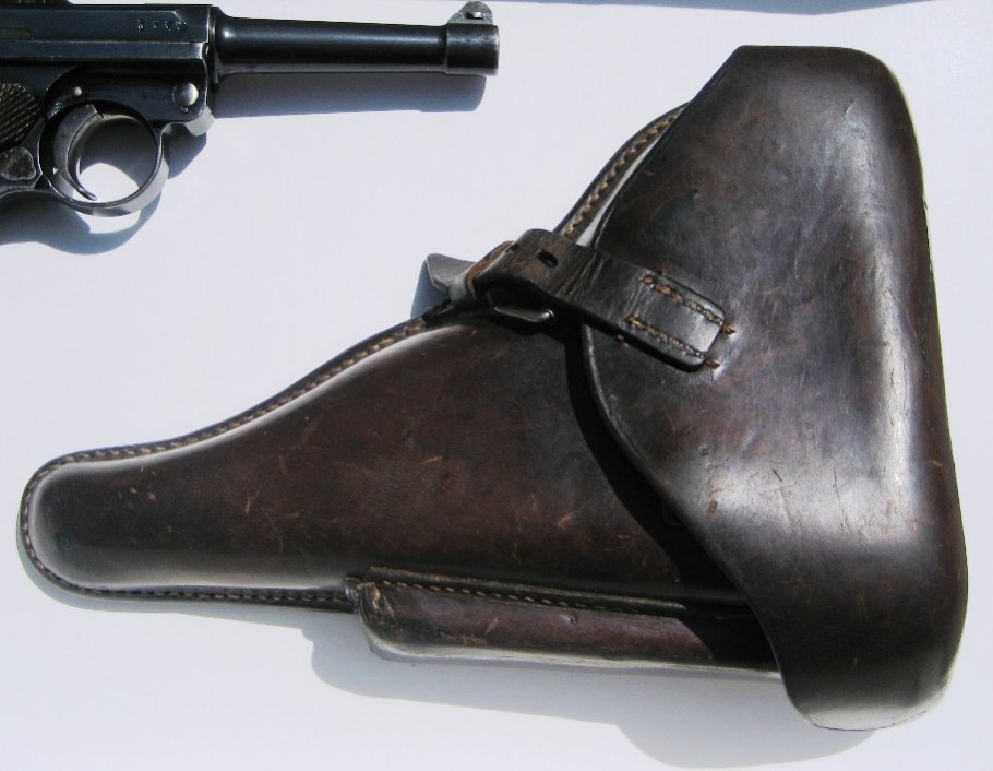

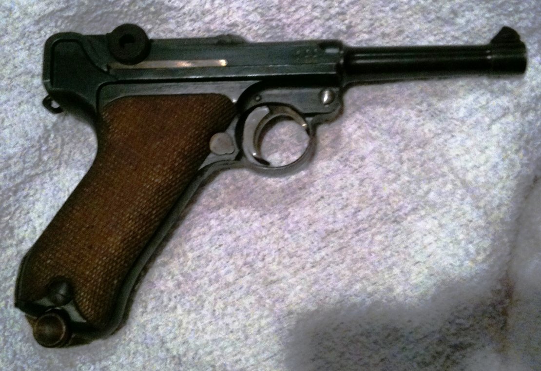

I recently inherited from my (great) uncle who was a Battle of the Bulge participant/survivor, several 'souvenirs' including this 1917 DWM Luger as well as a holster (both pictured). The s/number on the gun is: 9455
I have been a modern gun owner for years and these are a chance, but welcome addition to my collection.

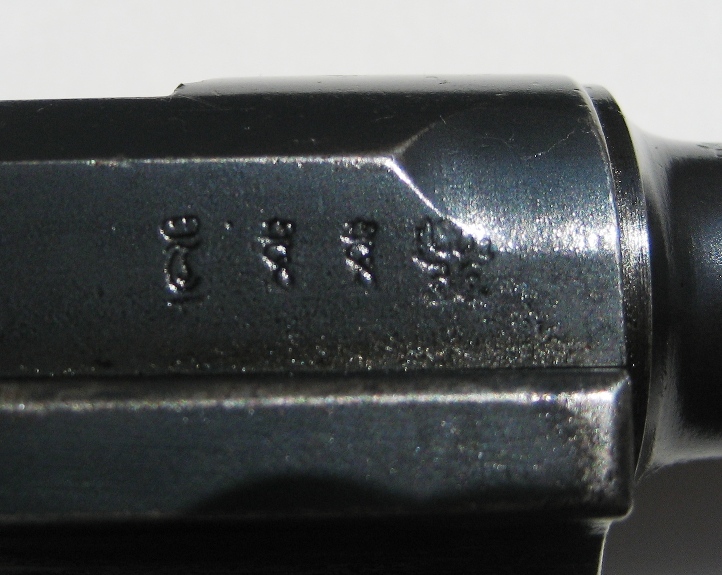

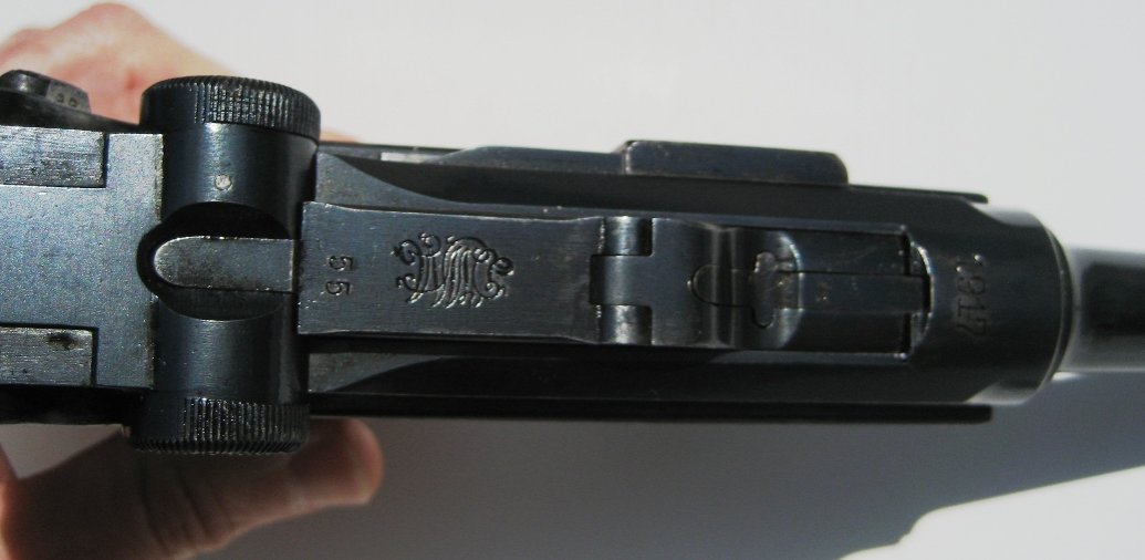

The gun has all matching parts (including the clip) and has several markings on it (pictured) that I would like to have identified? I had a gunsmith inspect it and he mentioned that it was about 90-95%? I believe he was referring to the bluing?

At some point I seem to recall when he described acquiring these 'souvenirs' that one of them may have come from an officer. Is there any way to tell by the photos and/or markings whether this is in fact the case?

Nice looking piece. DWM made about 90,000 of them in 1917. Matching like yours is rare. The 1939 Erfurt is, indeed a parts gun, as Erfurt didn't make any after 1918. So you have a 1939 frame with an Erfurt toggle.

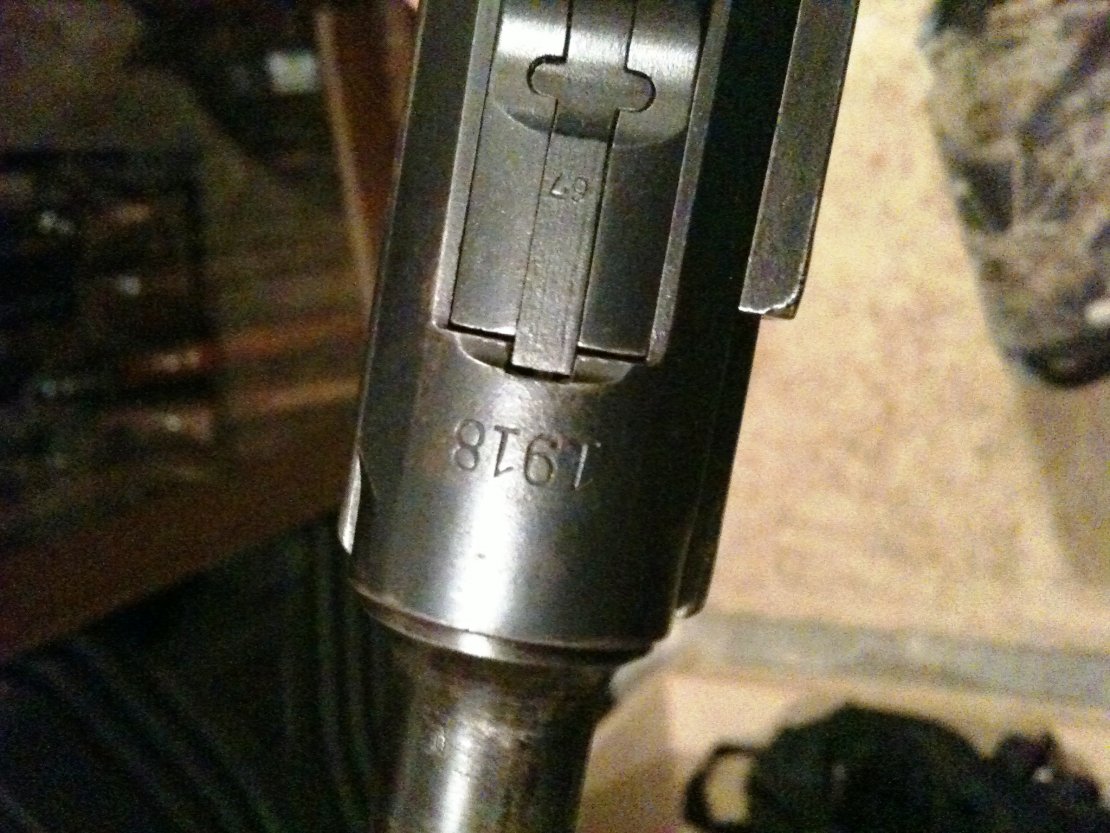

1919 DWM?. Better check that one. Could it be a 1917? Or a 1914?

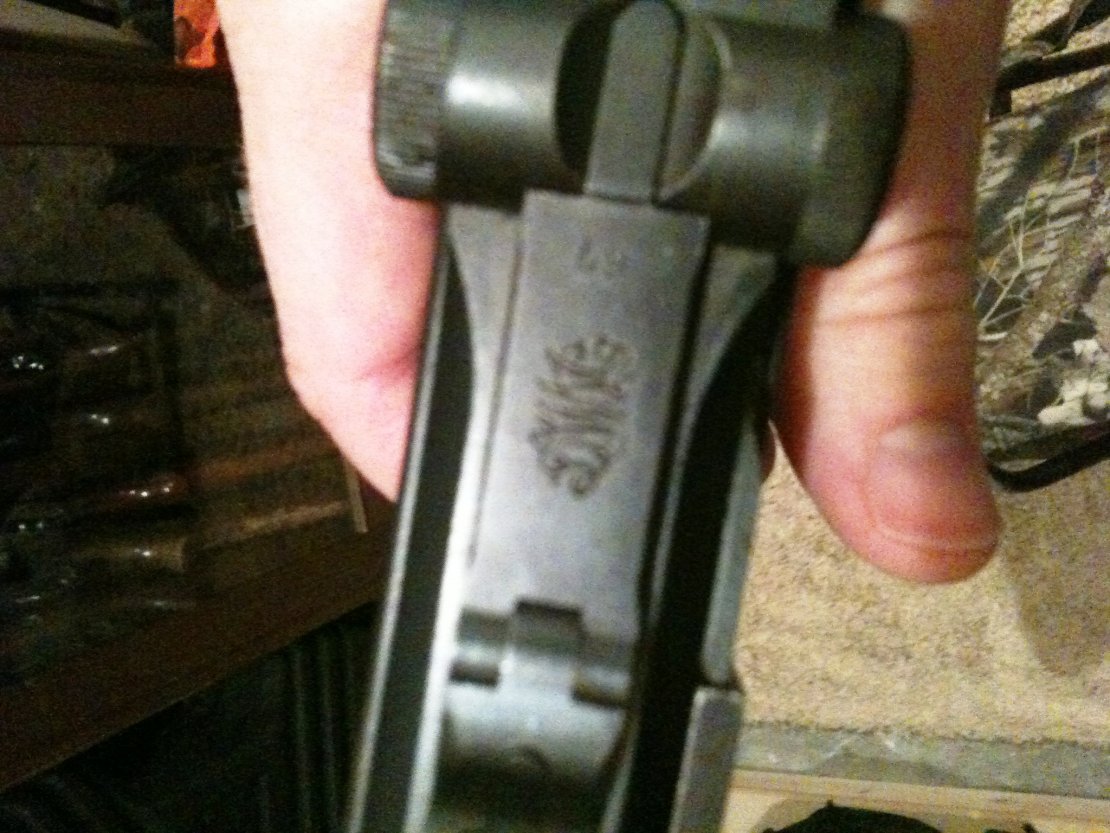

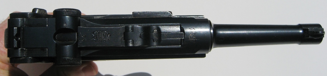

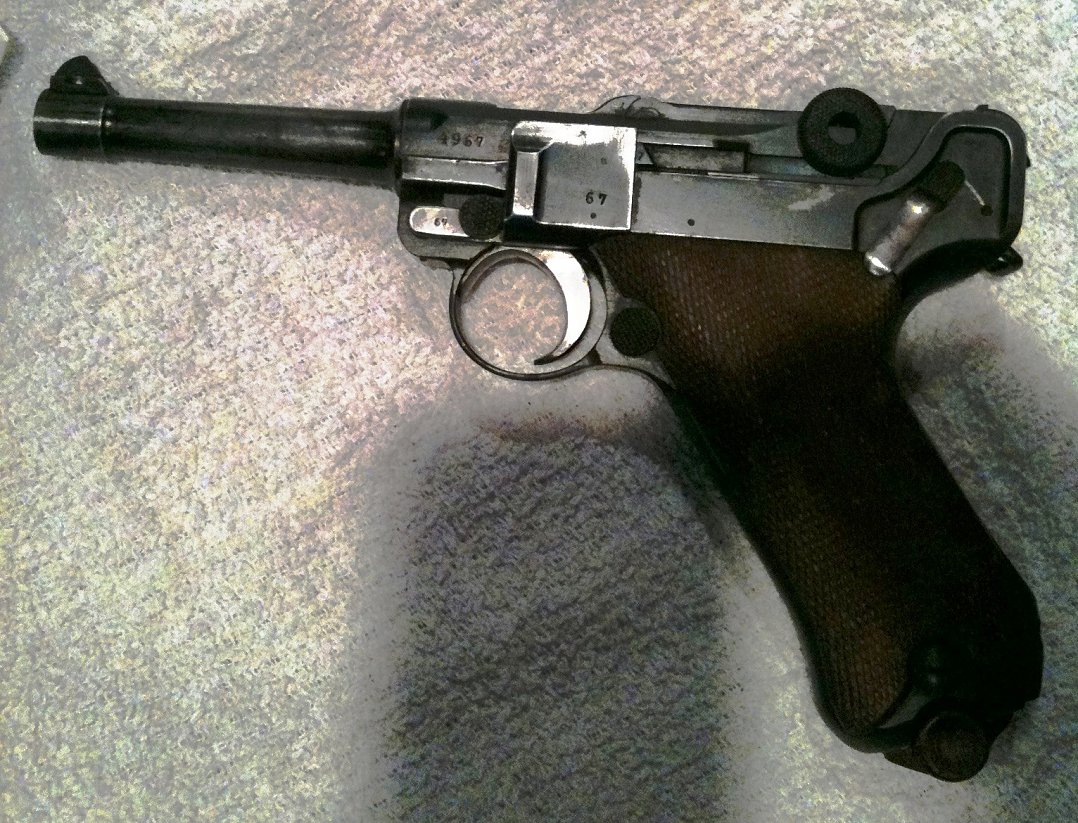

I appologize for the delayed response- Yep, sorry. The other DWM is a 1918 (not 1919) S#: 4967 , thats what I get for trusting my memory.
Included are some pictures of it, although not quite as good as the others. Can you reccomend the best way to identify/get info on the marking photographed in my original post?

Hi Brian, The symbols on the right side of the receiver are proof and inspection marks. There is no way to tell who the original owner, or owners, were. Matching magazines on an early gun like this are rare, and the holster looks nice. Regards, Norm

Brian,
The marks read TSS, or as we would call it, C/T, C/S, C/S that's 'Crown/S', etc. Those are the correct proofs/inspections for a 1917-18 DWM. The last mark is the firing proof for DWM. Should be one on the rt. side of the barrel, and the left side of the breech block too. The Erfurt eagle was a little bit different. But some of the barrels/breech blocks could have the Erfurt eagle, and still be correct.
Are there any marks on the grips straps? That would be the only thing that could tell us where this pistol went after the factory. There were no special 'officers models'. Except for some gussied up presentation models. Nice family heirlooms!

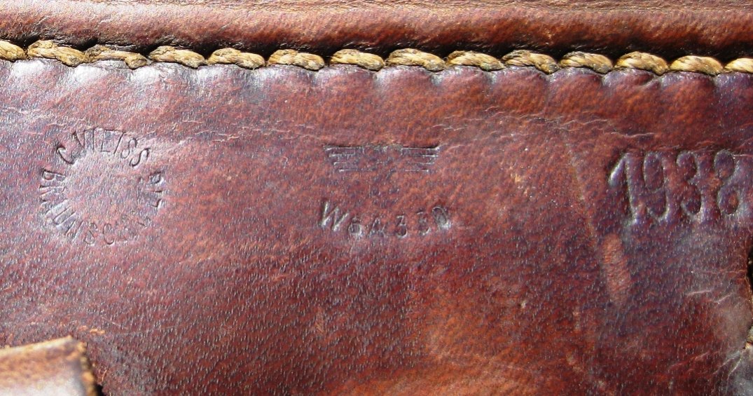

Welcome to the forum. The condition detracts as a collectable item, although its value is still around $900-$1000 because of its matching magazine. The holster, if not cut down inside or modified is worth around $150-$200.
Unread 04-29-2010, 01:30 AM   #7
Brian, Holster looks a little better than average. One would have to see the top open and a full view of the back to actually determine a price.
