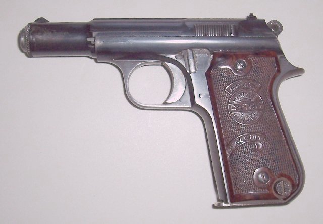

I picked up that Astra 4000 "Falcon" today; looks in good shape, but I do need to clean it...
Edit: OK, got it field stripped & cleaned. I found a takedown procedure for the Astra 300; it was close enough to get 'er done...
The oddity that had me stumped - the Astra's use a 2-piece barrel bushing...

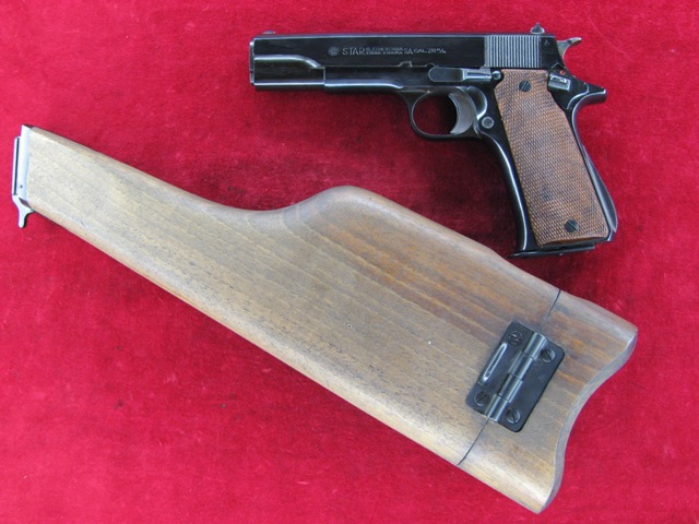

Would like to use this oppertunity to ask a question on STAR.
Is the gun in the following link a legitimate animal in the STAR family?
Link: STAR with Shoulder Stock
I am not familiar with either, but it looks to me to be a Browning/Inglis HP stock...which the Star MMS should fit...I wonder if the "7.63mm" stated in the ad is actually 7.65mm Luger?...

STAR did have 7,63m/m version. If we consider Mauser created C96 targeting on winning a major western power's military contract, then, Spanish gunmakers created their 7,63m/m pistols on target of gaining Oriental market in 1920s. STAR was one of them but they missed the point. According to Gun Report, STAR's 7,63 was initially driven by that.
Simpson has another STAR with extended barrel listed(Link: STAR with extended barrel). I saw that gun a few years back selling for the same price at the same site. It was sold. Current one is probably the same one, back to market again, and asking the same price.
First time seeing a STAR with stock though.
