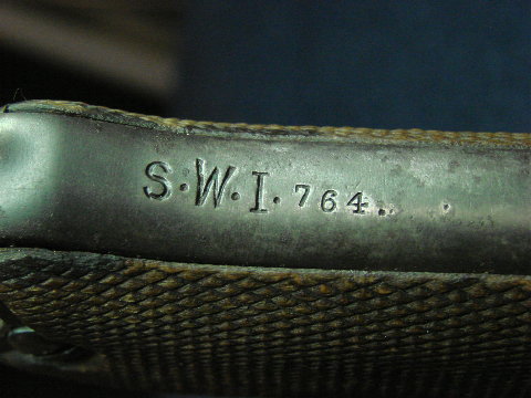

Today, I found what I think is a police luger. It is a commercial model with 1921 on the chamber, s/n--87156. It has the sear safety and the magazine safety. I'm guessing it's about 90%+ and the straw and bore look good. All of the numbers found match including toggle pin, firing pin and the No. 2 police magazine. However, I find no numbers on the safety lever and the little tab that comes up when the safety is worked. There are no markings on the hold-open or the grips. Someone has recently done a crude job of enlarging the right grip opening for magazine release button. The front grip strap marking is S.W.I. 764. He wants $1,100. Comments please

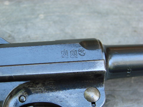

John: The only thing that is stamped on the frame front is the serial number--87156.
Don: On the right side of the receiver is the double dove and buzzard markings. In fact, it is marked like the one shown by Hawaiico in his post entitled Dwm 1921 dated 12-20-2009 (just search Hawaiico). His s/n is 87191, which is very close to the pistol in question. There is nothing on the left side except the serial number.
The bottom of the barrel just has the serial number and 8,83. On top of the barrel is a mark just like the one shown on the fourth photo down in the post by charly239 entitled 1921 DWM curious proofmarks, dated 09-06-2009. I haven't been able to find this mark elsewhere.

Unread 04-08-2010, 04:57 PM   #7
Don M
Don M's Avatar
Join Date: Aug 2004
Location: Houston, TX
Posts: 1,429
Thanks: 67
Neil, in one of the replies in Hawaiico's thread, Dwight Gruber indicated the barrel stamp is an incompletely struck Weimar firing proof (the so-called buzzard). Yours is probably the same.

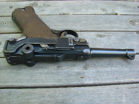

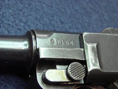

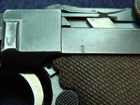

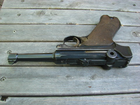

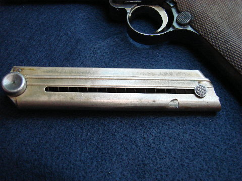

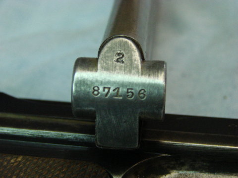

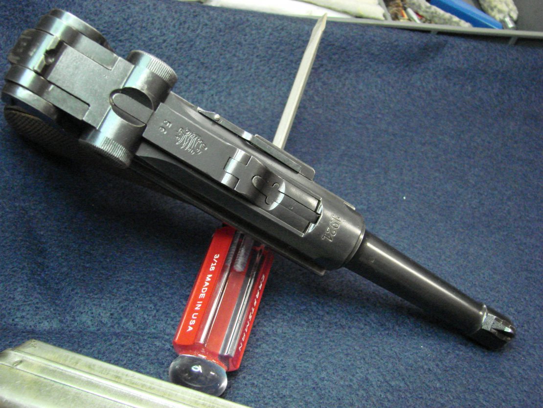

Okay, you guys knew I would buy it--I got it for $969. Check the photos--I think that I did okay, or at least I hope so.
Thenks.
Neil

Unread 04-09-2010, 09:48 PM   #9
Don M
Don M's Avatar
Join Date: Aug 2004
Posts: 1,429
Thanks: 67
Neil, ya done real good!

Unread 04-09-2010, 09:50 PM   #10
Shouldn't an original DWM magazine have a wooden base? Was the s/n added to a Mauser magazine?
Unread 04-09-2010, 11:10 PM   #11
Don M
Don M's Avatar
Join Date: Aug 2004
Posts: 1,429
Thanks: 67
It is an arsenal replacement mag. Perfectly proper for police Lugers.
