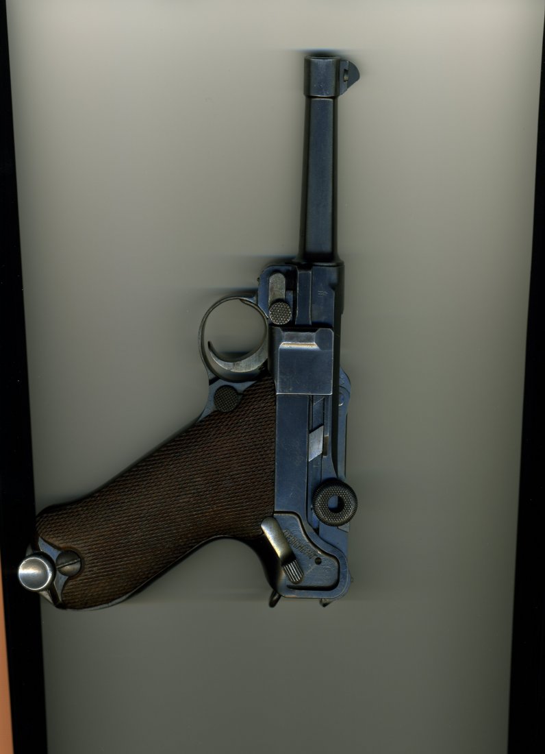

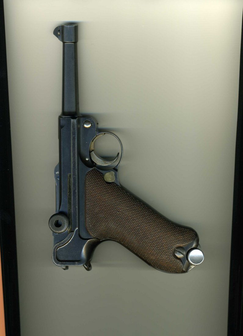

My father recently passed, and left me a Luger. (I'm a total novice to pistols) I've searched on the web for info, but it's a bit overwhelming. This is what I know so far:
DMW on center toggle link
Crown with capital "N" under it: upright on left side of barrel extension, sideways on left side of breech block, and again on underside of barrel
"9403" underside of barrel below crown N stamp and again front of frame
03 appears on several smaller visible parts (I haven't broken it down yet)
Grip has a capital M over an anchor (which is why I'm assuming this was a naval firearm), and "N.339" below that
I have the original documents granting ownership of pistol to WWII vet dated FEB 12 - 46
I'd like to know manufacturing date and any detailed description if possible, as well as an approx value (or range at least)
I'll try to attach scans
Thanks in advance

Dave, welcome. From your discription, sounds like you have a Weimar era 4"navy luger. More close ups of all proofing, including the gripstrap mark, bottom of mag, front frame ser# are nessessary for an acurate estimate of value. Looks like a good 1938 navy holster, worth a fair buck in itself, again more photos. The capture papers ad a bit to rig value also. If all correct, I would venture to say 2500- 3000 for the rig if correct. More close ups are needed of this luger. John

Dave,
I agree with John. A very nice and desirable piece to have, if all original and correct.

There is a good discussion of Navy Luger marking in this post:
http://forum.lugerforum.com/showthre...ghlight=anchor
There were addressing a question about the WW-II era, but describe how Weimar era re-worked Lugers were marked by the German Navy.
The "N.339" would be a unit property mark associated with the North Sea command.
The "Crown/N" or "C/N" marking is a Nitro proof marking indicating that the pistol passed high pressure testing.
The Weimar era guns were manufactured after the end of World War I and before 1929 when Mauser purchased the DWM Luger manufacturing equipment and tooling.
Many WW-I Lugers were refurbished since Germany was inhibited from re-arming after WW-I.
I'm just starting out researching and understanding Lugers. This site and Jan Still's forum site have tremendous resources, and are frequented by international class experts.
The Navy Lugers are more rare, and your gun has not been "messed with" (refinishing reduces it's value). It looks to be in very good condition, as does the holster.
The papers add to your gun's value also, giving it provenance.
After ensuring it's not loaded, you can disassemble it to verify that all the parts have matching numbers (most will have the last two digits of the serial number, or the entire number). That makes it more desirable and collectible.
The magazine bottom looks like WW-II vintage. It's not likely to have a matching number on it's base.
Be very careful disassembling your gun. It would be a good time to ensure that it's clean and that parts have a light oiling with a rust preventing oil like "RemOil". I would tend to store the gun and holster separately.
