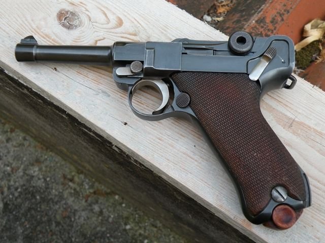

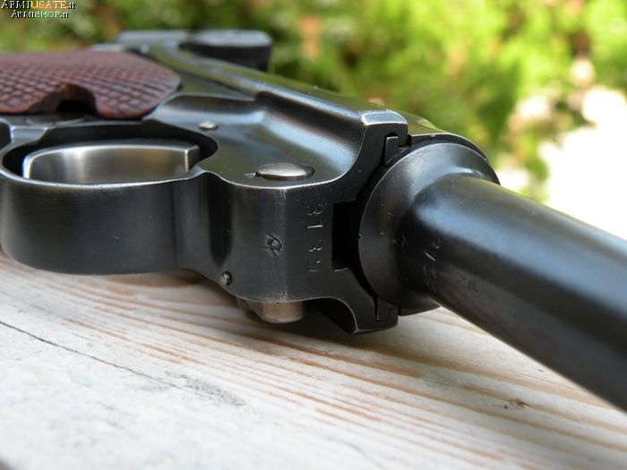

Hi there, I own a commercial alphabet DWM, serial number 3139 suffix q, it is a Finnish Luger (marked SA) and has the proof stamp C/N.
The caliber is 7,65 Parabellum.
If it is possible, I would like to know the year of manufacturing.
And also is it a common or a rare gun?
It shoots well and the blue is about 97%, the straw looks a little wear. It has a magazine with wooden bottom, with no serial number. All parts are matching and everything looks original, probably except one grip.
Approximatively, which value can it have?
Thanks in advance

That is one of the best looking Finnish Lugers I have seen. The fact that it remains in 7.65MM Parabellum is good. Most were rebarreled to 9MM by the Finns. I would estimate the U.S. value at $1200-$1400 to the right collector, maybe more.

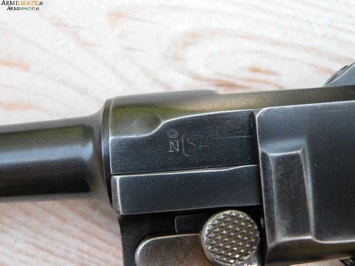

Since it has been brought up, I regret to tell you that this gun has been refinished.

An old refinish, but yes, the buffing on the line above the "SA" is obvious

Guns were never marked in any way to indicate a re bluing. The best evidence on your gun, for example, is to look at the "scalloped out" area of your upper receiver just to the left and above the C/N. This is where the upper receiver is contoured down near where it meets the barrel. This area should be a very sharp, crisp machining cut with wear only on the sharp edges on a 90% plus gun. Yours shows evidence of having been buffed down and the edges rounded in this area prior to re bluing..

I don't believe it's refinished in the conventional sense. I think it's a commercial assembled from reworked Imperial parts. The military serial number was shaved from the front of the frame, and the barrel extension which resulted in the "scallop". And was machined away prior to it's transformation to an alphabet commercial.
If the received had been buffed or filed and reblued to this extent, it would have removed the C/N as well as the SA stamp completely. I believe both of these marks were applied after it's being reworked to a commercial configuration.

From posted pictures.... Besides alanint mentioned, there is another place. SA was applied by Finnish. It's supposed to sit above the blue, not under the blue. Also, it's a stamp, ridge around the stamp should be unavoidable.
