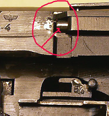

bob,
Look at the front end of your sear bar/lever. There should be a small, horizontal, spring loaded button there. If it's not there it will cause exactly what you described.
FN

Unread 12-05-2009, 09:47 AM   #4
FN, I disagree. The disconnector would have to be frozen in place to go full auto. More likely the sear is worn inside and not allowing the FP to **** on recoil. TH

I defer to you, Doc. You da man! Perhaps,is the distant past, someone greased the plunger, and now it's frozen in place.
