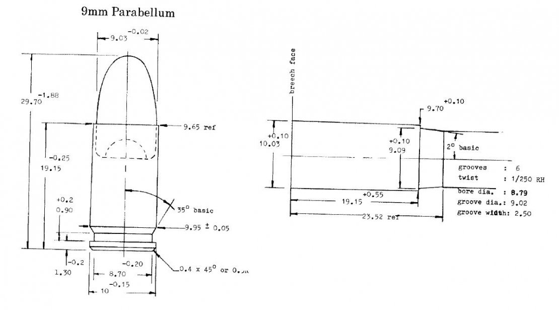

Could anyone tell me the twist of 9mm Parabellum Pistol?
"Submachine Gun Designer's Handbook" says 1/250 RH, could you confirm that?
Unread 01-16-2010, 11:09 AM   #66
Yep, as well as that of the 7.65 para / .30 luger version.

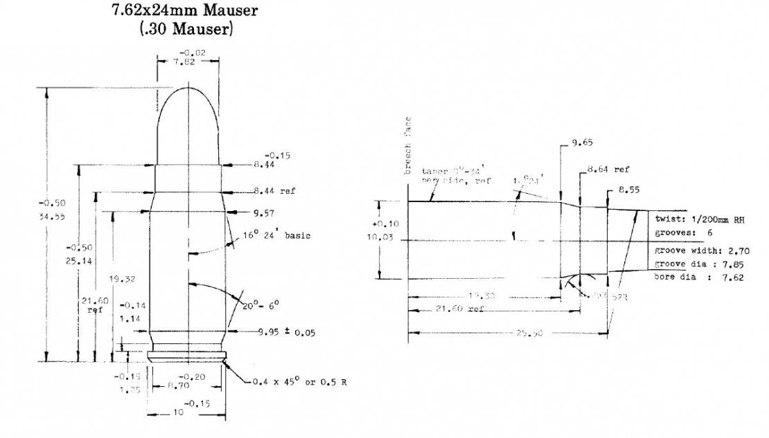

It's good to know, because the booklet did not say the weapon being a pistol or MP38/40 sub. 7,63 Mauser twist is 1/200 RH.
