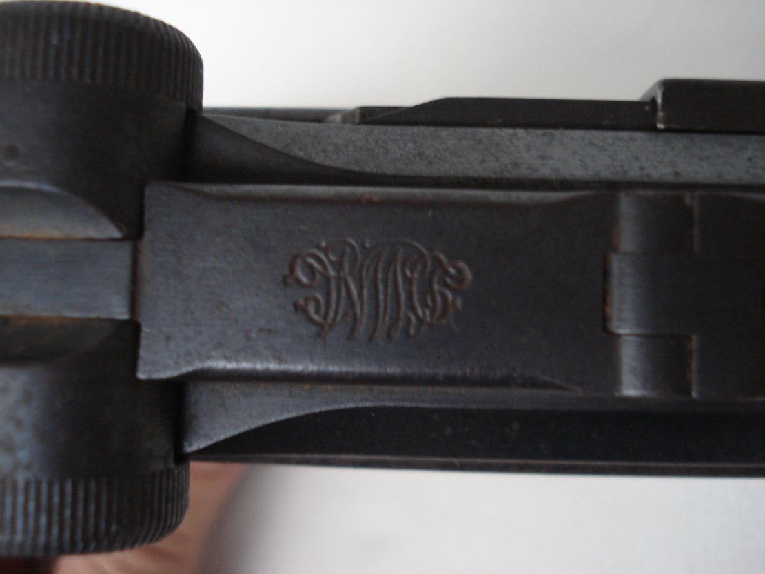

I have just put my hands on this pistol and feel it needs urgent attention. I will follow your advices and oil it so as to hinder further damage. Yet, I will not give up on finding a gunsmith. The rust damage is relatively extensive, though it wont get worse.
This is a picture of DMW Logo

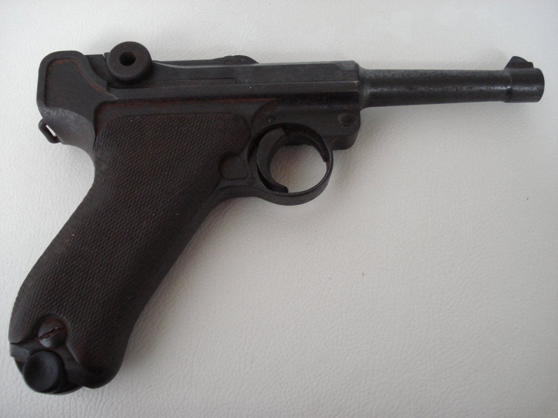

Another picture.

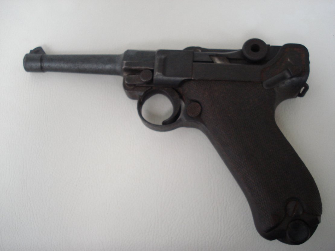

Finally ... the other side.
I was checking number of parts and all of them show the number 45. It seems the pistol is all original.

Leo,
Thanks for the photos. Given the condition of the gun, I would encourage you to give it immediate attention and use oil liberally to remove the active red rust with 0000 steel wool. It will not further damage the blueing and will consideably improve the appearance and halt the rusting process. After cleaning, a lighter application of oil or silicone will protect the finish. Remove the grips to access the rust that is undoubtedly active there. Be particlarly careful in the removal of the left grip so that you do not break off the small portion of the grip under the thumb safety. Good luck.

Leo:
From your pictures it appears the stock lug may be missing from your "08" frame.
Can you provide a picture of the rear of the grip?
Regards Ken D
