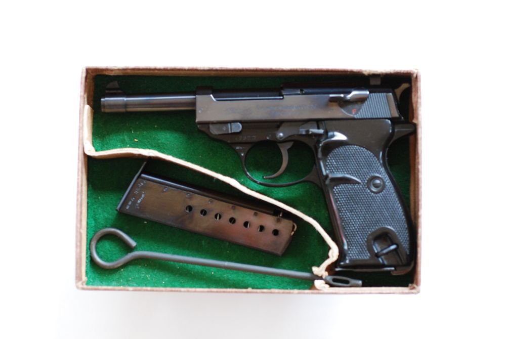

Hi Alvin, My aluminum framed Interarms P38 weighs 27 1/2 ozs compared to the steel framed variety which weigh in at 33 3/8 ozs. Regards, Norm

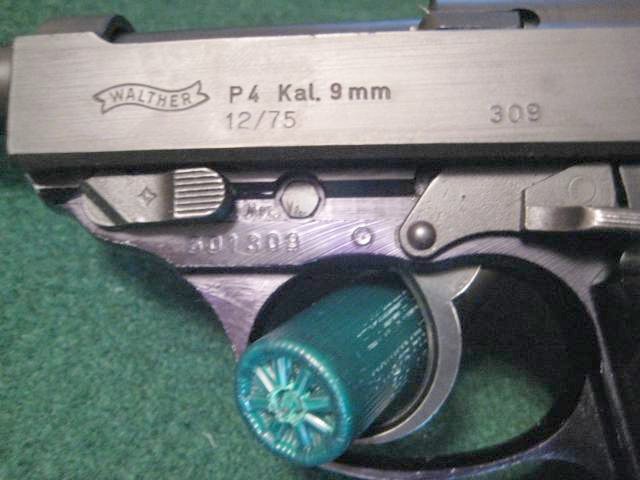

That's a P4; shorter barrel than the P38/P1...and there's the hex cross-bolt...
