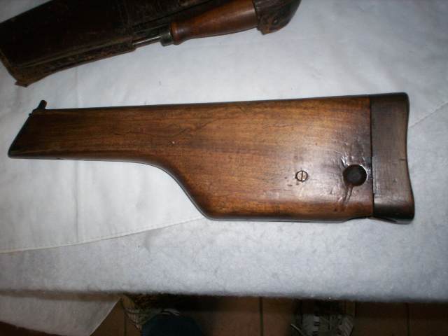

What is that humongous hole in the stock??? Is something supposed to be in there??? Or is it a bubba modification???

That pictured hole is not a hole. It is a depression were the button for the lid latch is. The wood is usually blackened and the metal button is blackened(age or dirt?). Big gouge in the wood,however.

If you are referring to the large hole on the bottom, that's where the pistols butt protrudes from when the gun is inside the holster stock.
The stock cover latch button, seems ok, but it appears that the spring that actuates this latch button has been modified with an external screw, versus the pring being secured from the inside of the stock.
Can anybody confirm the correctness of the outside screw. I don't remember any stocks I have owned having this outer screw for the stock latch?
I probably misunderstood the question.

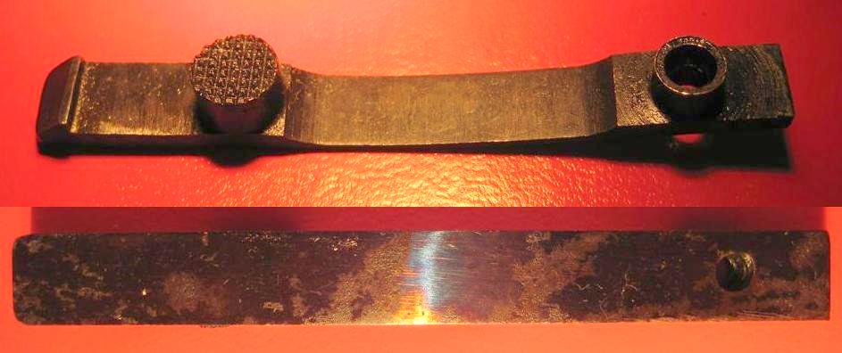

From picture #9 (copied here), I did not see anything wrong with the cover latch or latch screw. The latch is single milled piece with button, screw installation hole and spring integrated together. As long as it's installed on the body via that latch screw, it's auto-tight.
