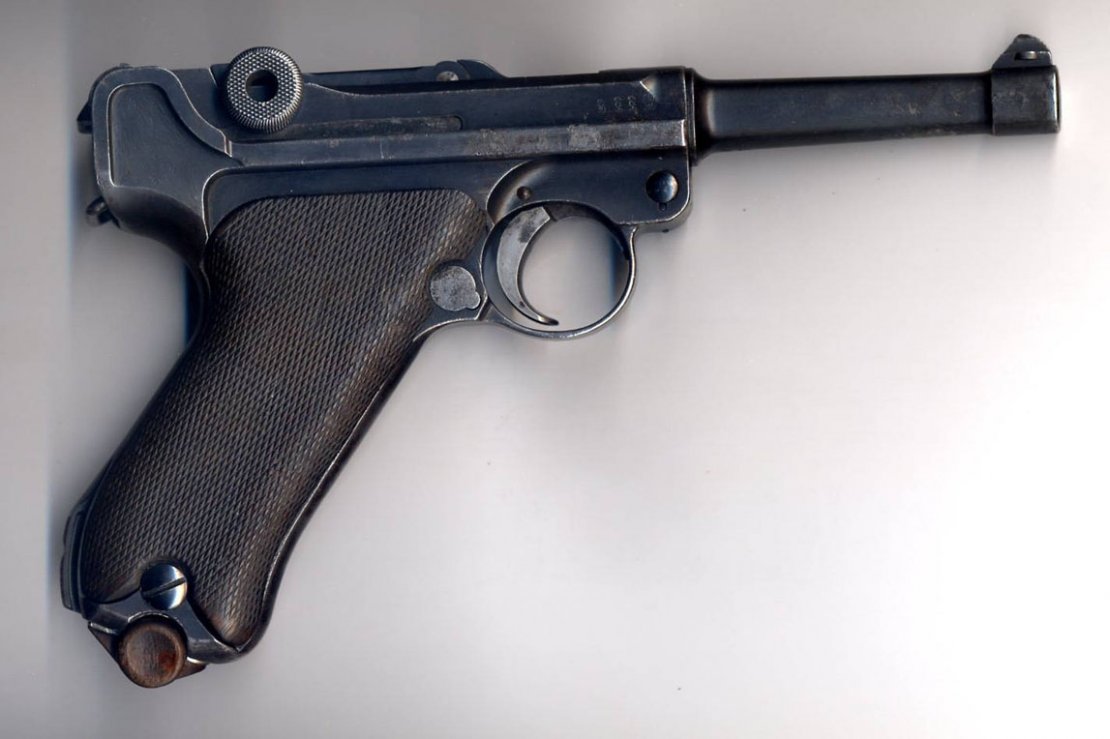

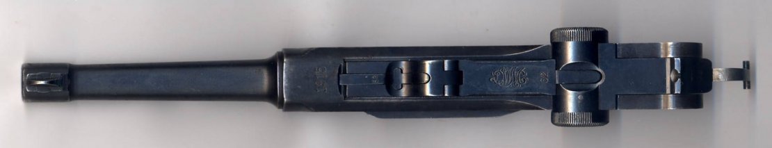

I have attached an image of the unit mark, as well as other images of the gun. It is a 1915 DWM s.n. 362g. There is also an image of the sear bar assembly and the mark, which looks like a crown/m, but I'm not sure.
Please let me know if there are other views that would help.
Thanks, barr

Barr, The grips shown in your photo appear to be typical Russian rework replacement. This may be where the Erfurt replacement sear was installed. I may have the correct numbered DWM sear; what number do you need? TH

Do you think that the crown over m is an Erfurt proof? I wasn't sure and just through that out there, because it is similar to some of the Erfurt proofs. The grips are marked 62 on the inside and have what looks like a W mark, but aren't imperial marked.
I'd need a sear assembly marked 62, Tom, if you have one.
If this were a reworked police issue could the replacement sear assembly have been done at that time and would they have used an Erfurt sear assembly?
There is no sear safety on the gun, but it does have the hold open and the mag. no. doesn't match the rest of the gun.
Thanks again for the help. I'm sorry about the photos not being real good, for some reason when I uploaded them they became smaller although they weren't over the limit, not sure what caused that.
barr

Barr, your crown/M is a C/U and we find it often from 1914 on (only) ERFURT Lugers. Itīs an Erfurt proof!
N. Burghard Pasing was a holster maker. Burghard made holsters as a Subunternehmer (I donīt find an English word for that) for the AWM. So it seems that your Luger was in one of the 3 Bavarian Armys.
Regards Klaus
