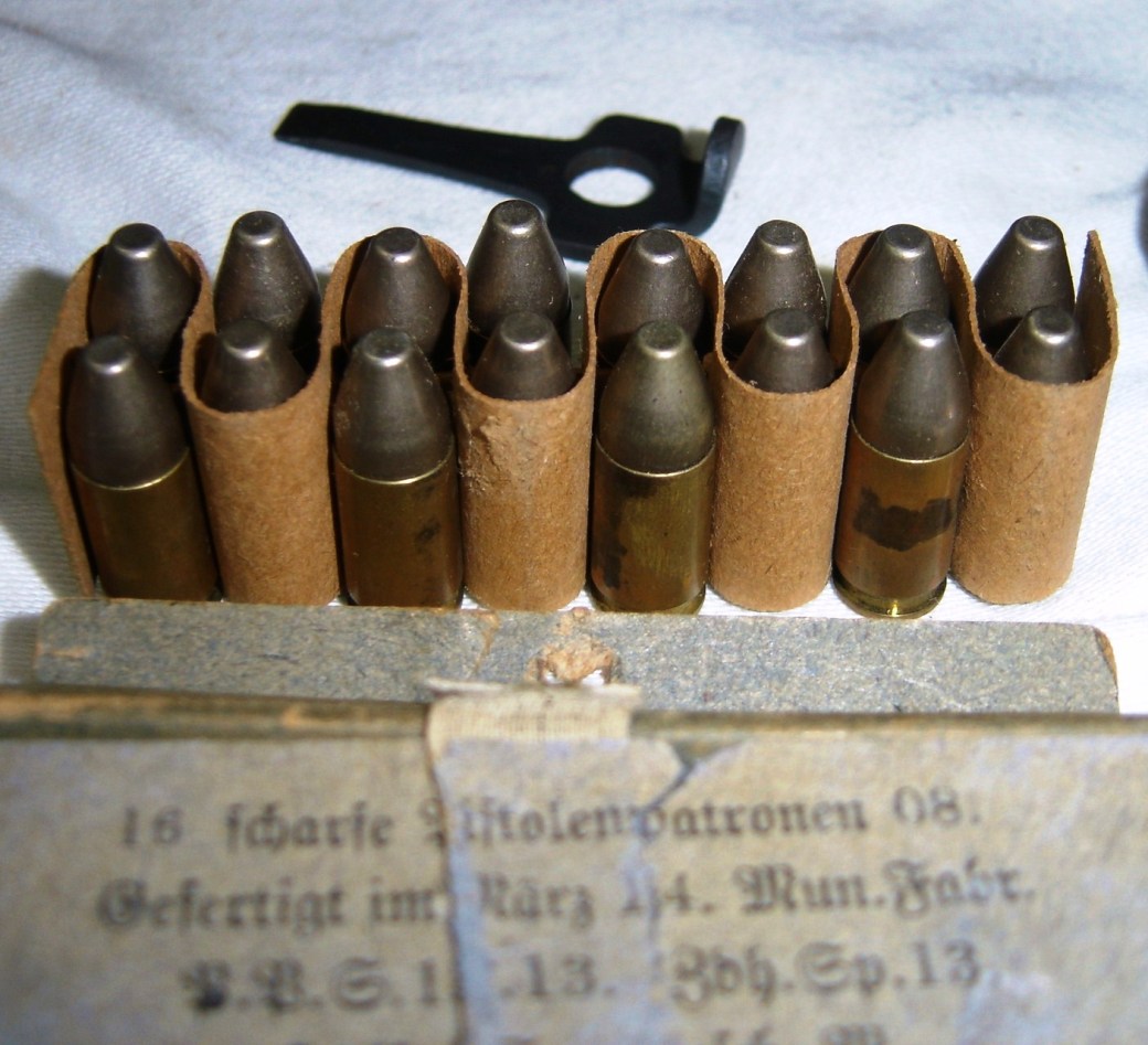

I include a few photos of 9mm ammunition
Can anybody tell me a bit more about the various numbers. I know that the "S" means Spandau.
Piet

Hi Piet,
Quite simple, actually. The 2 is the lot number, 14 the year (1914) and S is indeed the Spandau arsenal. The pistol rounds have the bullet shape which was standard until somewhere in 1917, when the change to the familiar conical bullet was made.
The base descriptoin (2-14-S) only refers to the brass, not to the entire cartridge. The box gives more detail about the factory that assembled the components into live rounds and will show:
-The assembly plant. (... Munitionsfabrik, can't read the first letter).
-The powder type.
-The primer source (zdh from 'Zündhütchen'). In this case made in 1913 by Spandau.
-The case source. Again, Spandau.
-The bullet source. ('M')

Thanks Vlim, I include a previous photo of the box.

Piet,
Aha. That's better.
Made in march, 1914 at 'Munitionsfabrik' (munitions plant, a bit vague). Since both the abbreviations 'S' and 'M' are used, I think that in this case 2 state plants were involved in production. Spandau and the 'Munitionsfabrik' (or 'M'), whatever location that may have been.
1914 - 1916 pistol ammunition is pretty rare. Most found today is 1917, with some 1918.
