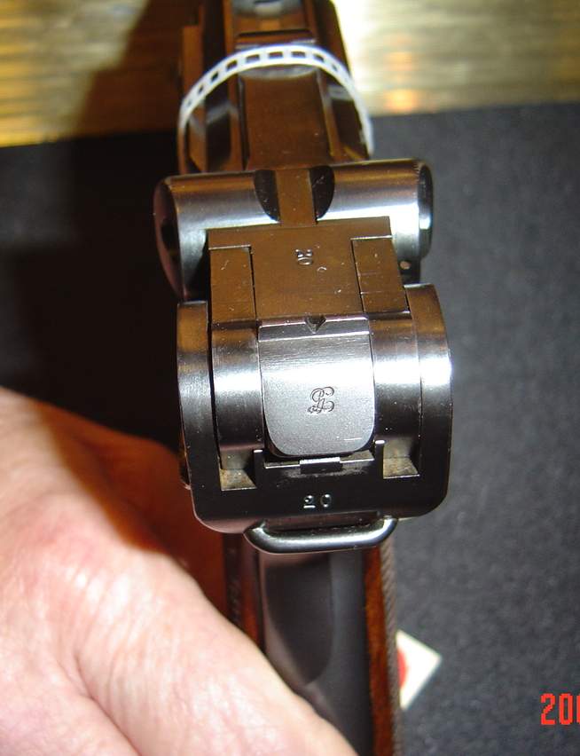

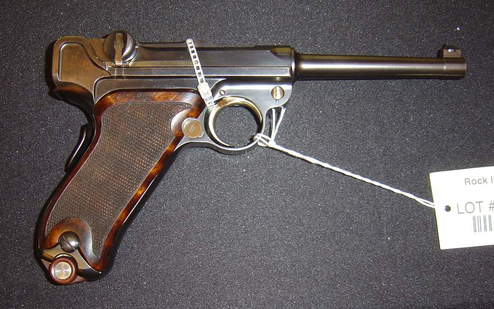

Hate to stir up more controversy as no one from the period has survived to clear up questions. I know how Ron Wood feels about #20. We went over it at the recent Reno show. The blue had a fine patina evident by shining a flashlight on it. The "GL" monogram was scalloped properly and not flat out like so many previous faked GL's. The Swiss Cross was interesting. It was larger than those hand engraved ones on the later alleged "pre-production" models. It appeared engraved as some of the rays were of different depth to my eye (unless the hand stamp was made this way). The rear toggle was flat and of proper thickness, it did not appear to have been shaved. Also the blue on this surface demonstrated fine patina. The squared rear toggle link looked OK as the the rear toggle itself. I am told that this thickness of the so called wings on the front face of the rear toggle varied in thickness. I wonder if these dimensions on BL#5 and BL#6 are identical. In summary, despite Ron's concern, which I feel are well taken, this #20 looked as genuine as can be. If not, it is a clever fake, well done by a fantastic machinist many years ago. By the way, a defininte (in my opinion) fake #21 was also at the show in another presenter's show case.

Unread 08-23-2009, 12:06 PM   #18
Thanks: 1,123
Herb,
If memory serves me correctly (and it often does fail!) you posted during the earlier discussion on #20 that Mike Krause also agreed that it was not authentic. What has changed?
Unread 08-23-2009, 12:27 PM   #19
drbuster
drbuster's Avatar
Posts: 1,432
Thanked 71 Times in 56 Posts
Ron, I think I know what you are referring to. Mike Krause had never examined #20 in person, despite it having been at previous Reno shows. After taking a very close look and inspection this time (He was not allowed to handle it before by a strict representive of RIA but Judy Voss kindly let us examine it all we wanted to this time), he held to opinion expressed above.
