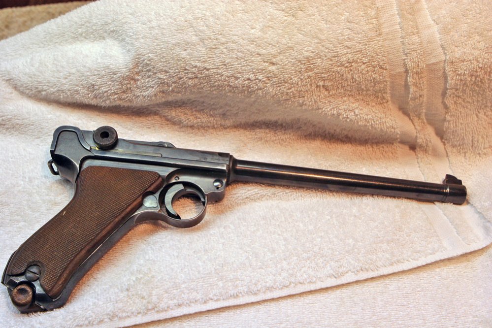

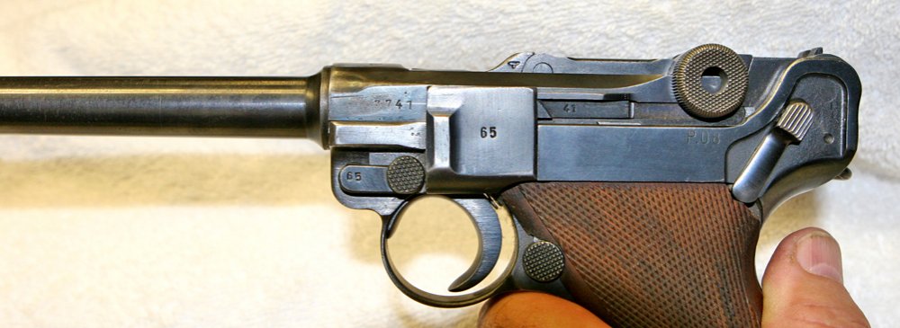

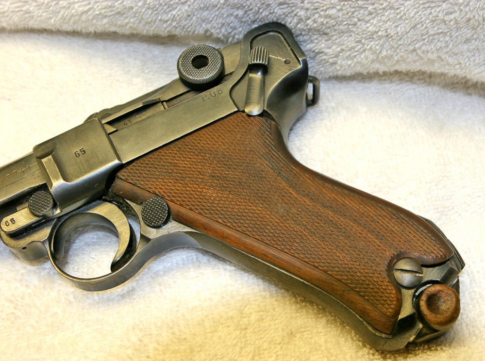

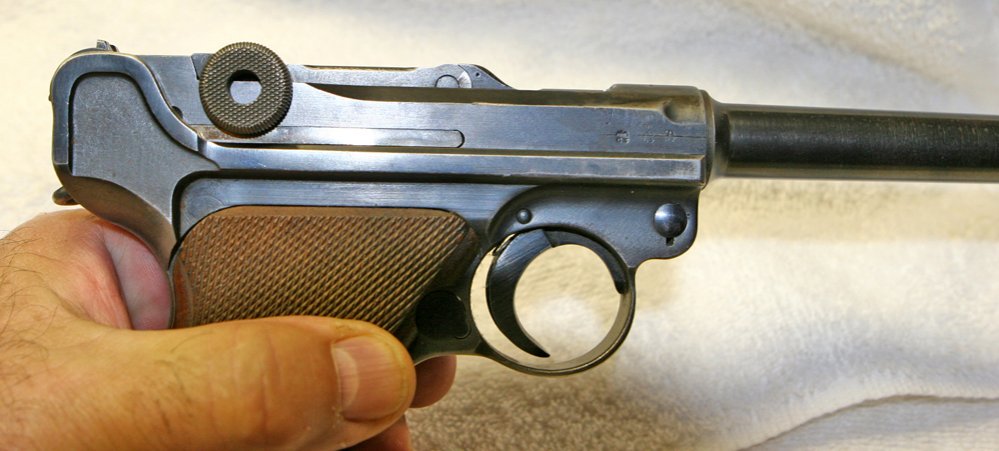

Hello all,
I have been around guns since the mid 1950's but never have I handled a Luger. A few days ago a good friend brought over some guns for me to look at. One is a P.08 Luger. There is what I think is a date stamped across the top of the receiver, 1937. There are at least five places marked on the gun with the number 65. What I think is the serial number is on the receiver and the last two digits of the s/n are on another part of the receiver. The barrel is 7" long and there are pen "dents" on the bottom of the barrel the line up with the receiver. I have been told that this means the barrel is original to the receiver. The bluing show age but no rust nor scratches nor pitting. The wood is in GREAT condition. What is the best way to determine the value of the gun quickly? My friend is facing foreclosure. I am not using this forum as an ad, I'm just asking for what direction to go. I'll try to post some photos below.
Thanks in advance,
Steve H44

Sorry, I don't think this gun will save anyone from foreclosure....it is a mis-matched, re-barreled, re-blued shooter,with incorrect grips, perhaps in the $700 range.......

Thank you for the info. Can you please explain to me how you can see all of those things? Please do not take this as an argument but all of the numbers match. The bluing appears original, the wood.....what is the clue there?

The grips are Italian made reproductions in the bordered Swiss pattern. A 1937 Luger was made by Mauser for the military and was never produced with a 7" barrel. Does the barrel have a serial number and proof marks?,,,it should.
....it is a mis-matched:
Receiver (not frame) is numbered 3741, sear bears #41... rest of parts marked with #65
...re-barreled:
The barrel length is not consistent with any 1937 Mauser production
...re-blued:
Polishing is evident on the proof marks
...shooter:
Maybe we don't know that (unless you test fire it)
...with incorrect grips:
They are not original pattern
...perhaps in the $700 range:
That's an approximate value
Jack

BTW, the chip missing in the left grip near the safetly lever can be repaired so it doesn't even show that it ever happened. See member HUGH for grip work. You won't be disappointed.
