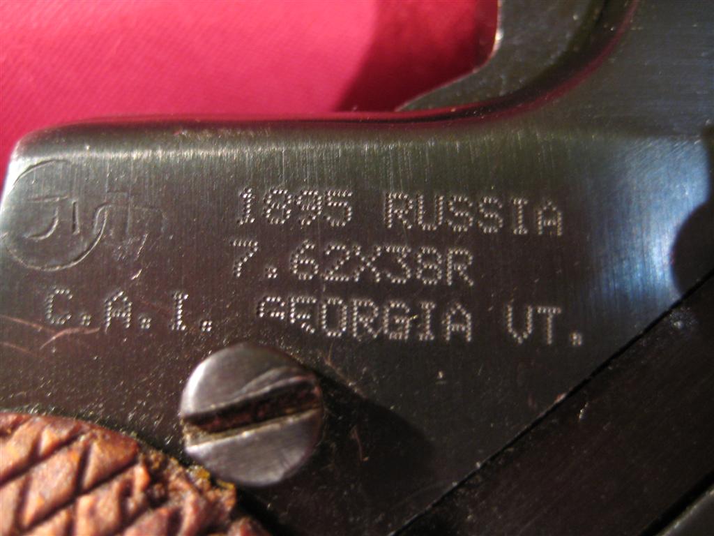

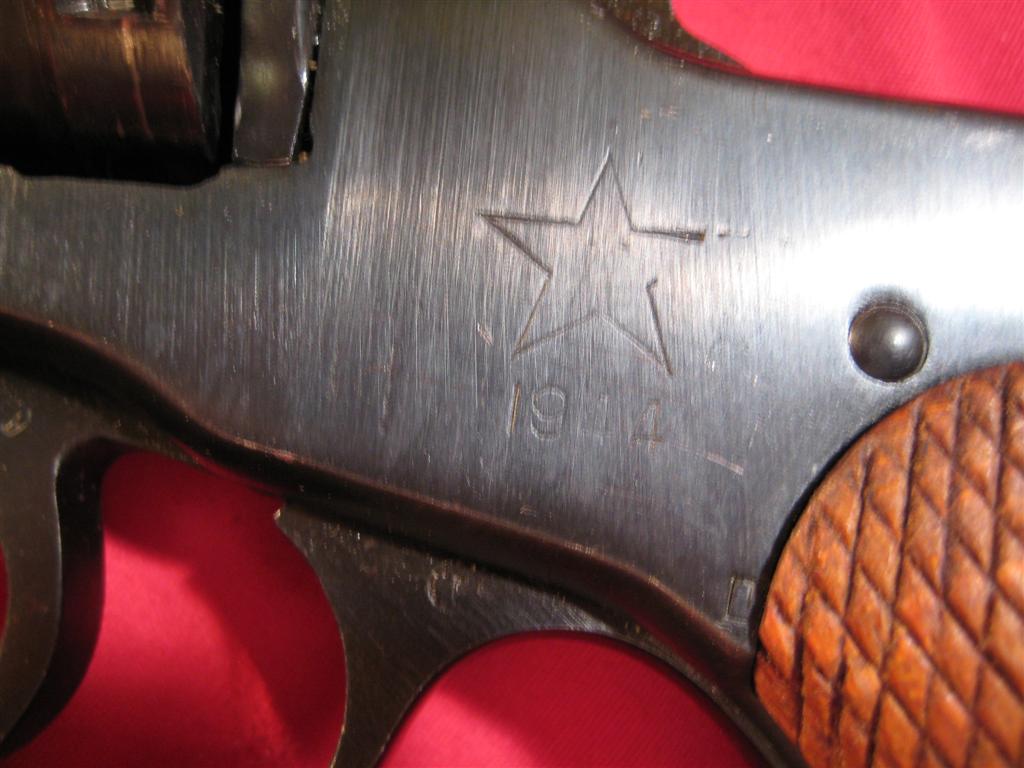

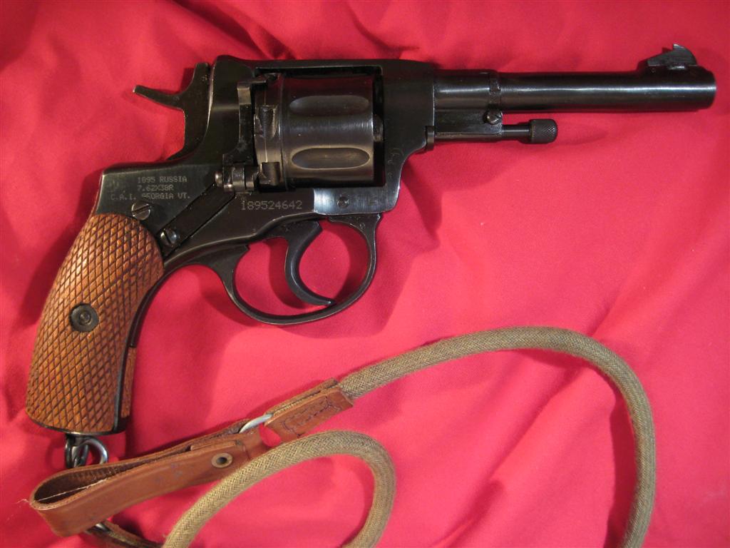

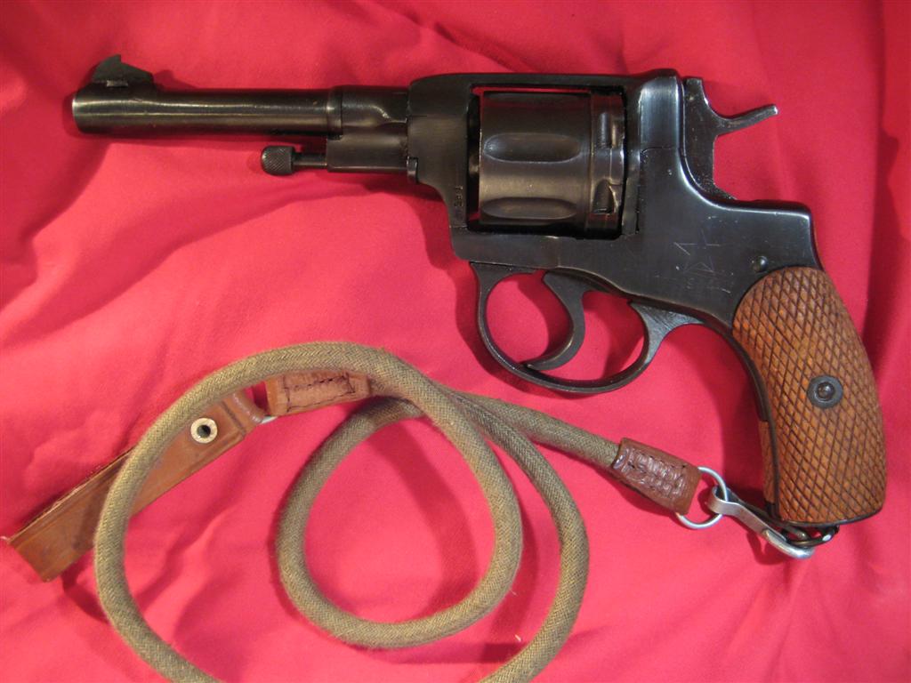

There are many type of guns, but I only plays a few. Sold one 1895 in the past, but I found I still "need" one. So I bought one back. Enjoy!
It shoots high.

Looks like its in good shape and made in 1944 also. Its fascinating from an engineering standpoint. I've shot .32 Longs in mine. Terrible trigger but a neat conversation piece.

I really love Nagant. Even thought about acquiring an original one. But I gave up. A couple of boxes of "real" ammo will worth this gun, so I shot .32S&W Long.
As you can see, arsenal rebluing job was not bad. It still looks like a chocolate under hot summer sunlight when I look it closely, but for its price, I have no complaint.
