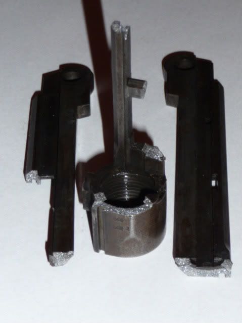

My 1917 DWM broke up yesterday, the barrel extension broke into three pieces, but the gun stayed all together .... !!!! When it failed to fire the next round, I noticed first that the trigger bar had gotten outside of its spring, and when I began to take the upper off the gun, it came apart in three pieces. Will take photos and show tomorrow or next day. But the amazine thing is that the parts were all still trapped and interlocked, held in by the frame rails, side plate, Toggle train and axle pin.
Anyway I think the cheap Chinese ball 9mm ammo was overloaded, but it was not much more blast than the White Box Winchester stuff.
In the TRADER section, I ask if anyone wants to sell an extension, or extension with barrel. I do have a barrel and receiver wrench set that enabled me to unscrew the barrel and it is ok.

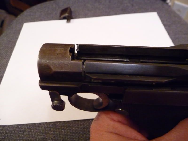

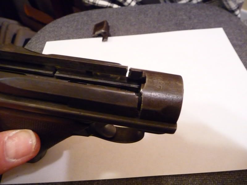

Note that the barrel, trigger bar, spring, and ejector have now been removed, but of course the gun was complete when the breakup happened. The barrel itself appears ok, as well as the frame, toggle train, trigger bar, sideplate, springs and ejector, all,
This gun had been refinished when I bought it 4 years ago, and had been somewhat buffed, but numbers still all intact. 984 suffix L . The original barrel was completely shot out, and pitted. The frame and sideplate and trigger somewhat pitted. I had this 4" shooter re-barreled by a gunsmith with a Bohler Stahl 6-inch barrel, and had found a tall sight to make it shoot poi=poa. Later I chemically stripped all of the re-finish off, and kept it in the white until two years ago, I applied cold blue to make it look more normal. Several hundred rounds of white box Winchester jacketed ball 115gr.ammo since then, and altogether for the last 2 years no problems.
Second magazine of the Chinese 9mm Norinco 115gr. stuff, and this happened. I was puzzled when the trigger would not return normally, but the gun looked approximately ok. I noticed that the trigger bar was moving out further than it should, and with no resistance to the trigger, because the trigger bar back end was outside of its spring. When I began to take the upper off the frame to check on and re-set the trigger bar and spring, as soon as the parts cleared the rails, it all fell apart. Remember the toggle train was all in there, holding the extension rails against the frame rails, as well as the axle pin and S lever keeping them from backing out of the frame, and the barrel-chamber part was retained by the take down lever. The breaks were unnoticed, until free to fall apart.

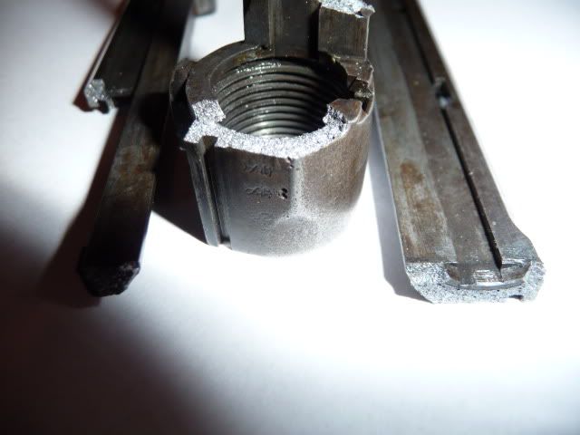

Some thoughts. Notice the breaks are where the fork might be weakest, but also where the blue takes a different color. The rails are harder, I believe. Maybe normal, or maybe due to heating of the chamber area by the gunsmith when he changed out the barrel, and lost its temper at the chamber area. Maybe the chemical stripping, and cold blue penetrated / permeated the metal and made it brittle ?
Maaybe it was that the ammo was loaded too hot. or maybe the gun was at the point of failure due to age and thousands of rounds.
Notice the chrystalline texture of the steel where it is broken.

I'm not a metallurgist but I doubt that the chemical stripping and cold blue treatment created this problem. I would bet that the gunsmith heated the barrel/receiver extension too much and changed the heat treatment. I am happy that you weren't hurt and hope that you find the repair parts real soon.

I had a 1917 Artillery let go in a similar fashion a number of years ago. Probably shooting reduced reloads, nothing hot. It just let go. Toggle wouldn't close, and closer inspection showed that one of the side bars had seperated. That gun had original finish as I recall.

I'm no expert on anything, and my college days were back in the '70's (Mechanical Engineering Technology), but here's a couple of ideas on this...
That crystalline structure is quite similar to cast iron...The only time I've seen anything like that in ordnance steel is when someone has heated it up red hot (like you would for hardening) and then quenched it quickly in water...and not done any more to it...(To complete the hardening, you would re-heat it to a lower temp, and then cool it gradually, sometimes for days, in an oven with decreasing temps)...
The other thing is work-hardening...You can see this with a coat hanger or a hacksaw blade...bend it back and forth until it breaks...You'll see that same crystalline structure...I'm sure you could get the same work hardening from the repeated pounding of hot loads...

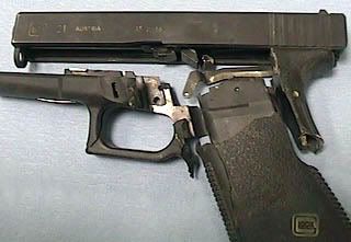

Thanks to the design of this great gun, I was not injured .... most other guns would probably have flown apart violently ....but these Luger parts which may otherwise have been shrapnel were retained by the tight construction design of the Luger.

NOT MY FINGER, but this Glock shooter had a nasty surprise when his Glock shown above blew up ........

I see thats a Glock 21, is that one on the photos from an Agency in Washington State ?
I think they had a couple of Glocks that let loose and it turned out to be an ammo problem as
recall.
If this is not the case can you advise me the info on this ?

The gun broke at a stress point for a Luger ( lug contacting frame) but I would like to see pictures of the rear of the breach block and both the inside and outside rear of the frame?
Damage usually occurs in these areas from too hot of ammo long before the receiver lets go.
