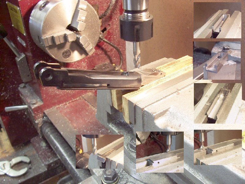

I decided to make a 2nd rear sight base, somewhat lower than the first...I knew I could gain .071" by milling off the lower sight blade lip, and get another .030" by lowering the sight leaf axis...So I made up a new base...
1st pic, from upper right clockwise...
- Milling a 3/8" trough in the 5/8" x 1/2" blank
- Milling the T-slot, using a 1/8" x 1/2" Woodruff keyseat cutter
- Milling the side reliefs for the rear sight leaf
- Cutting the front dovetail
- Cutting the rear dovetail
- Milling the bottom lip off the sight blade
- Cutting a ramp for the slide (big pic)
There were a bunch of other things done in between operations...Drilling the axle hole; chamfering edges with a 45�º cutter; cutting & chamfering the "artillery receiver notch"; shortening the leaf spring...
The 2nd pic is a comparison of the 1st rear sight base with the 2nd...It doesn't really *look* all that different...but I'm hoping the line of sight will be closer to what it should be...

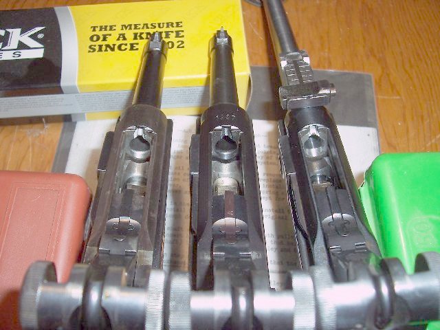

I tried to get the barrel ramp angle as close to the frame ramp angle as possible. It's not as unsupported as it looks; it is almost exactly the same as my Lahti barrel/frame ramp, and much less than my .45 Colt auto. I've had good results with matching the barrel/frame ramps on those pistols, over the years, with no problems (knock on wood)...In any event, I don't plan on shooting any Luger with a full load; I'll load 10% less than whatever Speer recommends.
I just measured (as best I could) my barrel ramp vs my commercial & S/42 Lugers. Mine is ~.012" deeper than those two, it just looks deeper in the pics.

Thanked 17 Times in 14 Posts
Interesting pic, Postino. The flat on the ramp of my S/42 is only about 2/3 the width of the ramp on your S/42, and about as steep...which is noticeably steeper than on the artillery. Apparently, the people at Mauser had different ideas about how it should be done. On mine, it seems to work.
