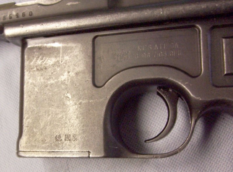

Here's where the Chinese characters are on my M30. This is not a Chinese copy; it's made by Mauser for export to China. The characters, on the bottom of the magwell, loosely translated, mean "Made in Germany".
The importers markings can also be seen in the relief above the trigger -
KFS ATL GA
C 96 7.63 GER
They stand for Keng's Firearms Specialties, Atlanta GA, rest is self explanatory...

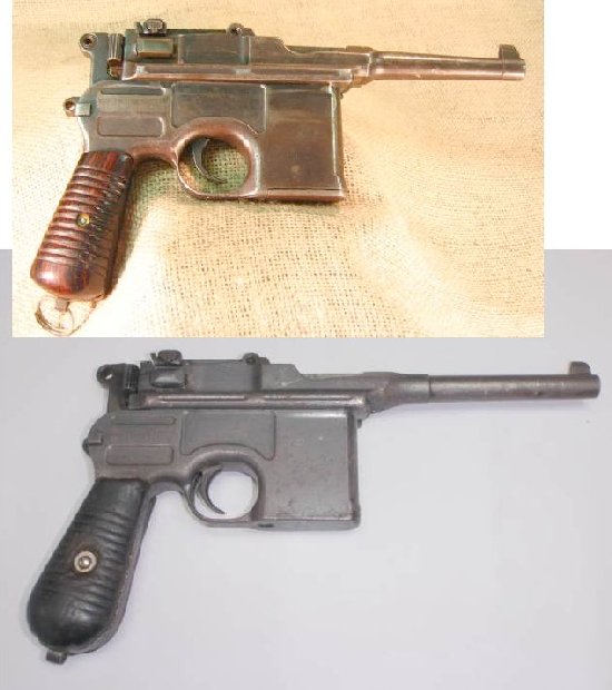

Here's a quick pic of a Bolo on top and a M1896 on the bottom (for want of better terms). IMHO, the Bolo is not worth anything near what your gunshop is asking...and unless it's an M1896 (or M1930) with 90%+ blue and excellent bore and all matching w/excellent shoulder stock, not worth the price either...
There's lots of nice ones for that money on GB...
Bolo has shorter barrel and smaller grip...rest of pistol is the same as M1896...
