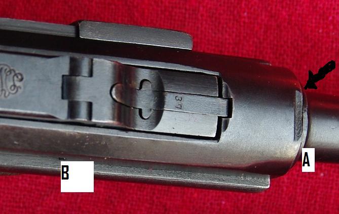

IMHO, the date stamp on the receiver ring, and proof/inspection marks on the right forward part of the receiver have been removed from this DWM Luger. I don't think it is "unmarked" or a "sneak"... just modified, possibly to disguise it's origin, and likely a long time ago from the condition of the finish...
Without a date, it would be pretty hard to identify its actual time of manufacture.
Why do I think this?
In the first photo, there is a finish change from point B to point A that includes swirl marks from a sanding operation. The color of the finish distinctly changes (at least in the photo from "blue" to more of a "gray" color, and then potentially cold or rust blued to mask the changes... but as you can see the color doesn't match uniformly to the rest of the upper receiver.
The lines of the forward bevels on the receiver ring have been softened, rather than show the same sharpness of the other manufacturing lines on the gun.
It appears that the receiver ring notch (indicated by my crude arrow drawn in Microsoft Paint), that would be present for use in an artillery luger barrel configuration has been partially removed. It appears also that the very top of the barrel flange may have been touched during the sanding operation.

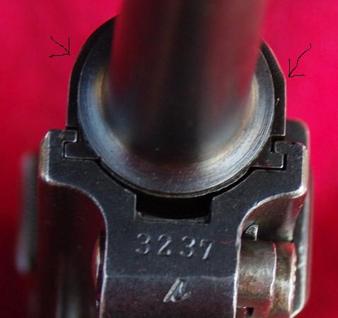

In the second photo, the front profile of the receiver is dramatically non-symetrical because the sanding was done by an lesser experienced mechanic... On the right side of the photo you can distinctly see the beveling of the lines on the ring, but on the left there is virtually no beveling apparent from the front.
This gun MAY have left the factory in a lunchbox, but IMHO it originally had a date stamp and proof marks. It is numbered in the military style.
I hope my narrative has been helpful... Unfortunately, I only have crude image editing available to me at the present time because of my location.
Comments are invited on my long distance half baked forensic photo analysis....

I believe you're correct, especially as this is what I suspected - and especially since I paid very, very little for this piece. It was one of those, "How can you possibly go wrong as long as it shoots." prices." FYI, I believe the coloring is essentially even and variations you see are from angle of the primary light source incident to the subject. Also, the beveling you mention is actually quite even to the eye. What you see as beveling on one sude and not (or less) on the other is also a trick of poor lighting for this purpose, in as much as the primary lighting comes from photo right and glares photo right.
Next time I photograph something like this, I'll do it in a proper light box.
Some machining marks I believe are original in as much as I've seen them many times before on other machined items. At the rear you will see sharply defined circular marks in the surface. I used see these on machined surfaces that were not completely buffed out. They were from the milling process and the fine sharp circle show you the size of the milling bit.
