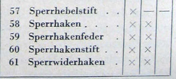

From the 1942 Zimmerman's book...
- means "compatibel to"
X means "not with this model"
[empty] means "special to this model"
Guisan.

I am guessing that these are the incompatable items...
ed

Ed, the small parts can be interchanged without problems. Even the complete toggles just slip into place. Same goes for the Mauser Parabellum, really. I've even put MP parts on a P08 and vice versa.
The main problems are with the barrel/receiver combination and the frames. An 06/29 Frame will work with an 06/29 Barrel/receiver combo, but not with much else
postscript:
It may be a fun test for someone with the parts at hand:
-Assemble a 1906 Swiss barrel/receiver in .30 luger with an 06/29 frame: Test it.
-Assemble a DWM 1906 or 08 style barrel/receiver combo and test it using an 06/29 frame.
-Repeat with several barrel lengths.
Mauser found problems with the following combinations:
-06/29 toggle ramp combined with 10cm .30 luger barrel.
-06/29 toggle ramp with 15cm / 10cm 9mm barrel.
That is why the initial Mauser Parabellum came in .30 luger with a 15cm barrel.
ps: the X on Guisans scans means 'not available'. I guess that the person who compiled the list had no data available for those particular parts. Rough translation of the header:
Exchangeability of the parts of the three Swiss Army Pistol Models 1929, 1906, 1900.
Table:
- = can be exchanged/swapped.
blank = Cannot be exchanged/swapped.
X = Not available.

No those last four are parts only found with the 00 and they were no longer fitted in the later models.
The posting at our own forum is a bit more easy to read...
http://theswissriflesdotcommessagebo...com/topic/6245
58 Sperrhaken translates as Toggle lock
59 Sperrhakenfeder = Toggle lock spring
60 Sperrhakenstift = Toggle lock retaining pin
61 Sperrwiderhaken = Toggle lock detent (catch), assembled to frame
Guisan.
Fight to your last cartridge, then fight with your bayonets.
No surrender. Fight to the death.
--Gen. Henri Guisan, Switzerland, July '40
