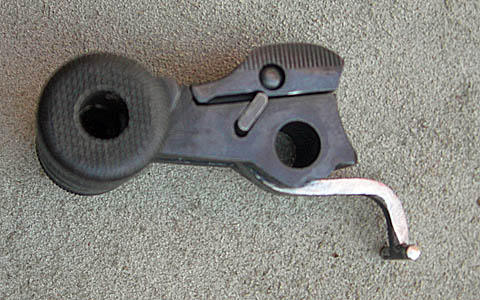

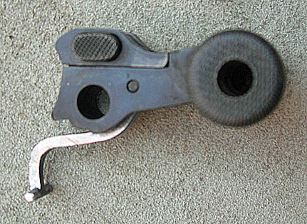

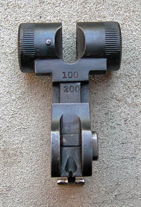

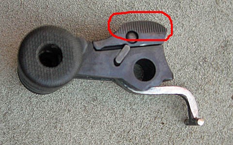

I had this Navy rear sight on Gunbroker that I thought is original. However, it has been pointed out to me that the checkering is wrong on the toggle knobs and the elev adj button. It is not a casting, but is machined. I know that the coupling link is not original, but has been altered to fit a leaf main spring. Can the experts please verify for me the authenticity or lack thereof?
Thanks, Hugh

Hugh, not an expert, but as compared to the one original Navy rear sight I do have, on several issues I believe your's is repo, if I can help pleae let me know......

Hugh, as I recall, there is a photo essay on the differences in the reproduction Navy sight from a real one in the Members Gallery. Hope that it is still there and that it helps you.
I just checked and it is still there...
Reproductions:
http://reutterwerk.com/lugergallery/...Reproductions/
Genuine Originals:
http://reutterwerk.com/lugergallery/...hts_0/Genuine/

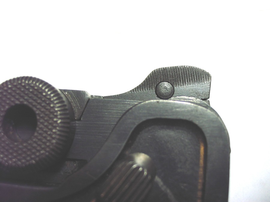

Hugh,
I recall a thread on the "Red Flags" on Navy Lugers. One was that the striations on the sides of the sight are exact, with dull ends and even across the bottom on repros. They are uneven in length on originals, and terminate in a point at the center of the cross pin.
The top photo is an original sight.

Completely bogus.
