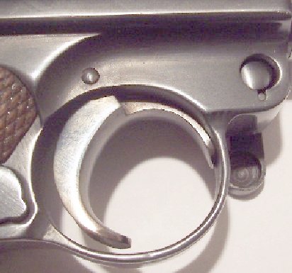

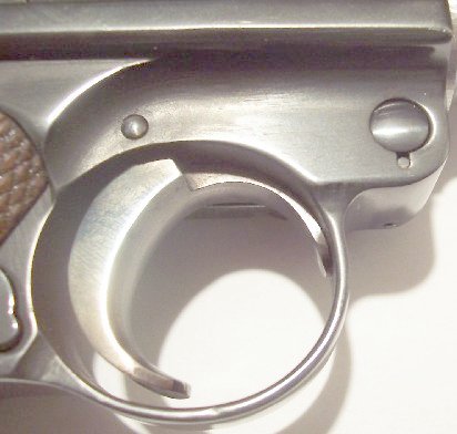

I've never had this problem, but I have had (and may have now) the "L" shaped spring for the takedown lever break...Can you see if both ends are still in the frame??? If not, part of it may be jammed...

Looking at my Luger, that seems the most likely scenario...Broken spring let lever poke out just a little...
here's two pics of what the round end will look like if that is what is happening...First pic, fully seated; second pic, just slightly poked out...

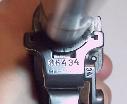

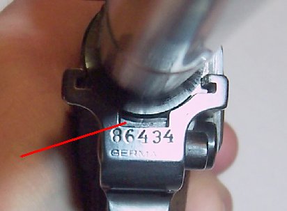

If you can lock the toggle back all the way up, and look at the front of the frame (under the barrel), you should be able to see if the locking block of the takedown lever is up all the way...If it is, and you have a long thin punch, and the lever is fully seated (all the way in), you could punch the takedown lever block down to the disengaged position, then drift it out of the frame like it should come out...
Unread 03-29-2009, 10:18 AM   #9
Here's two more pics showing the takedown lever locking block from the front...first pic is engaged (red line)...second pic is rotated back 90�º to takedown position...

If the takedown lever locking block is all the way up (engaged), scratch a vertical line on the round (unbroken) end before trying to move it...You want to make sure it rotates a full 90�º before trying to drift it out...but you should be able to see it come down into the notch...another pic attached...
