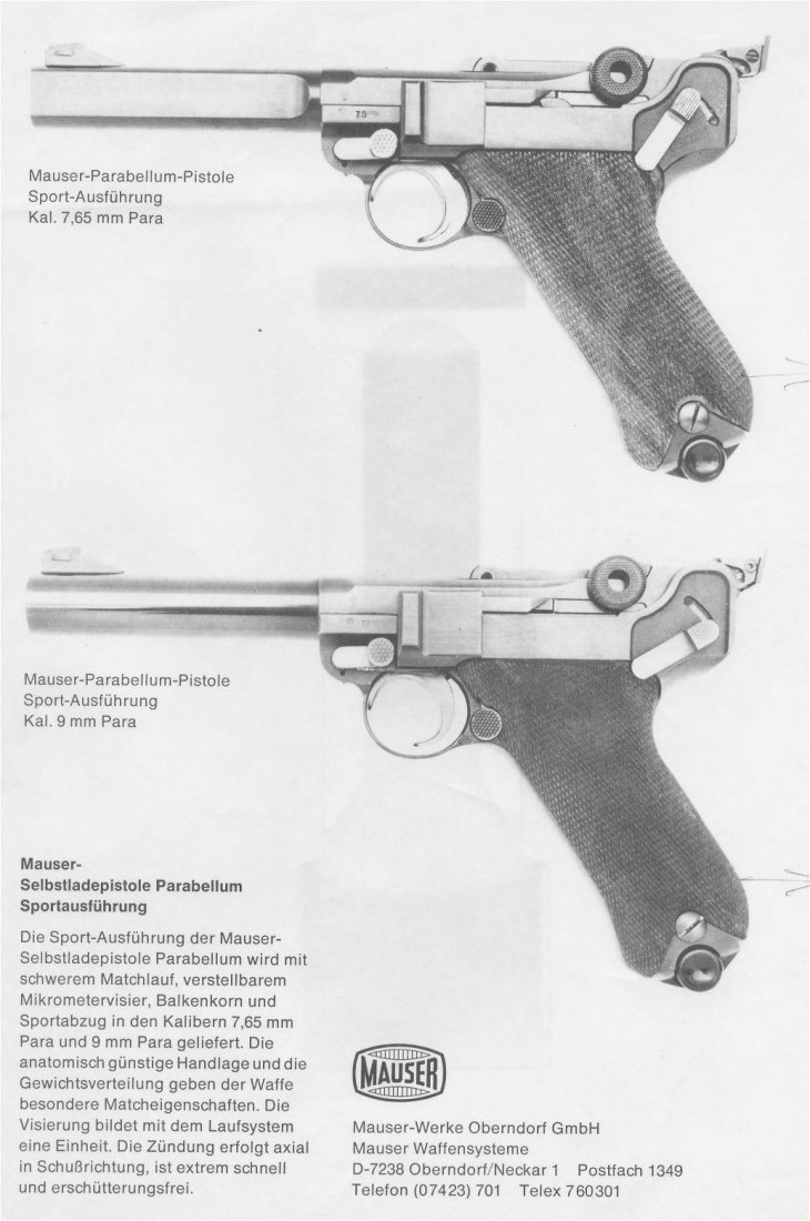

vlim - I agree MP would be a good choice , but the rear toggle is too hard metal to machine slot for rear adjustable sight - have you seen any MP custom lugers with a adj rear sight solution ? also , seen any target grips for these ? would the MP barrel ring before the threads make it difficult to make a custom barrel ?

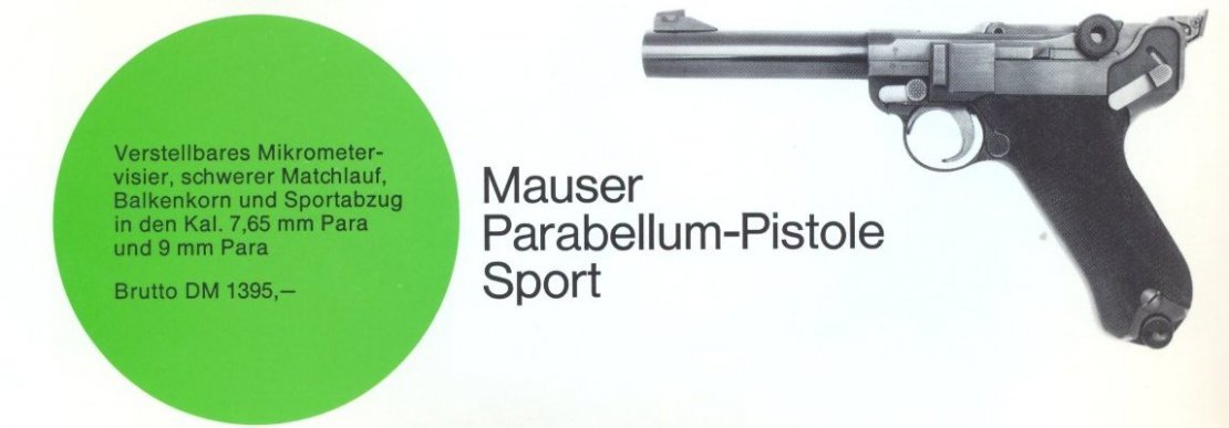

Bill,
Yes, Mauser did a couple of target versions, including ergonomic grips, adjustable rear sight, adjustable trigger pull and special bull barrels for target shooting.
The alternative threading of the MP should make it easier to thread and install the barrel, at least that was what they had in mind when they made the changes.

Vlim,
thanks for the MP target sales info copy - had not seen that one before
seems like Interarms kept the awareness level low for the few target models it received - or maybe I was looking the other way at that time
last one I saw for sale was in australia for $3500 about 10 yrs ago on a webpage - and it apparently sold at that price
I think Mauser missed the point in many ways - biggest was the rush to market the swiss model - and later obsession with the high dollar commeratives - and of course failure to produce 45 models with a 45 frame profile
have you seen any aftermarket customized MP lugers ? - seems to be ignored for custom/target - seems like swiss model used could be good donor source - but need some sort of target grips like have been offered on germany gun auction web page , these hide the absence of the P08 front grip frame bottom bump
