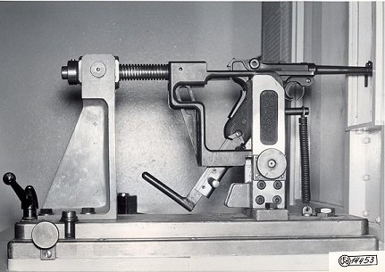

Swiss automated test firing machine
One of the most important aspects was to ensure that the Mauser Parabellum repeated correctly, since the pistol type with a toggle lock mechanism responds very critically on subtle changes in ammunition and itâ??s loads. This made selecting the correct reference ammunition very important indeed.

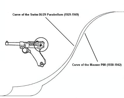

Differences in frame ear curves

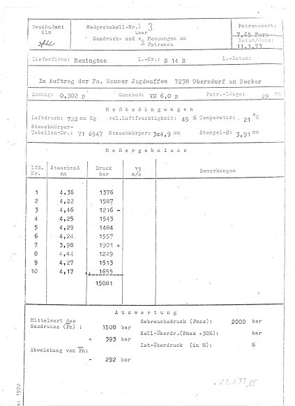

Parabellum test firing ammunition, calibre .30 luger:
The following ammunition brands were shipped to the Ulm proof house:
a. Remington, lot number S 16 S.
The ammunition is not useable for testing. The average gas pressure is some 500 bar below the average operation pressure and shows deviations of +297 / -304 bar. The ammunition is so weak that the toggle does not open completely and the gun will not repeat. According to mr. Brehm some 13,000 rounds are in stock. The same applies to the following lot numbers: Remington S 14 S and S 11 S.

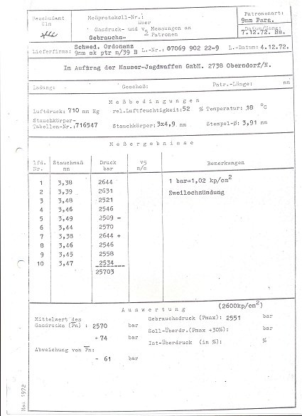

Parabellum test firing ammunition Cal. 9mm.
The following ammunition brands were given to the Ulm proof house for testing:
a. Norma, lot number 06006.
The average gas pressure of this round is 2551 bar and shows deviations of +82/-89. This ammunition should be used in the future, no function problems were encountered and the accuracy is in order.
b. Swedish army ammunition, lot number 07069 90222-9.
This ammunition shows the same properties as the Norma ammunition.

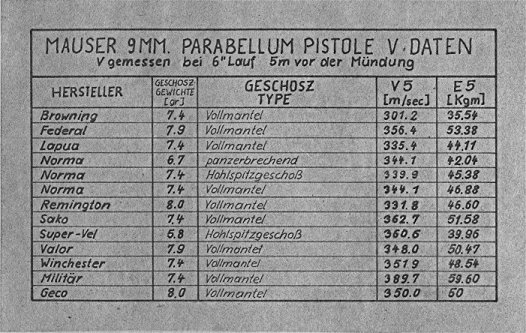

With firearms of the Parabellum-type, using a knee joint as a breech mechanism, the interaction between the moving parts, the springs and the ammunition is so critical that it is a challenge to design a standard pistol that can function correctly using the many different ammunition brands on the market. This sensitivity to ammunition and the critical role played by the magazine make for a combination that is very difficult to fine tune, something that can still be seen in the sports shooting world.
We were able to take a look at the work of the Mauser development department, using the documentation kindly provided by Prof. Dr. Rolf Gminder, former technical manager of Mauserâ??s small arms division, Otto Repa, formerly responsible for quality control and Gerd Sch?¶n of the development department. We thank them for the use of this material and the, sometimes colourful, memories they have shared with us.
Attached: Some examples of the Ulm test reports.
