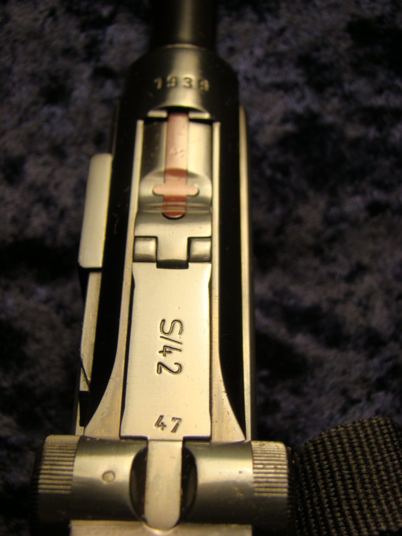

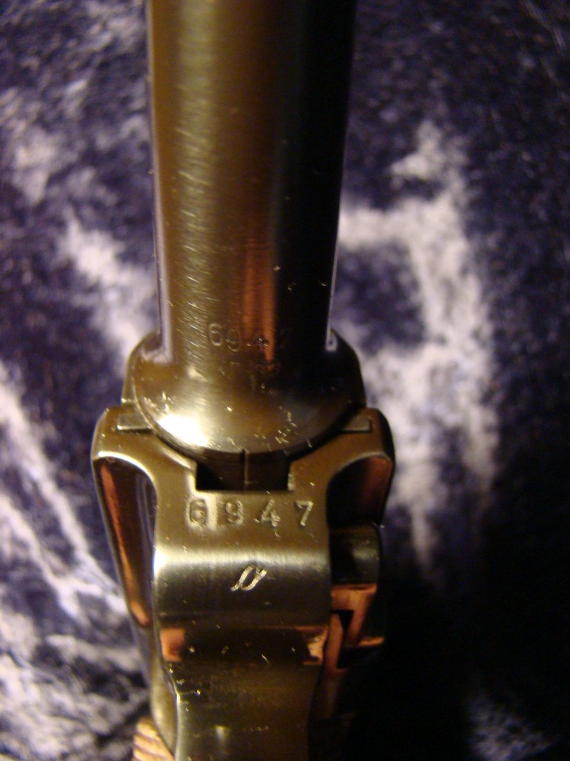

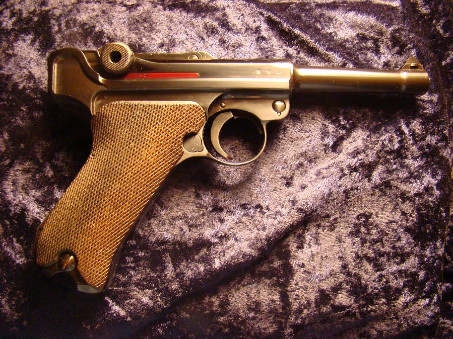

Hello and thank you for helping me with my Luger questions.
I have a 1939 S/42 that is all matching numbers except for the magazine. The bluing looks extremely good for a 70 year old gun and I would like to know:
1. Where and how many were made? (is it a rare one)
2. What branch of the military used it?
3. What is the value?
My wife's Grandfather brought it back from the war along with a neat little desk clock. I believe he said he "acquired" both from a German Officer.
I'll post a pic of the clock if you are interested because it has the German Reich stamped inside.
Thanks in advance for any info.

Hi,
The gun has been reblued somewhere between 1939 and today. Giveaways are the polished look and lack of sharp edges. Buty you are right, it is a very nice looking pistol. The value will be affected by the reblueing, however. Many soldiers who brought back pistols from WW2 lost, misplaced, or simply sold their pistols in the early years following the war. Other pistols were refurbished, reblued or even nickle or chrome plated.
Since German military issue P08's were no longer unit marked it's difficult to determine where they were used and by whom. So all we can say for sure is that it is German Army.
Do the grips have any markings on the inside?

Tracey, welcome to the forum, these war time guns went through a lot and sometimes they had bangs, scratches etc and the GI just wanted it prettied up, however, ruining the collector value.
A shooter like this is worth around $600-$700, maybe a bit more, but it all depends on who is looking that weekend at the gun show (if you had a table) and the market is fickle right now (cheap is a not as nice term)....

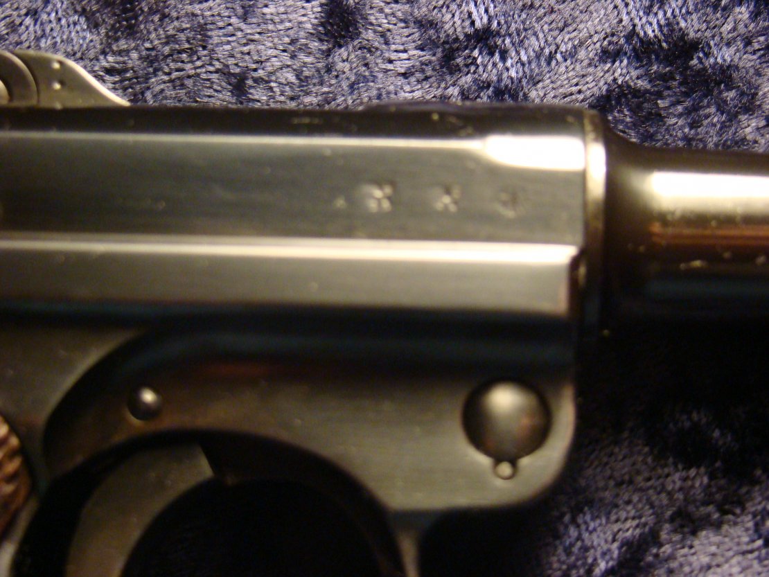

Tracey & Vlim, My initial reaction was that this was a reblue, due to the elongated TD lever hole & the thin proofing, but whoever did it was sharp enough to recreate the correct "purple" type blue on the extractor & ejector, which is difficult to fake. If the family can document its possession since WW2, I might want reconsider this assumption. TH

Tom,
Note the shallowness of the eagle-markings and the rounded, smoothed edges of the receiver and frame. The plum discoloration takes place very quickly, even after a reblue.

Tracey, I have to agree with the consensus, that this Luger did get polished and reblued sometime after it was acquired during WW2. The smooth finish is just too nice to be a wartime production military pistol.
The other comments by our colleagues above appear legitimate...
To make these statements without a first hand inspection in person is not as risky as you might think. All those who have commented, including myself, have examined literally hundreds of Lugers, and perhaps thousands of Luger photographs...
Describing exactly what to look for so that a novice can quickly pick out a reblue from and original finish would probably fill a book that most of us don't have time to write. That is what makes this forum so valuable to Luger owners... the available information.
I understand that this is probably not welcome news, but I sympathize with you because my father's own war trophy (now mine) was also refinished... BY ME before I knew any better 40+ years ago.

The extractor and ejector are two easely removed parts that may have still looked nice and were therefore not included in the re blue job.

I have a mismatched S-42 toggle that was just re-blued (hot Blued). Only the extractor came out that color, suggesting to me that it was of a different metal since it went thru the same process.
And Tracey enjoy this bit of history. Re-blued or not it is a very nice gun. If only it could talk...

I don't know for sure if the metal of these two parts is different from the rest of the gun, but they are definitely heat treated differently since they are both "springs".
I think the surface hardness of these spring parts is what causes them to "take" the blue solution differently than the rest of the pistol.

Tracey,
Several of the Forum's more experienced collectors have commented about the finsh on your Luger and I would absolutely trust their judgement. In response to your original questions, I would add the following:
1) The 1939 S/42 Lugers are pretty scarce as not many were made in 1939 before Mauser went from the S42 Code to the 42 Code on the toggles. I"m traveling and don't have any reference material with me, but I seem to remember that less than 40,000 were made as S/42s.
2) Generally these pistols were issued to the German Army. A very small number went to the Police and I'm not sure, but a few might have also been issued to the Navy. Both Navy and Police versions are even harder to come across.
3) Ed knows a lot about current values and I would trust the value number that he gave you.
Hope this helpe your quest for information.

Refinished or not, your pistol is a very beautiful Luger. And, above all remember it is still a Luger. The history it represents was not refinished so I suggest you keep and enjoy it as it is.

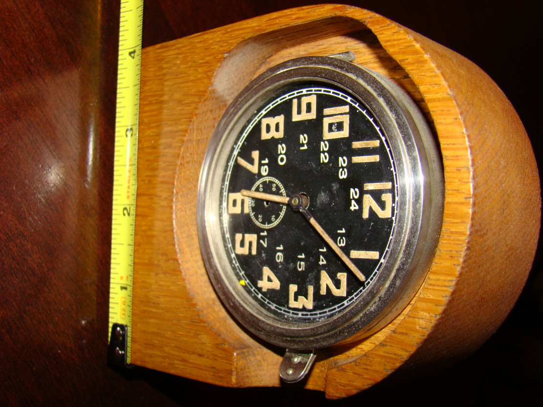

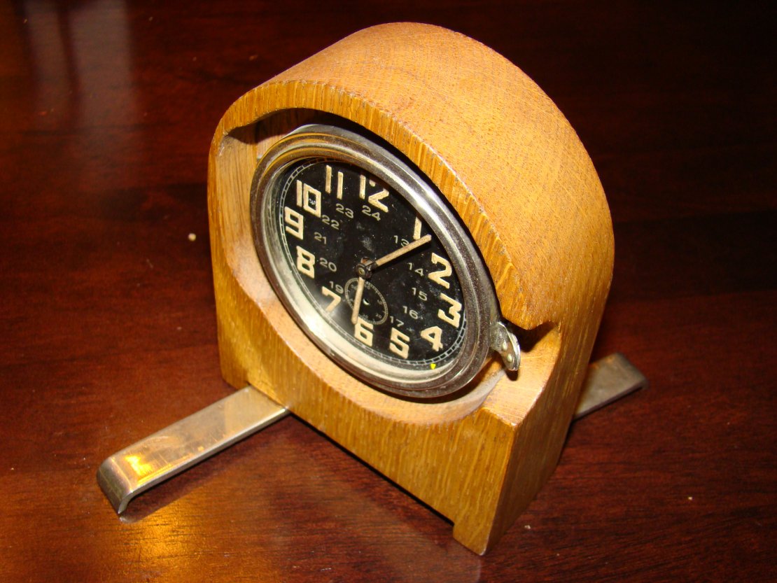

Default Clock
Here's the clock. The year is 1933 and has two metal feet that fold out for when it's sitting on the desk or it can be hung on the wall.
I know this is a Luger forum but has anyone seen a clock like this before?

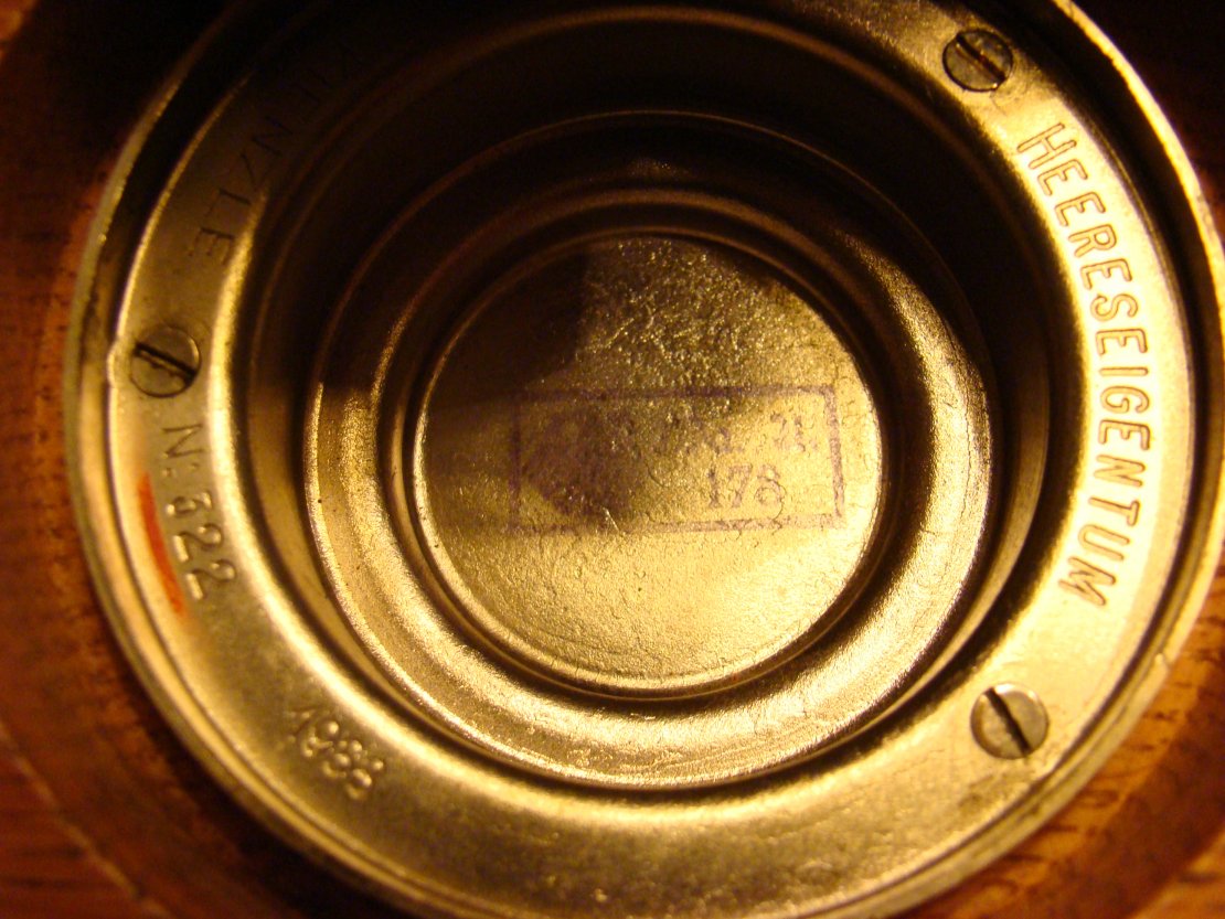

Default Update on clock info
I Googled it and only saw one online like it.
It's called a Kienzle station clock and Heereseigentum means" (Army Property).
http://www.fieldgear.org/clock.htm

Unread 02-19-2009, 12:17 PM   #17
Tracey, Your clock appears to be a commerative reproduction (see 1950s or 60s date on the back) of a clock from a military vehicle, mounted in a custom wood case. Very nice, TH

LugerDoc,
The clock is dated 1933. Did you look at this link?

Unread 02-19-2009, 06:47 PM   #19
apis mellifera
Join Date: Jan 2007
Location: WV
Posts: 149
Thanked 24 Times in 8 Posts
I collect and restore American weight and early spring clocks from ~1850 so for what it's worth: It looks like the movement was replaced (different hands and lack of seconds hand). The dial and case looks original or at least nicely reproduced if not original. The inside is also quite different from the one in the link. When you say "German Reich" stamped, do you mean "nazi" and are your referring to the ink stamp inside. 1933 would make it pretty early for a "nazi" clock. Do you have a picture of the movement? That would make for a better assessment.
