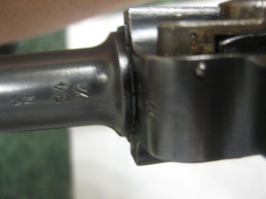

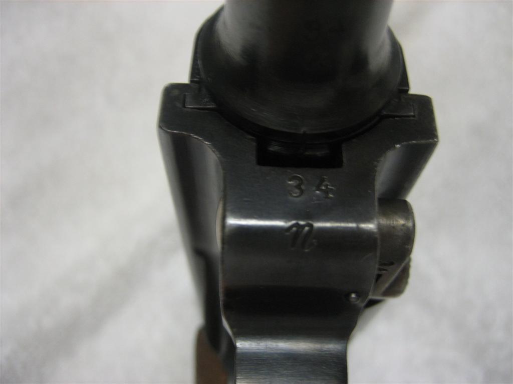

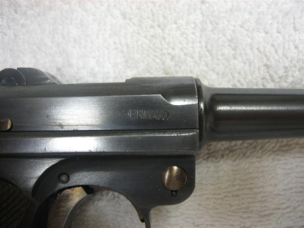

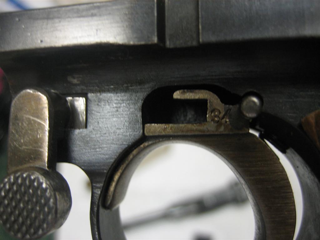

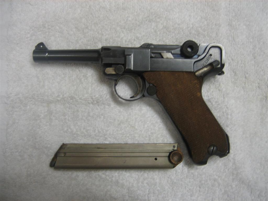

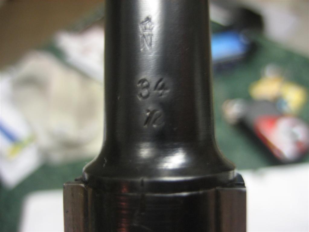

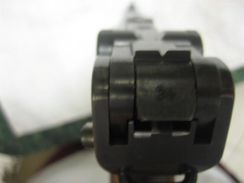

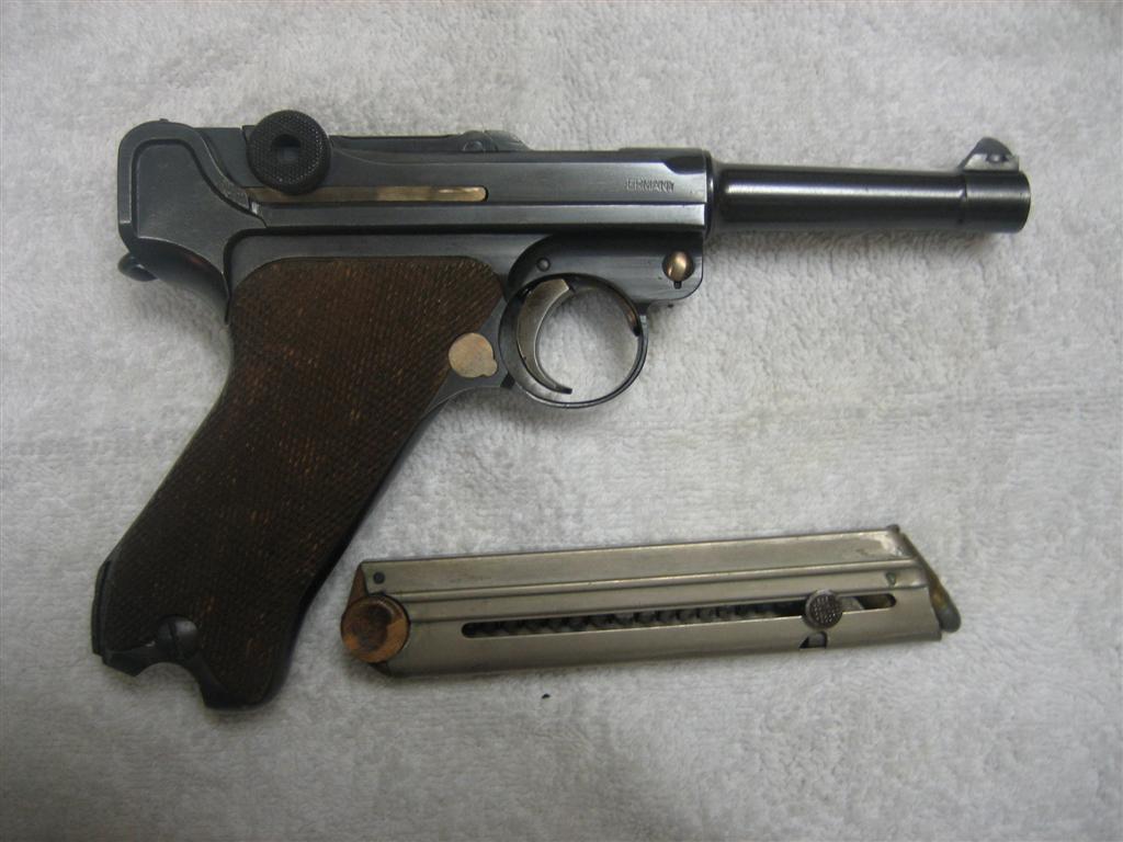

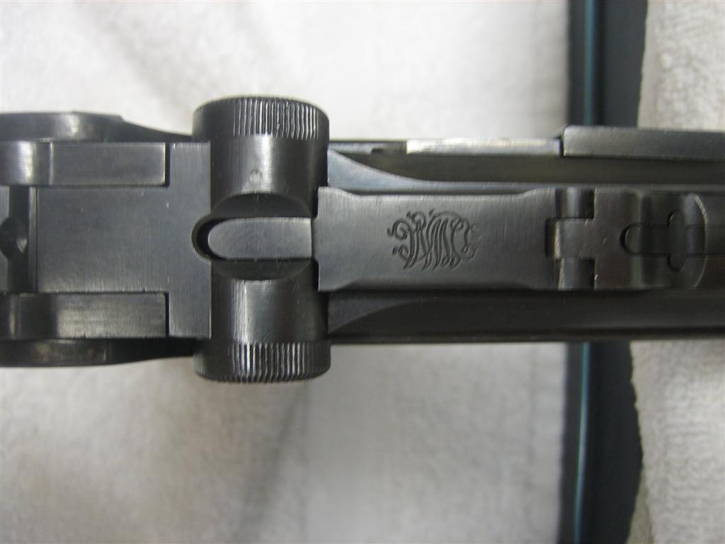

I inherited a nice Luger many years ago. I have never fired it but would like to know more about it before I do. It is a 7.65 NOT a 9mm. I think it is in very nice condition. Can anyone help?
Since I have had such a nice response, could someone tell me whether it would be a Collector or a Shooter?

Well, I have very little to contribute, but it is a very nice commercial DWM pistol. Enjoy it.

Your Luger is a DWM Alphabet commercial. Serial# 34n, made in 1924. The (C/N) (crown over N) stamp under the barrel and on the left side of the receiver, are commercial proofs. Many thousands were imported into the US in the 1920s. The (GERMANY) export stamp on the right side of the receiver is the country of origin, which is on all imports into the US.

This the good kind of import, very correct and collectable, value is not deminished in the least, worth 1,600 to 1,800 in todays market.....very nice

Back east it is still collectable, but value is closer to $1200-$1400 for a commericial in 7.65mm I think in todays market?

Should it be classified a Collector or Shooter? As far as I can tell, all numbers match.

The gun was made for the US market and stamped GERMANY at the factory... Export stamp, NOT import stamped which would be a negative. It is a collector (all #s match and in very nice condition), although many people shoot them because they are not rare. If you break a numbered part though, it's a shooter and worth less than half.

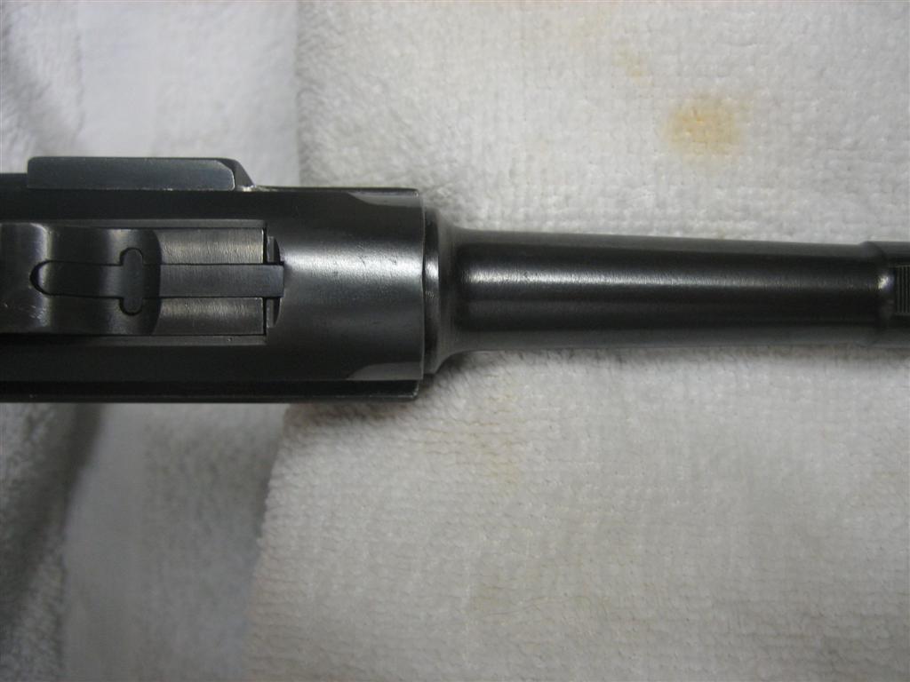

Thanks for the information, I don't want to sound like a child with question after question, but can anyone give me an idea of the Bluing Grade? Or are my pictures not bright enough?

Questions are how we learn. Percent of bluing is very difficult and very subjective. I for one would never make an estimate without the firearm in hand. And even then I am sure several would not agree. From the pictures it appears to be a very nice luger. It seems that diversity in estimating bluing varies more the better condition the firearm. I have very little problem with 80% or less. But between 90% and 98% the fun begins. I think it was Ron Smith who had some good guidelines on bluing. Maybe he will respond to this. Bill
