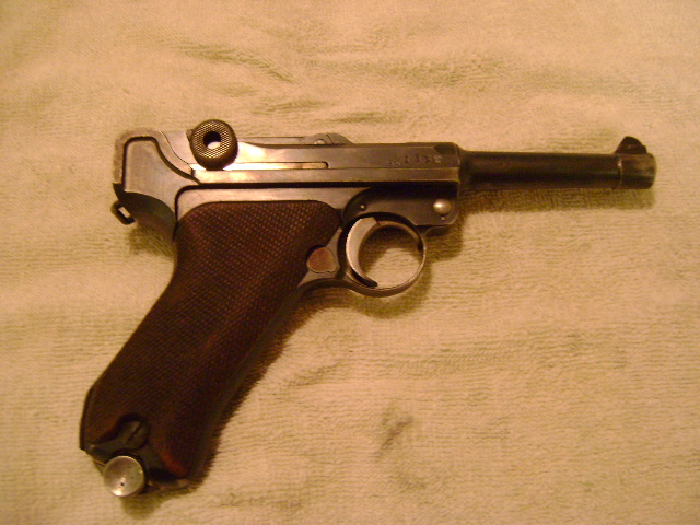

here is my luger to match up with Carls.
Tell me what you can. Thanks.

Very nice. Does this pistol have matching mags numbered 1 and 2?

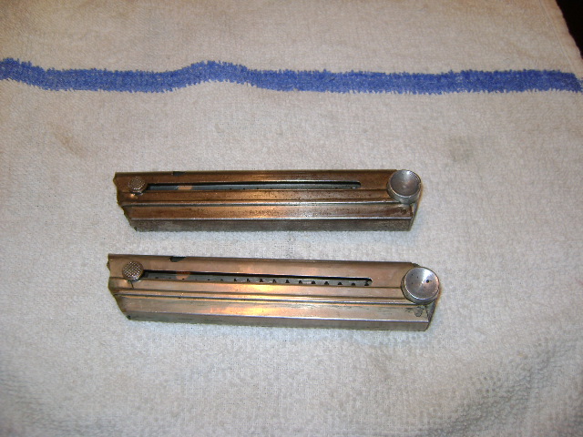

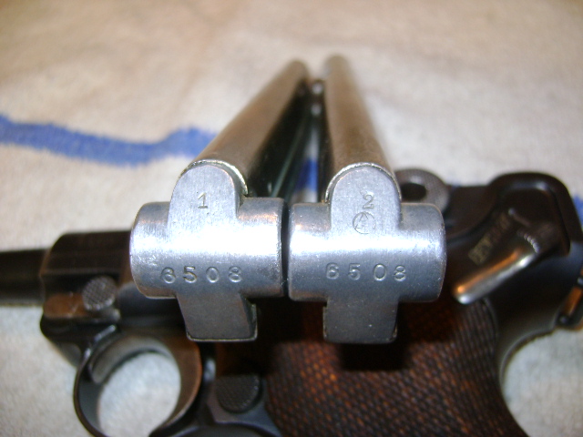

yes they do. one mag. has a circle with a triangle, inside
the triangle is an "s".(mag.#1)
Any idea why there are no unit markings?

Dirtmover....it is a Simpson commercial mag....very nice
Unread 01-22-2009, 08:47 PM   #5
Very interesting.
I'd love to see the bases of the magazines. I am not disagreeing with Howard, but I call them replacement magazines, made for the commerical market. Since they were only selling lugers to the army and police in the Weimar period, I assume "commericial" meant to the police.
I estimate that only about 30-40% of police guns received "unit markings"
HPWEVER, yours is unit marked, that is the S.P.L. marking, these guns were just marked differently.
ed

I own a few SPL gun and while all have matching mags, none are the circle tri S......but I have owned a few of the mags, and in dealing over the years with respected collectors, all have concur commercial....they could have been make just for comercial sale of a mag alone...just a poor guess....

the magazines are all metal,no wood.SN#same as the weapon and stamped 1&2 Only the one has
the mark.

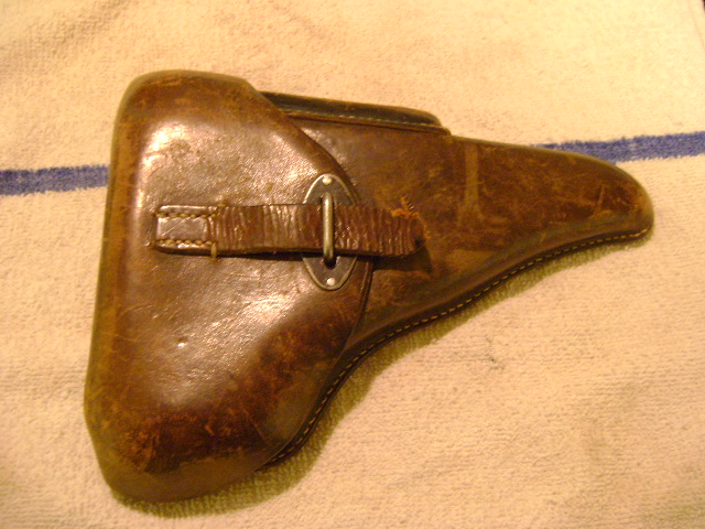

that had just come back from the war. It came in a p-38 holster. The color of the holster appears to have been black

here are the clips and holster.

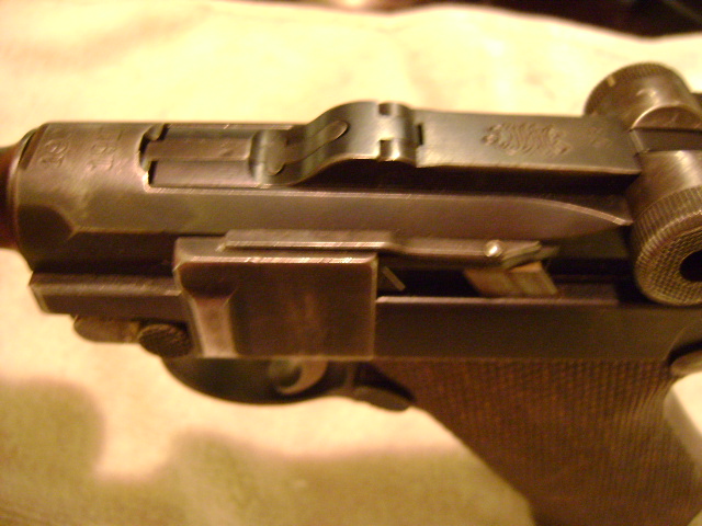

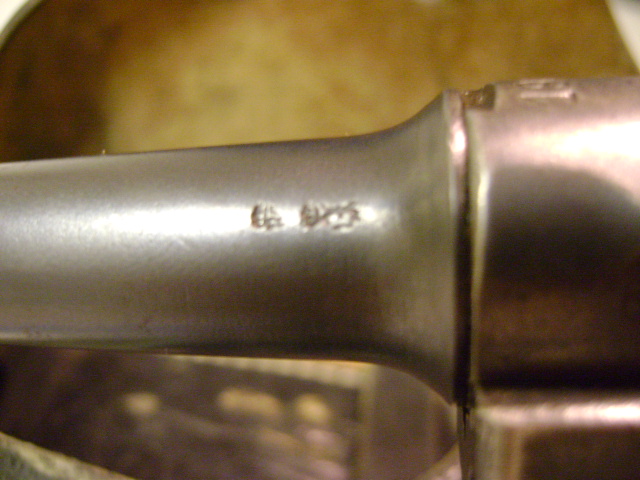

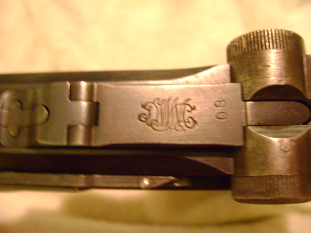

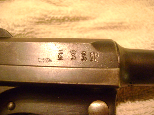

The notch machined into the front of the receiver, above the date, indicates that this was originally a long-barrelled LP08 "Artillery" model. The barrel has been replaced by a standard 4" one. The commercial crown/N stamped on the right side of the receiver suggests that this was done by a non-government gunsmith, and its location suggests that the work was not done near the state proofing office which proofed DWM production in Berlin.
It would be useful to see any other marks on the barrel, and whatever marks might be on the breechblock, as well.
Unread 01-23-2009, 11:20 AM   #10
I agree that your luger was probably originally made as an artillery model and was still in military use in 1920 when is was converted to the 4" barrel. Sometime later in the Weimar period it was used by a Saxon police unit and continued in police hands into the Third Reich when the sear safety was added. Lugerdoc

Here are the stamps on the barral.

The holster is for a P-38 pistol.
But I really loved the whole rig!
Congratulations.
