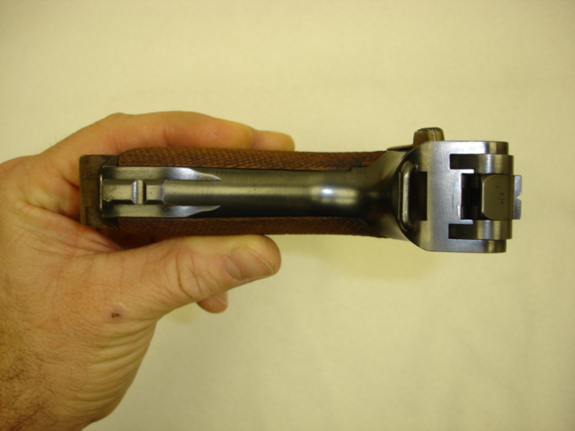

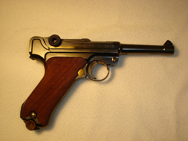

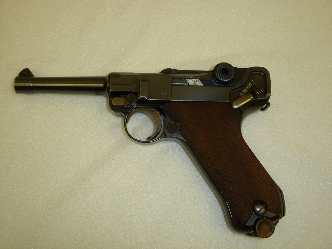

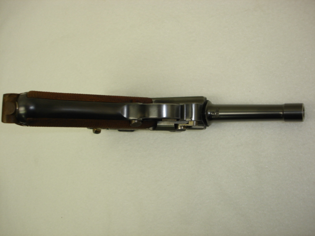

Hello,
I have a 1914 DWM pistol that my father and I purchased from the widow of a WWII veteran that told her that he brought the pistol back from the war. The way we got it was with a hand made shoulder hoster that the vet supposedly made and has some U.S. unit markings along with his name. It has two wood bottomed magazines that do not match the pistol's serial number.

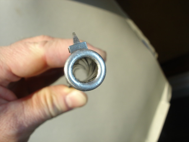

The pistol itself is very clean and looks fired minimally as there is almost no wear internally and the bore is excellent and without pitting. The only bluing wear that I can tell is around the muzzle, the front sight, and the slightly at the sharp edges of the frame that would seemingly be contacted by the holster. On the trigger plate, there is also some slight wear and what appears to be very slight pitting on the front edge and the high area near the take-down lever. The straw color looks pretty good too, only having slight wear on the edge of the take-down lever and trigger.
In taking it apart, all the numbered parts match, including the grips. The only problems that I noticed are that the left grip has a chip by the safety lever and the hold open catch spring is missing.
I am assuming that this is an original finish pistol due to the interior slide and frame surfaces being free of bluing.
I know that the pictures are not the best and did not specifically take pictures of the inspection marks but would appreciate any input regarding this pistol.
Thanks,
Jim

Jim,
Great find!!! We all dream of finding Lugers in this condition.

Jim,
Wow! That's the nicest looking WW1 P08 I've ever seen. Congrats on a great find!

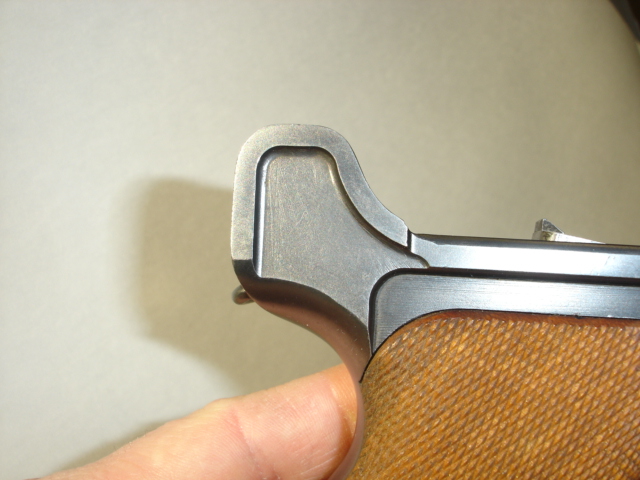

Welcome to the forum. The spring would not have been numbered, so that is not a big deal (JUST the spring correct?) and the chip on the grip affects the value for some collectors,but only minimally.

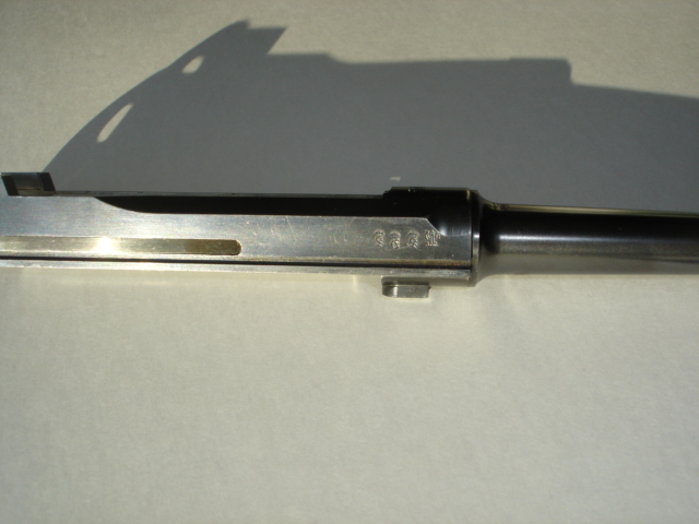

It looks very nice, but perhaps too nice. I would like to see larger and closer shots of the right and left and the underside of the barrel and frame serial numbers.
There doesn't seem to be any milling marks in the right side; and there is; on an unrestored luger.

Jim -- That assumption is a little bit over-simplified. Professional restorers know the correct finish, so they seldomly make mistakes in "color". Close-up pictures -- marks, edges, pits, muzzle, .... just assume you're selling the gun.... I know you're not, but ID procedure is same..... detail is everything. This is the best military DWM that I've seen. It's very lucky to have it (most DWM in great shape are commercials).

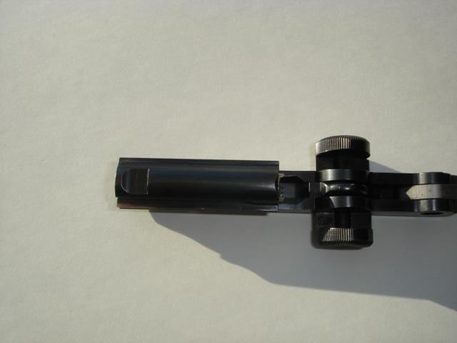

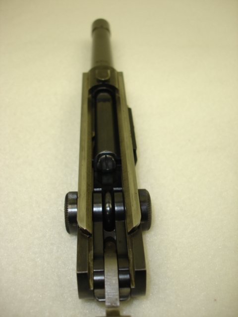

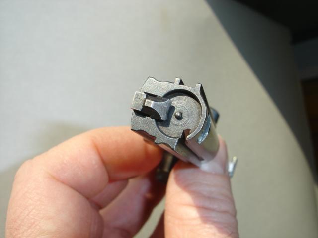

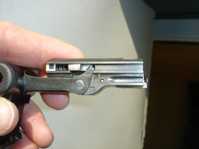

A good close up photo of the toggle train and breech block should reveal whether the pistol has been restored.

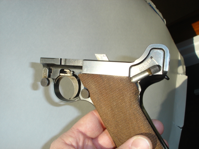

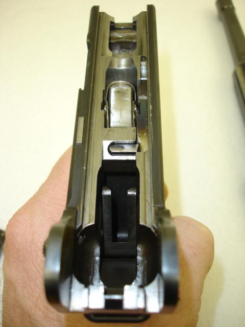

In looking at the frame there are some milling marks present. I will try to get some better shots of the frame sides, toggle parts, and markings and post them. I carefully disassembled the pistol down to the firing pin and removing the grips, checking everything out. The only thing damaged was the grip chip and the spring. It appears that someone broke it off where it meets the hold open lever, but that lever is intact.

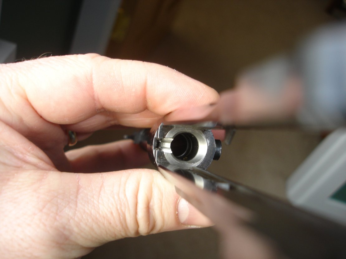

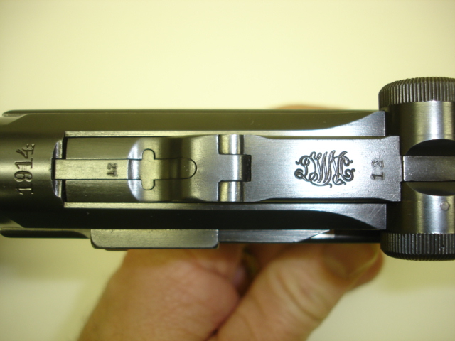

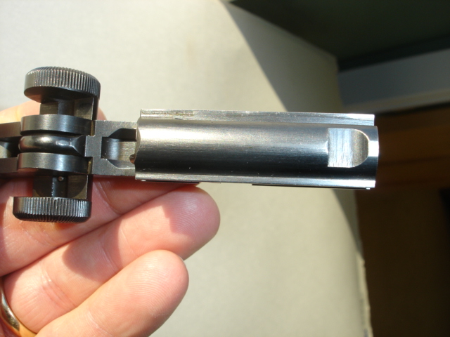

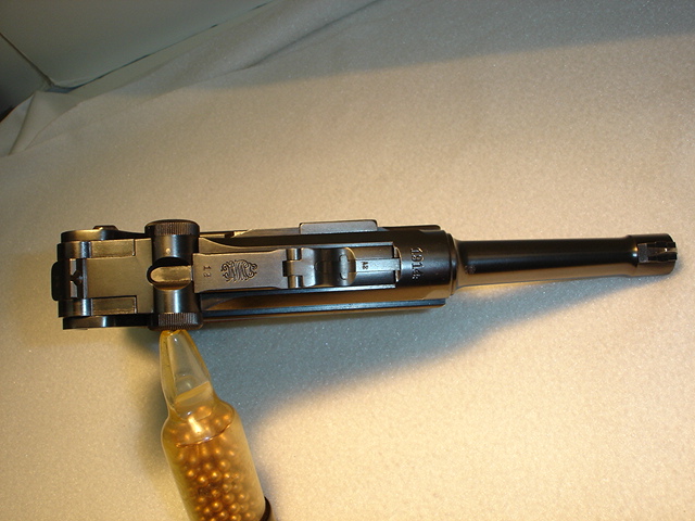

Here are some addtional pictures of the frame, slide, muzzle, take down plate, toggle train, and breech block. Does this look like an orignal or a rework?

Unread 01-19-2009, 06:38 PM   #11
Beautiful gun. Looks original to me.
Unread 01-19-2009, 09:59 PM   #12
Jim, need one photo of the top of the toggle train and breech block.

If it's been redone I can't spot it!
Beautiful gun, we don't see many like this so when we do we are suspicious.
This would make a great example gun, so if you have the time to take clear detailed close-ups of the entire gun, I would appreciate it and I am sure others would too.

Here is a shot of the top of the breech block and toggle train. What is an example gun? By what I understand from reading the forum posts, this isn't a rare variety of the luger, just in nice condition. Is this correct? I guess my next question is what kind of value does something like this pistol have?
I would be willing to take more pictures of this pistol. Are there other "example" gun pictures on the forum for me to base them on? Plus, I am having a tough time getting good pictures from my digital camera. Any suggestions?

Unread 01-20-2009, 01:35 AM   #15
An "example" gun is one that can be a reference for which other guns can be judged. Your Luger is a very pristine "example" and is a standard for reference.

Thanked 48 Times in 19 Posts
Should the toggle pin retaining pin be in the white on this model?

Unread 06-10-2009, 10:39 AM   #18
I see halos and sharp edges and mill cutter marks on the toggle, all of which are good...Chamber is in the white and barrel extension around it is blued; good again...
A good close-up of the frame ears would be nice...I can't really make out any round mill cutter swirls...they're probably there, I just can't make them out...

Thanked 8 Times in 6 Posts
That is an absolute gem and a half, beautiful pistol!
