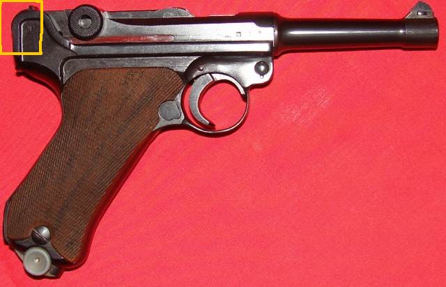

First picture shows a nice enough Luger from the left side.
Looks pretty good. Here's the right side.
Again, the finish is very nice, no rust visible, no dings...Ready to buy?
A beginning collector who hasn't read much or talked to a more seasoned expert would be getting pretty excited by now. The finish looks great, and so do the grips.
Ah! But a more seasoned eye can already tell it's time to run far away. Or at least doubt the veracity of the sellers story, and relagated this poor pistol to the status of being "a shooter" by what's shown in the photos. Can you see what they might be?

Note also the Mauser "Hump" introduced in mid-1937.
