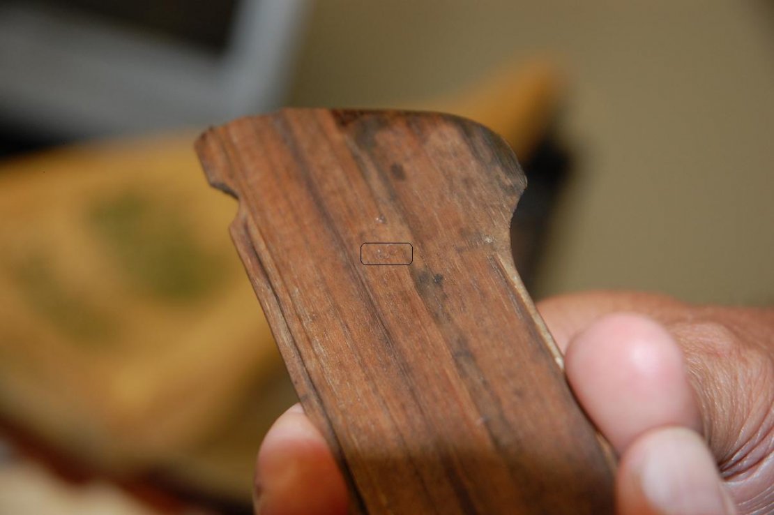

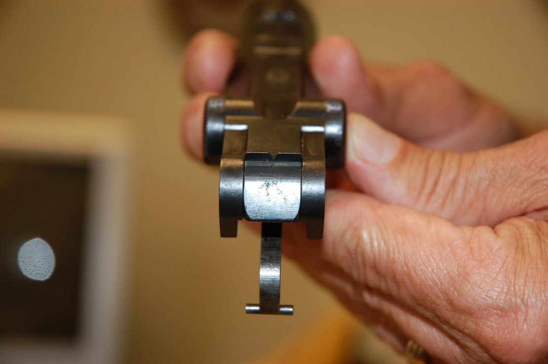

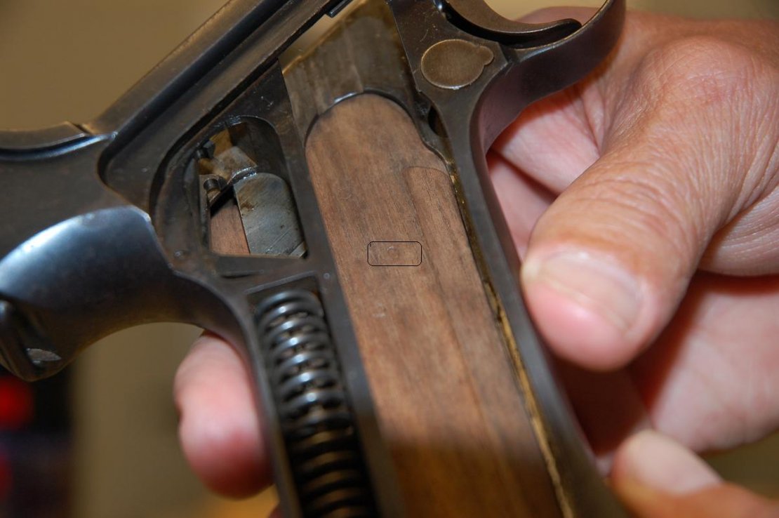

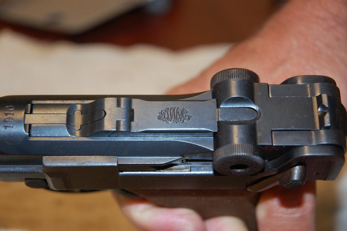

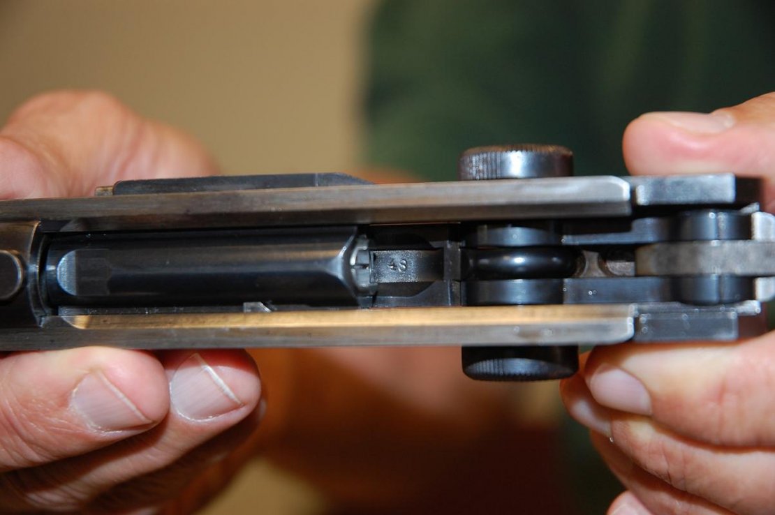

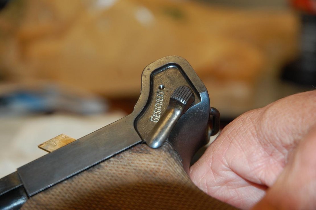

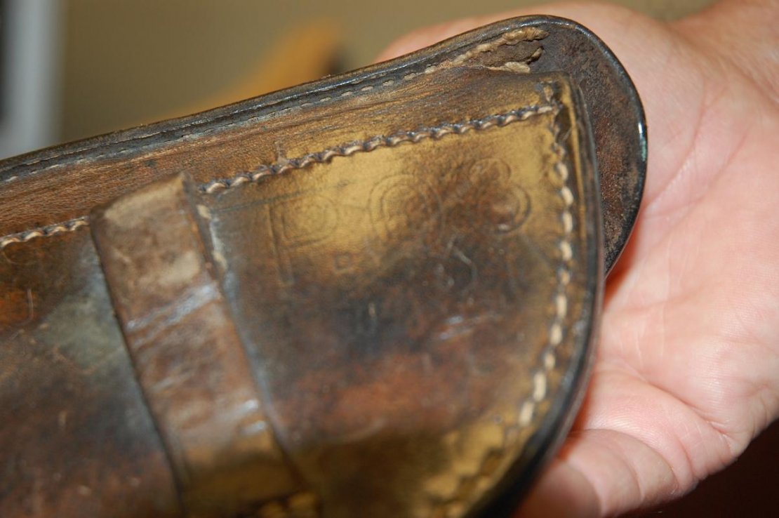

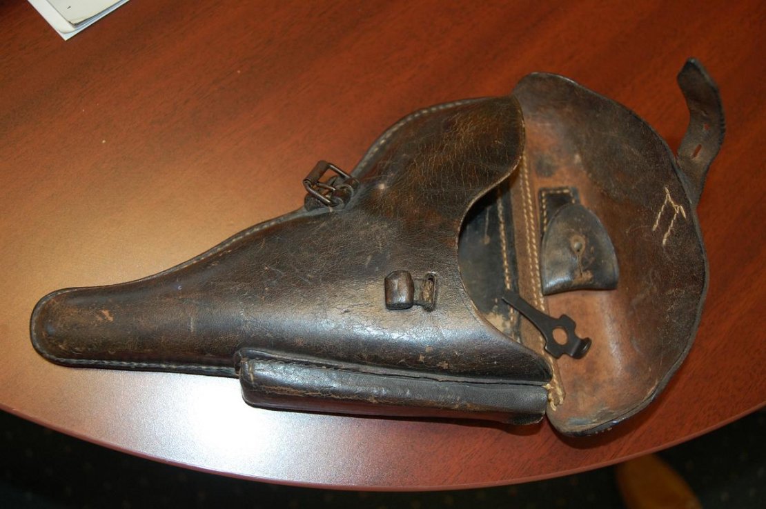

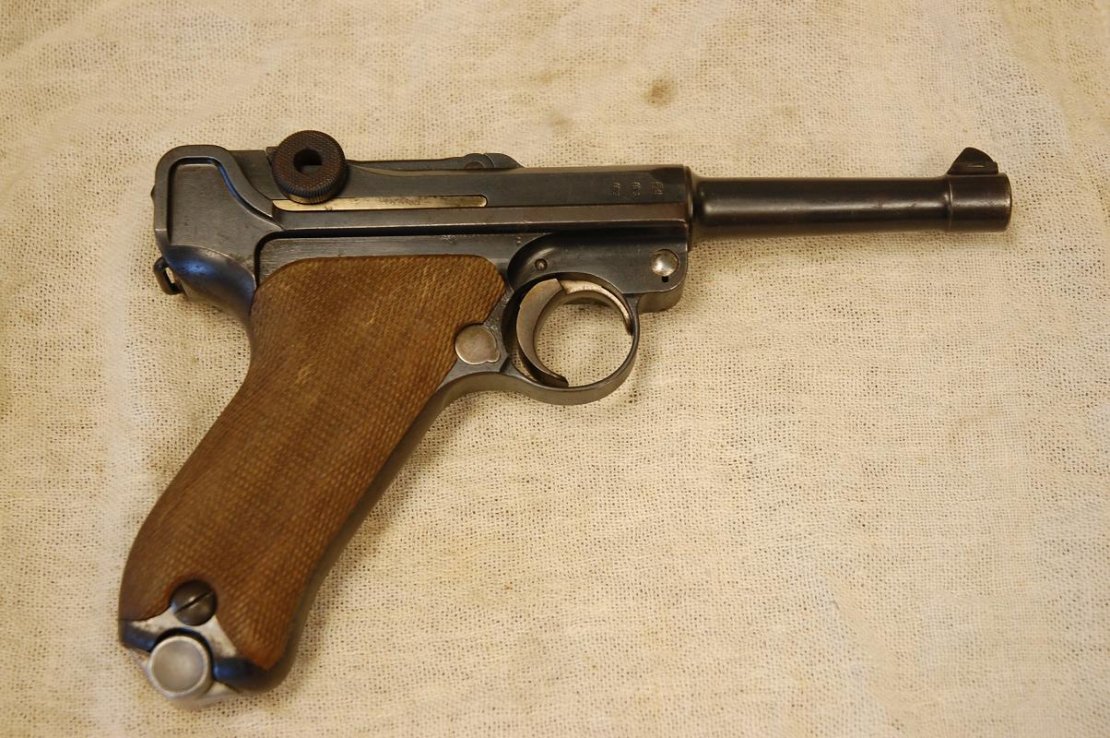

OK guys. Here's the promised photos of The Dude's Luger. Just for grins, I've also attached a shot of his registration card in San Leandro, Ca. right after the war where he registered this pistol and had only the "1910" and the 883 as numbers with which to do this. No Serial numbers. Any idea when this pistol might have been made?
Steve Clarke

Steve, Nice pistol! All 1910 pistols were made by DWM. Karlsruhe (Baden)
Deutsche Waffen- und Munitionsfabriken Aktien-Gesellschaft (German Weapons and Munitions Works), known as DWM, was an arms company in Imperial Germany created in 1896 when Ludwig Loewe & Company decided to unite it's weapons and ammunition production facilities within one company. In 1896 Loewe founded Deutsche Waffen- und Munitionsfabriken with a munitions plant in Karlsruhe (Baden), formerly Deutsche Metallpatronenfabrik Lorenz, and the weapons plant in Berlin. Shares that Loewe had in other gun- and ammunition plants were transferred to DWM. This included Waffenfabrik Mauser, Fabrique Nationale d'Armes de Guerre (FN) in Belgium and Waffen- und Munitionsfabrik A.G. in Budapest. The DWM was orchestrated by Isidor Loewe (1848–1910), as his brother Ludwig had died in 1886.

Hi

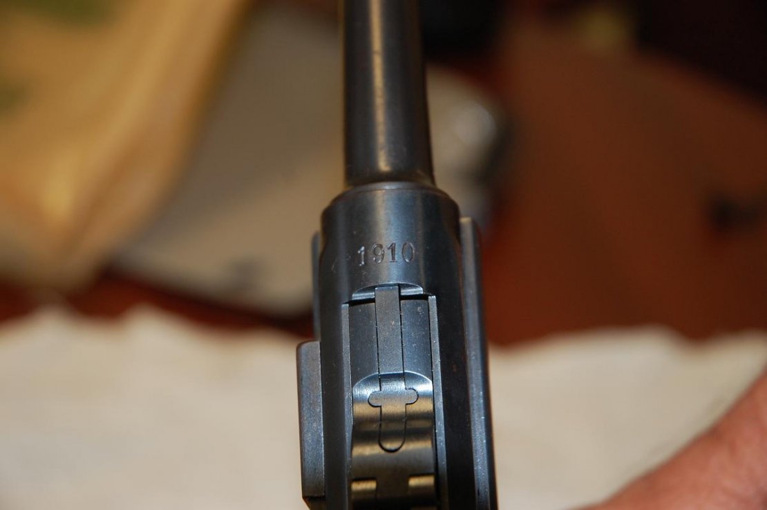

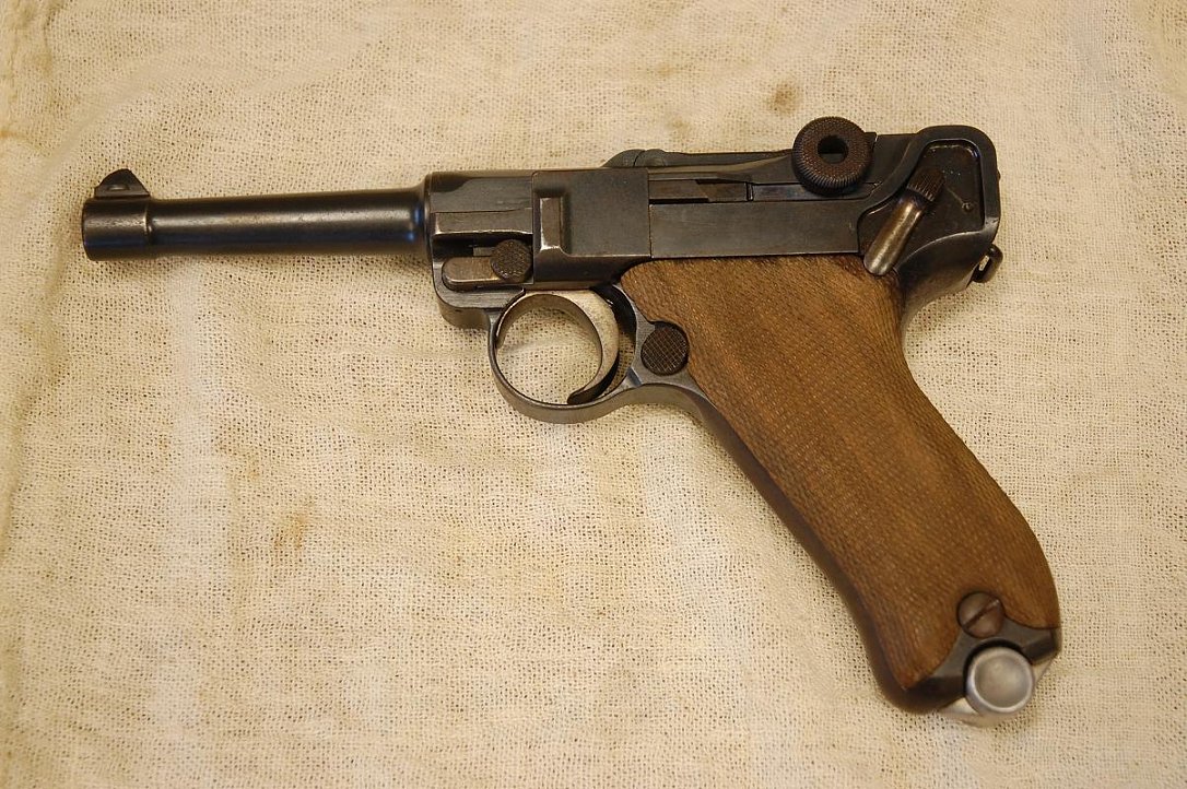

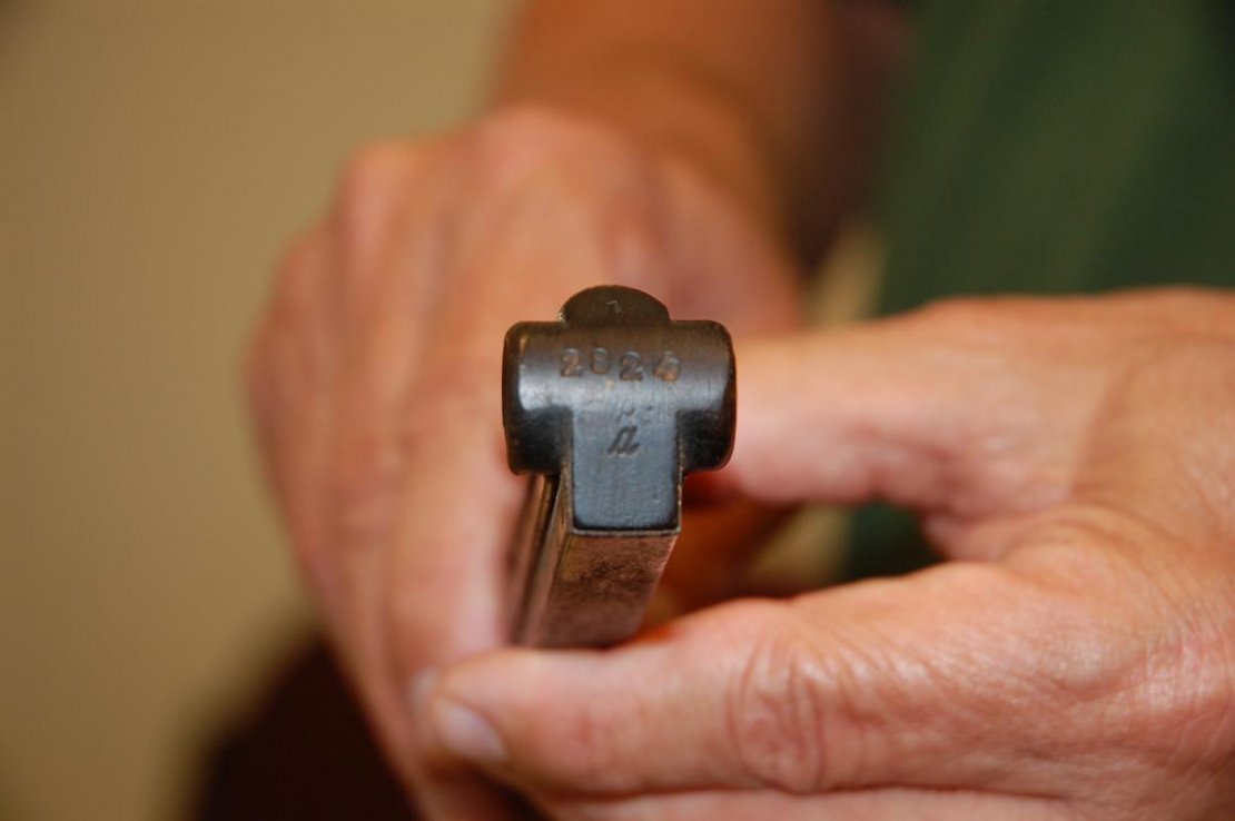

This fine Luger is a 1910 made P09. If you look close at the last pic. you can se a small proof stamp just above and to the rear of the trigger. This means the pistol was brougt back to DWM in 1913to have the "hold open" added.
Strange about the ser.# It is supposed to be located on the front of the frame just under the barrel, but should end on "49" as you can se on the other parts wich are numbered to the gun by the last two digits in the serial number.

Btw. The magasine with the wood buttom is the correct one for this pistol.

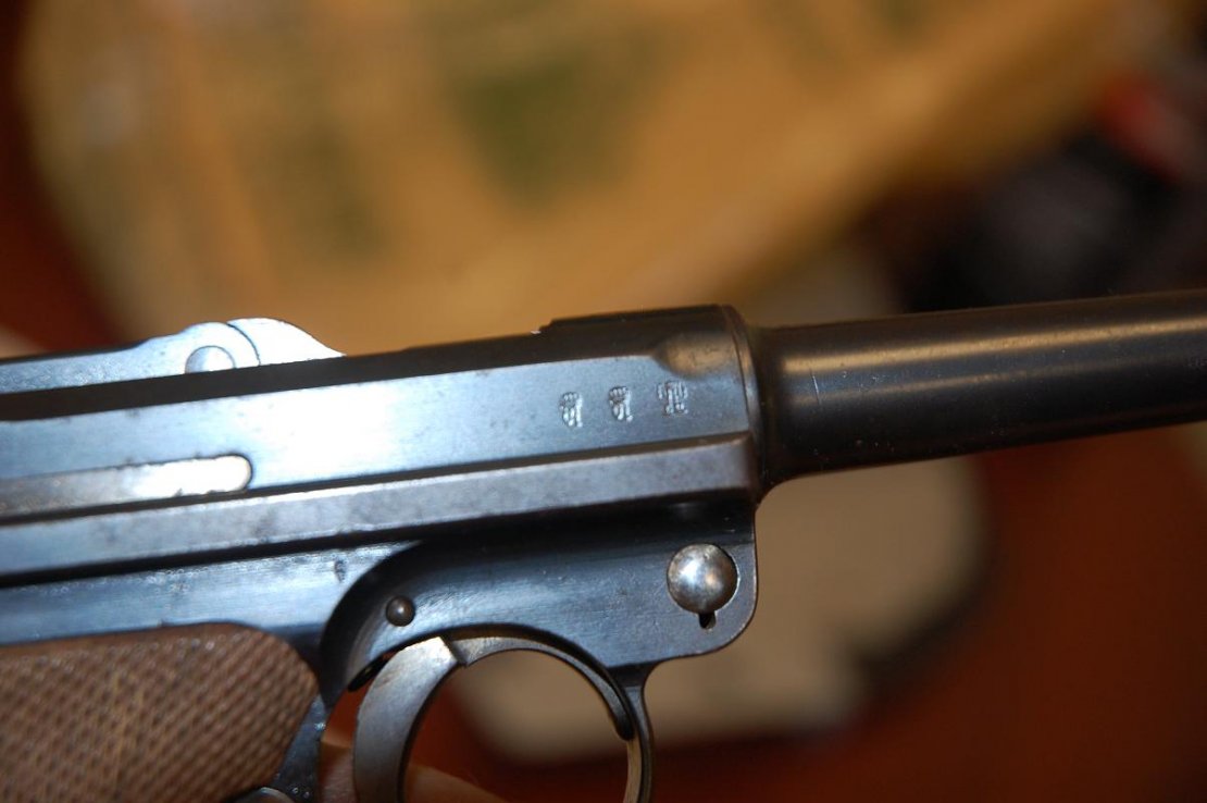

It is estimated that 17,000 1910's were made. Reported ranges of samples reported are from 5095b to 5358d ( this data may be slightly out of date but it is close)
Your SN range should fall between these numbers, each block being 10,000 guns.
Your gun does appear to have had some numbers removed from the frame just under the barrel, you can provide a picture of this area if you like?
The number just in front of your receiver lug look like a â??5â? and this is a third number of your true serial number â??548â? there may be another number before the five for example â???548â? .You guns serial number had what we call a suffix just below it either a â??b. c, or dâ? Here is a picture of a 1910 Luger SN 648 and how the lug picture looks for that gun.
What I found very interesting doing this research on your gun is that I found 3 other examples of 1910â??s that did not have SNâ??s on the barrels. I didnâ??t realize how interesting a study 1910â??s were.

Here is a pic. of my 1909 P08 to show as an example, where and how the serial number on the frame are supposed to be locaded and look.
Regards:
Ingvar

Please provide close up photographs similar to the one in post #12 showing the front of the frame above the trigger guard, and also the bottom edge of the sideplate, and the left side of the receiver ring...

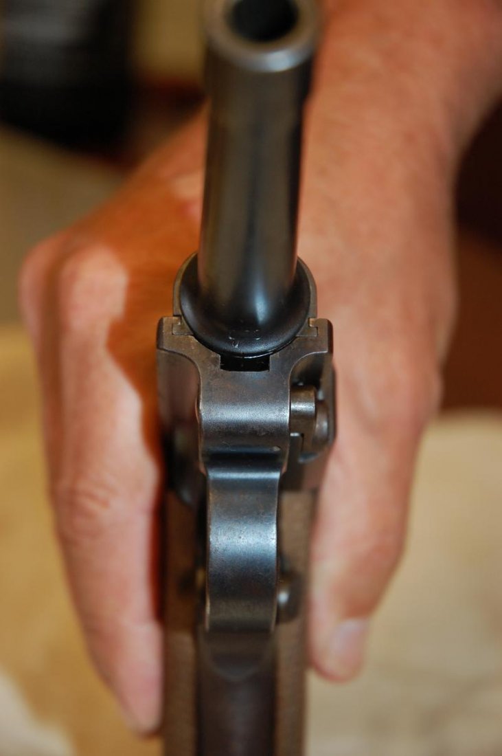

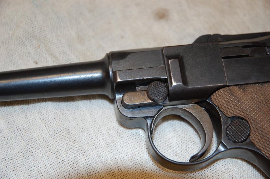

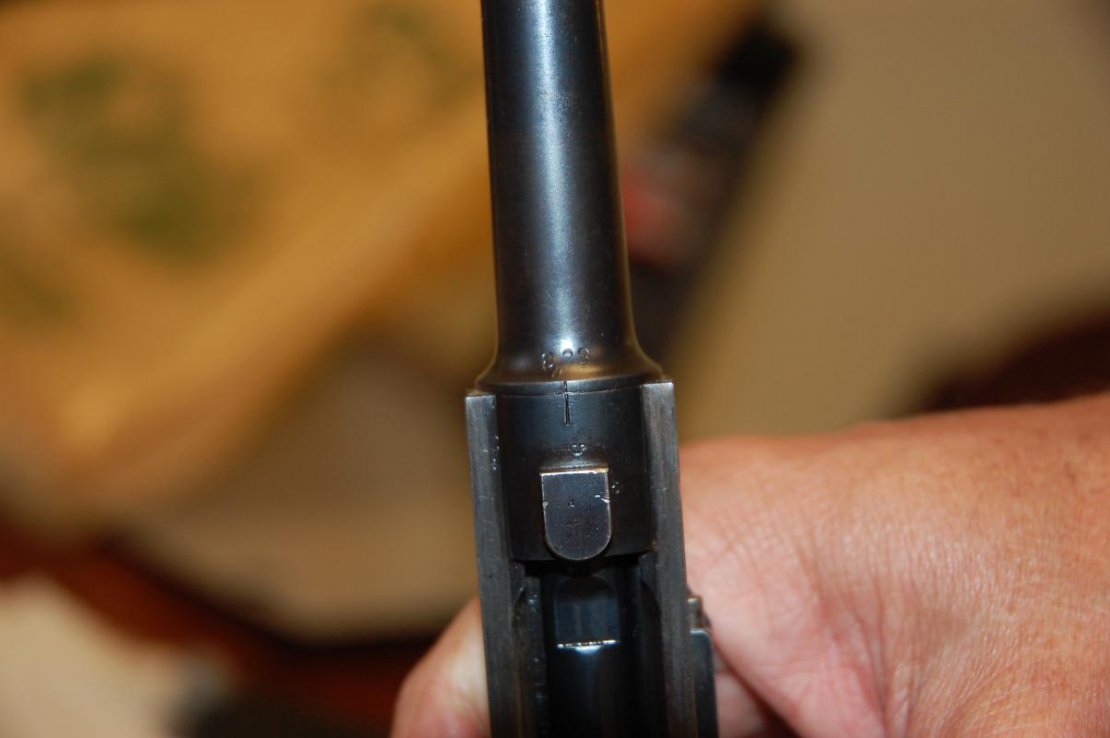

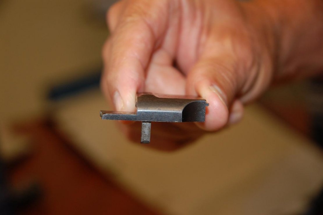

OK, Gang. Per John Sabato's request, here's a couple more shots for the books. Unfortunately, though, I'm such a newbie that I don't know what the "receiver ring" is. Maybe there's another term? Please let me know and I'll get off another shot.
Thanks for you patience.

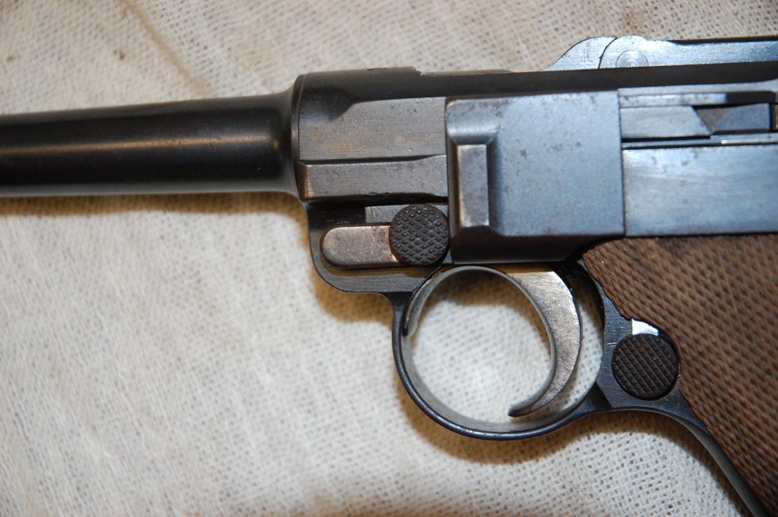

Unread 12-23-2008, 04:39 PM   #19
The receiver ring is the forward part of the upper receiver into which the barrel is threaded. The photo I wish to see is the foward left side of the upper receiver where the serial number is usually stamped on this part.
The last photo in Post #7 shows the right side of the pistol... please show the left side in the same clarity and position.
I think this is a very early 1910 commercial model pistol... that is why the lack of visible serial numbers... a very interesting specimen... at least to me.

OK, John. Let's see if this does el tricko (that's Spanish for the trick). Please let me know if we need any more. It's no big deal to take pictures and post them.
Thanks,
Steve Clarke
