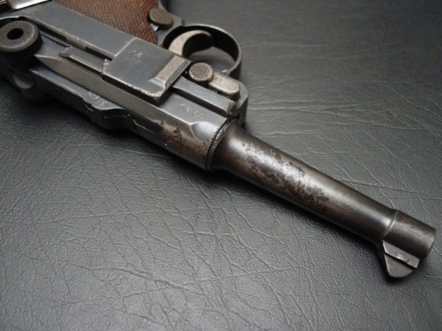

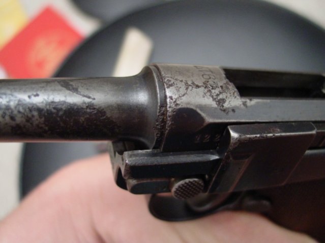

Haven't used it on a Luger but I have used Phil Pilkington's Rust Blue solution on other firearms - a S&W Mod 10, a Colt 1903, a Winchester 94 and several others.
The color didn't come out dark for me - color shade depends on humidity, metal composition, ambient temp and number of times applied - but rather a pleasant antique looking blue gray. Here are a couple of photos of a rusty pitted Colt that I "restored". The pics give a pretty true idea of the color achieved.
Hope this helps. The blueing solution is available from Brownells.
Charlie

Ice- Was that the Pilkington's Classic American Rust Bluing Solution? How many applications of the Pilkingtons did you apply to get that color?

Chuck, yes thats the Pilkington American Rust Blueing solution. I applied 5 coats; wanted a darker color but thats as dark as it would get. Actually it looks pretty good on the old Colt, I think.
Charlie

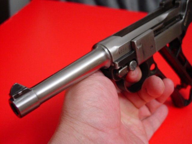

I use Brownells Steel White to chemically strip the old finish. Depending on pitting/marring I carefully draw file the metal or if marring is light I use Wet or Dry paper to resurface the metal. I back the Wet or Dry with a pink eraser or one of those hard rubber body tools from the auto parts store for flat work. For curved surfaces I wrap the paper around a wooden dowel of proper diameter. For me, one of the keys to good work is to study the finish on an original unretouched specimen and try to duplicate the polishing directions, the grain flows and the surface appearance. All of my work is done by hand with the exception of polishing revolver cylinder flutes because thats the only way that I can precisely control the result. Even the cylinder flutes are touched up by hand after polishing to duplicate the overall appearance of the gun. The key is to keep flat surfaces flat and curved surfaces curved, all without ripples, dips, blurring the lettering and markings and without dishing out the screw and pin holes.
Since I am set up to only do kitchen table rust blueing I don't polish to finer than 400. The rust blue has an etching quality that makes a finer polish unnecessary.
I'm not a professional but have received favorable comments from both pros and collectors on occasion but in the end I just do the work for the enjoyment of bringing an abused - and non collectible - firearm back to its original state or as close as possible.

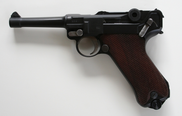

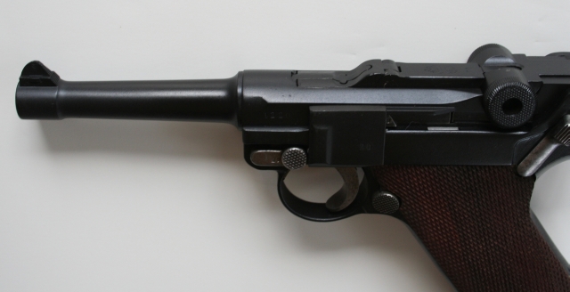

I will reluctantly admit (I am Bubba!) that I have actually stripped, sanded, sandblasted with Alum. Oxide, zinc-Parkerized, and Gun-Koted (matte black) a Luger that was pretty badly pitted. The Parkerizing and GunKoting do not destroy the markings but they do hide imperfections somewhat. The bore (good bore) was plugged with the rubber plugs from Brownells when I parked it. I only parked the frame, receiver and sideplate, but I did GunKote the toggle train. I am still planning to straw the appropriate parts. If I was to do it again, I would use the gun-metal blue Gun-Kote. It now has a super tough, pretty-good looking finish and is a great shooter.
I had originally tried the Brownells Dichropan IM on it but I didn't like it. On my next project, I am going to give the Rust bluing a try.
-Chuck
