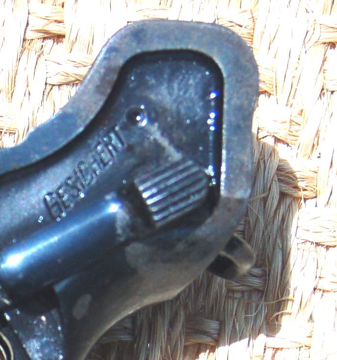

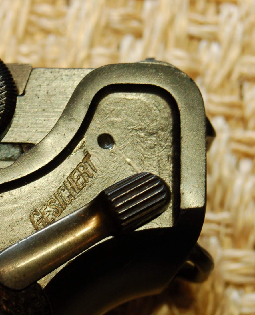

The bump is a reinforcement at the rear of the barrel group.
1936 no bump 1937 bump.
