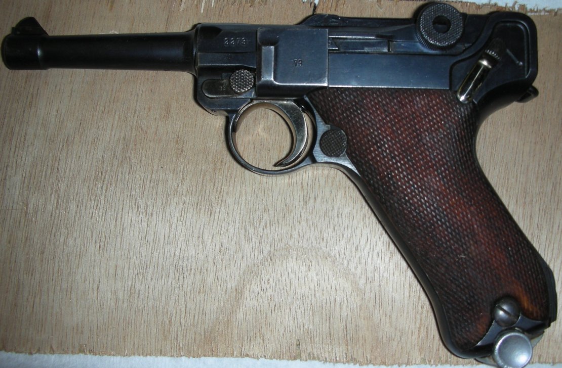

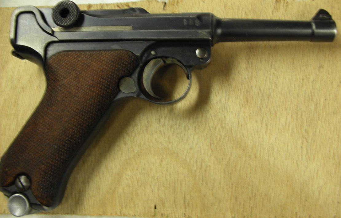

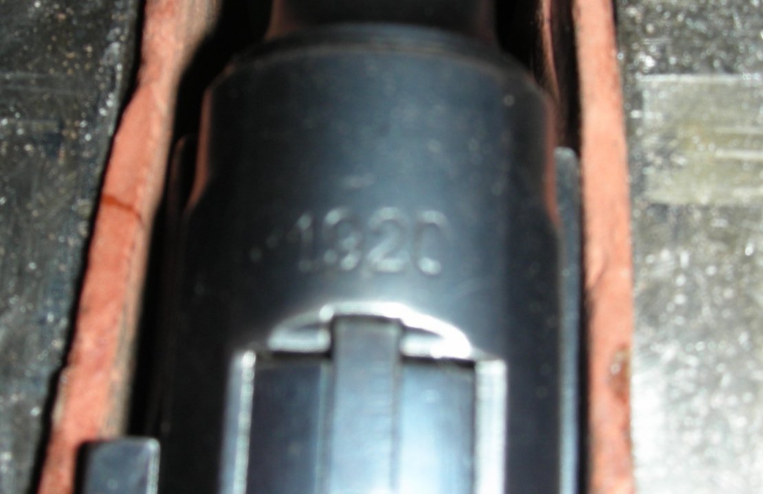

Default Pix re Early Luger Mag x2
I did it and maybe success this time. If these pix aren't good enuf I will do them again. New camera & not much experience with it.
rhmc24@yahoo.com is offline   Reply With Quote

R.H> looks like a nice 1920, worth around $900-$1200 (if all matching and no surprises; reblue, sewer pipe barrel, etc).
PS: Never a nuisance, thats why we are here to help, sorry I have not been very helpful in my replies, other things on my mind this week

1920 9mm with markings on front of grip frame; in 1940 holster with 2 mags numbered to the gun. Bore is clean strong sharp rifling, not as bright as I would like. Last two digits of s/n is on all visible parts and full serial is on both mags, aluminum base plugs. Straw is about 80%. I know it's history from a WW2 vet, since about 1950 and think is is right.

Yor correct, this Luger was made in 1920, so it is the date, not a Weimar property stamp.
