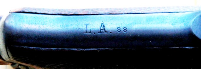

I recently obtained a 1914 Erfurt Luger. Front handle strap has "L.A. 88" mark. "L.A." is twice the size of "88". Wooden handle on the magazine also has "1" with "2" beneath then larger "1". Serial Number is 4686. 4 inch barrel. Face of trigger smooth, checkering on grips has minor wear, blue looks 90%. Generally great condition. I must sell as part of an estate sale. any help?

You most likely have a police luger (which I collect ), the #1 or 2 on the base is a giveaway for the magazine, while the L.A. 88 stands for Landjagerei (rural police) Aurich weapon #88 (provided it is a police gun)
Value depends on condition and originality, low of $400 (if buffed bad or nickled) to around $1200

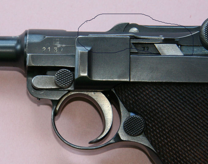

Does it have a sear safety like the picture here?

"L.A. 88" may signify Feld-Luftschiffer-Abteilung 88, Stab (The captive air ships) I would be interested in purchasing it.

thanks for the help. it does have a sear safety as pictured. no dings that i can see. i will post photos when i can figure out how to do it. it has matching serial numbers. face of trigger is smooth. otherwise checkering looks good. there appears to be a rejection and recondition proof mark on the side. if i can figure out the pictures i will send them. you both disagree, who's right?

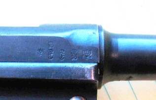

Rich, your unit marking could possibly be a Weimar police marking as that's where the pistol ended up seeing service but...
It started out life as an Erfurt LP08 or artillery and the unit marking loosely conforms to Imperial German Army unit marking guidelines. If it is an imperial marking it would indicate Luftschiffer Abteilung, Waffe nummer 88. Or Airship detachment, weapon number 88. My gut feeling is that the airship marking is what it is. Congratulations.

Rich, IMHO your pistol was made toward the end of WW1 when Erfurt arsenal was using up some LPO8 receivers on their production of normal production PO8s (9x100mm barrels). It may have gone directly into police service at the end of WW1 and the sear safety was added in around 1933. I doubt that this one ever saw service on an observation balloon. Lugerdoc

The grip strap marking is definitely that of the Landj�¤gerei of the Aurich administrative district. Is there any evidence on the barrel of the stamp PTV over an eagle? It would probably be on the right side near the receiver.
Don

I have lightened a couple of the photos to show things better. I don't think there is a PTV/E on the barrel, at least not the right side.
Don

I have looked closer at the markings on the right side of the receiver and there may be a TP stamp above the first Imperial acceptance. This marking for the Berlin Police Armory was introduced in 1935. There is also a police sunburst/C to the left of the other stamps.
Don
