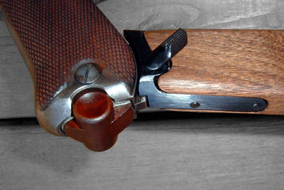

I think it's cruel to keep Bobcam1 waiting.....
The "slot" is intended for the attachment of a shoulder stock thusly:
