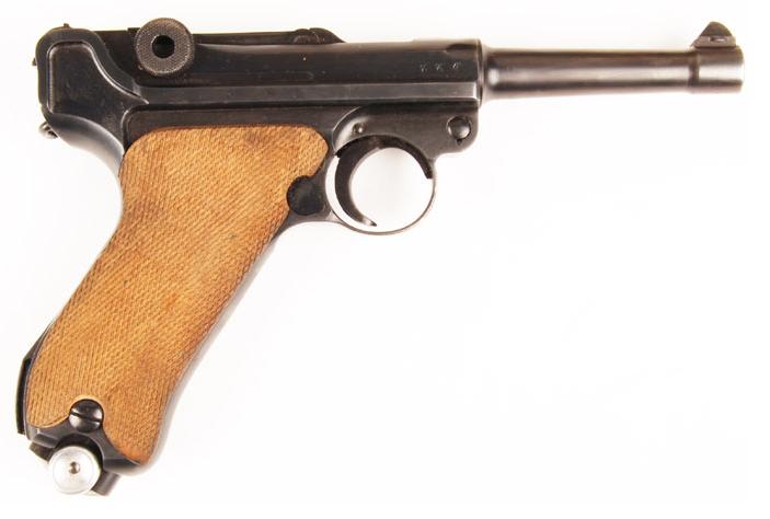

I saw a nice military Luger made from the Mauser Werke Oberndorf (S/42). The pistol comes with a second magazin and a holster (on the picture) for 950 bucks. All parts have the same serial numbers 4149.
The pistol looks good, just the grips are a little bit strange to me, must be post war? What do you think about this pistol?
Sorry this are maybe stupid question, but it would be my first Luger.
Thanks for your help

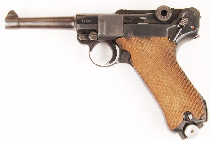

More pictures

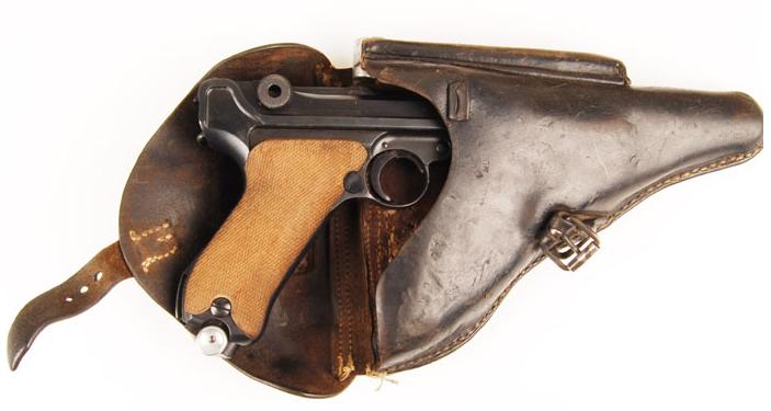

Holster

Unread 10-01-2008, 03:20 PM   #4
The grips look like they have been bleached with a strong solvent, which took all finish off the wood. Perhaps this was done in an attempt to clean them.
Unread 10-01-2008, 04:06 PM   #5
Welcome to the forum.
Yes, when I have cleaned grips, sometimes they get TOO clean and when they do not get the proper oil, they stay too light. I like boiled lindseed, although tung oil is good too, it just depends on the person and what they like to use.
Unread 10-01-2008, 04:45 PM   #6
First question is, are the grips numbered to the gun on the reverse? If so, they are probably original and darkening would be warrented.
Unread 10-01-2008, 05:40 PM   #7
There is some slight oil staining, but the grips look in very good shape to me... If this gun includes the holster, the price is a good one IMHO.

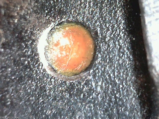

Well, since I only have this one example of enamel paint in the safety indentations, I am hesitant to form any conclusions.
It certainly does seem possible that such paint could be detrimental to the effectiveness of the safety.
Here is a picture of the sole example that I have, taken through a digital microscope at a magnification of 50 X. At this level of magnification, the paint appears more orange than red, but that could be due to the LED lights on the microscope too.
Especially interesting is that the ball on the underside of the safety lever does not appear to be touching the enamel paint. Notice around the rim of the indentation, at the bottom and on the left side, the metal on the rim is completely bare. It appears that the ball is larger in circumference than the diameter of the indentation. Thus, the ball does not actually reach down to the bottom of the indentation, and it does not touch the enamel paint in the bottom.
The safety seems to work just fine, with an audible "click" when going into either the safe and the fire position.
Interesting although I can't explain it either.
Mauser720 - Ron

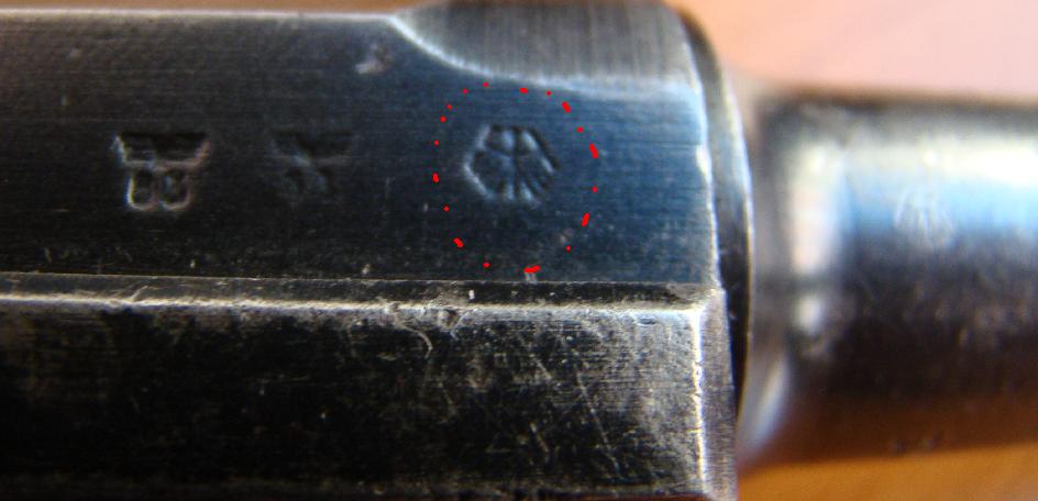

I checked the Luger again with the Technical Information from this site and I'm a little bit confused now.
The arsenal mark is S/42 but there is also 1938 stamped. The Waffenamt mark are two eagles with a number 23 or 63 i quess (like on the picture).
Is it a military Luger used from the Wehrmacht? What kind of stamp is the third eagle (red dots) on the picture, I couldn't find it on the technical informations?

Hello, my Luger has EXACTLY the same symbols, including the one that you have outlined. From what I understand, from the proof pages, page 4, #45, it indicates a Mauser early proof, "G" date and later. The third eagle is there also, as is yours, but different from the one shown in #45. As far as I can find, the closest is proof page 4, #59, second symbol, although mine, (and yours), are different from the one shown. My grips are exactly the same, although my toggle only says BYF. No numbers of any kind. So far, I havent seen the exact same third eagle anywhere to indicate what it means. Can you tell if there are any markings on the breech block? (The part the extractor is seated in)....Mine has a symbol similar to the one on the reciever, that we are trying to determine the meaning of. If you lived in S.C., I would swear we bought our Lugers from the same place! (Too many similarities!!). Anyway, any of you resident Luger experts have any ideas as to what we actually have? Also, anyone able to explain to me how to post pic.s on here, so I can show mine for comparison to this one, and to show all of you that I have been bugging what I also have? (Although, it would be like posting duplicates of heldsburg1's!!). Thanks, and if I find out the third eagles meaning, I will post it here.

Mark and Chris,
The stamps are Test Proofs. Right side of receiver, left side of breech block and right side of barrel. The test consisted of among other things, firing two test rounds that exceeded the standard powder charge by 20%. This info is from Jan Still's, Central Powers Pistols.
