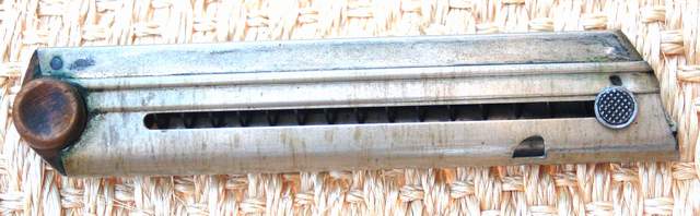

I have a nice 1916 DWM Luger which is all matching except the magazine. I am unsure if the one received with the pistol is correct.
It is blued (more black) with no markings at all except on the base (round part on bottom). Base is alumn or silver color and has an eagle with spread wing and the number 63 underneath.
Is this magazine proper for a 1916 or is it a replacement?
Thanks for any replys.
W David

The magazine you have is for a WWII era luger. The magazine issued with your gun would be wood bottom with the serial number on the wood. Curt

it should look like this

Thanks for the answers. It is truly amazing the amount of collective knowledge available on this site. Not only did I get my answer but also a picture of the correct magazine.
Somehow the magazine I have did not set right with the time period but I was not sure. Eagle over 63. Anyone know what the 63 indicates.
Thanks again everyone, especially zinfull and beachbaker.
W David
