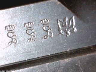

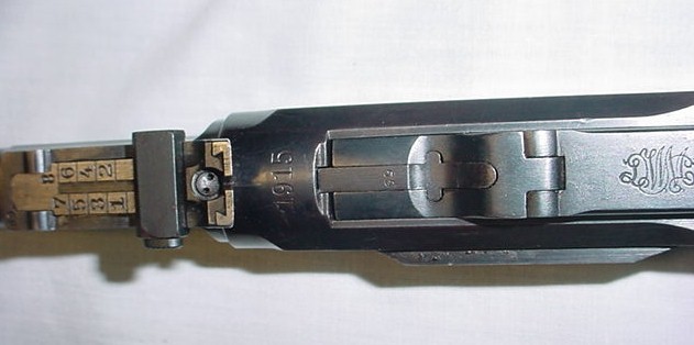

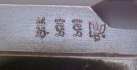

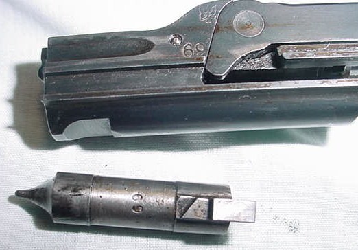

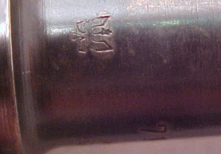

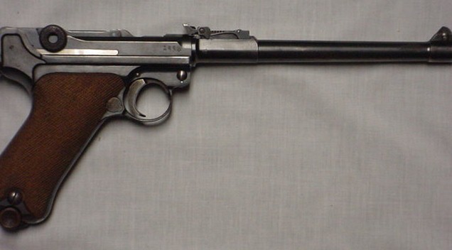

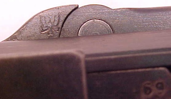

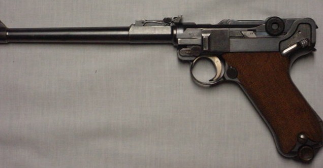

Well, that was my grandfather's favorite expression when he would stumble across something of value or interest when he was least expecting it. I can draw a similar parallel to my acquiring this 1915 artillery. I certainly did not expect it to be in the really fine condition when it arrived. It did not look like the pictures the dealer posted on his web site. I will say however, that the salesperson whom I spoke to did try his best to paint a verbal picture of this Luger. I have done my best along with the help a fellow Luger collector to scrutinize this Luger to the last degree. We found no issues, imperfections or problems with any aspect of this artillery. The only one point of discussion is the proof marks. I sent pictures to one of our more distinguished members, who is also an accomplished writer and researcher. Here is a quote from Dwight's comment:
"It is interesting that the receiver has an Erfurt-style power proof, as do the barrel and the breechblock. These are not unusual, but the receiver proof is unexpected. I don't believe that it represents a problem, but it might be worthwhile contacting Jan Still about it and see if he has any comments."
Please take a look at the pictures. Dwight says the last proof on the receiver or the one nearest the barrel is an Erfurt proof. It would be very interesting to know if anyone else has a 1915 with this proof. Any input will be appreciated.

Old 07-16-2008, 11:48 PM   #2
Jan C Still
Posts: 463
Thanked 52 Times in 32 Posts
Mike
This is the second 1915 DWM with Erfurt style test proof on its right receiver that I have become aware of in the last few days. See links below;
http://www.gunbroker.com/Auction/Vie...Item=104501382
http://luger.gunboards.com/showthread.php?t=15262
It is unusual but sometimes happens. For more information see page 37 and 55 Central Powers Pistols.

Good going Mike. This one I can believe. The one on Gunbroker had an Erfurt toggle train, and there is no way that it was a legitimate 1915 Erfurt arty. I agree with Dwight's assessment that the Erfurt proof on the receiver does not represent a problem. It is one of those anomalies that hasn't been recognized before now. It will be interesting to see what Ron's (Mauser 720) serial number turns out to be. If it is around 71xxa, we have a very real possibility that Dwight is correct about the run of Erfurt proofs on DWM artys in this range.

This is kind of a stretch, but is it possible that Erfurt was using DWM contract parts to build artilleries in 1915? It doesn't make sense, but could explain the Erfurt proof.
Although there are no Erfurt proofs on the other parts, indicating that Erfurt didn't make them.
Did I just answer my own question? Haven't had my second pot of coffee yet...

You make me wish that I hadn't sold my 1915 and 1916. That's an outstanding 1915. Mine wasn't even close to it.

It was not Erfurt parts, but an Erfurt inspector that was re-assigned from Erfurt to DWM and used his old stamp. This is just speculation, but it would explain why only "a" block Lugers are involved and for only just a short run. Many thanks for the kind words about the LP08.

Old 07-17-2008, 07:04 PM   #14
Jan,
It is good to have confirmed that Erfurt-style power proofw were stamped on DWM receivers during a suffix production, thanks for taking the time to check.
RonS,
Remember, that the Eagle stamp was a power proof, stamped after the gun was completed and had successfully fired two proof rounds. Also, remember that the inspection and proof stamps were issued to individual inspectors assigned from the Spandau arsenal.
As a matter of speculation:
It is likely that more than one stempel was made from each die master;
Proof inspector(s) were assigned to DWM in 1908 (or perhaps 1909, depending on when First Issue production actually started), and had what we recognize as the DWM proof eagle--in heraldry, an eagle, displayed;
Proofing of P08 did not begin at Erfurt until 1911 (the 1910 production guns are an interresting study in themselves...) and might have stempel made from a different die master at a different time.
It seems rational that a proof inspector could have been reassigned from Efrurt to DWM for a short time in 1915, and then returned to Erfurt. This might result in an Erfurt-style eagle stamped on the receiver for a short time.
It is not known exactly what the stamping protocol order of the power proofs actually was. It would not require disassembly to stamp the receiver, but it certainly would to stamp the breechblock. It is apparent that the receiver and breechblock proofs were stamped before bluing, and the barrel proof (and serial number and guage) were stamped after bluing. Since there is more than one variable involved in the stamping/finishing order, it is not possible to say that the stamping was done by a single operator, all at the same monent.
Considering the large number of P08 with Efrurt-style barrel and breechblock proofs, it seems reasonable to conclude that these stamps may have been made by more than one operator, at different times, once the gun had actually undergone proof firing.
We know that the receiver was proof stamped by one or more inspectors in posession of the DWM eagle, displayed stempel through almost all of production. We also know that there was at least one inspector at DWM, for a long period of time, in posession of the eagle with cross and chalice stempel. It is a speculation with equal value to the one above, that the inspector with the Erfurt stamp may have had certification of the receiver proof as one of his tasks for a short time in 1915.
We Luger collectors can be a pretty insular crowd. It would be useful to know from examples on other weapons when the respective proof eagle designs--eagle displayed, eagle/cross&chalice--came into use, and what their use might have been in other small arms manufacturer's plants.
And Mike's gun is really sharp.
