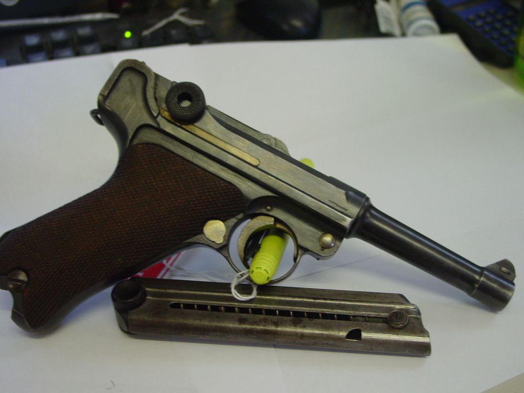

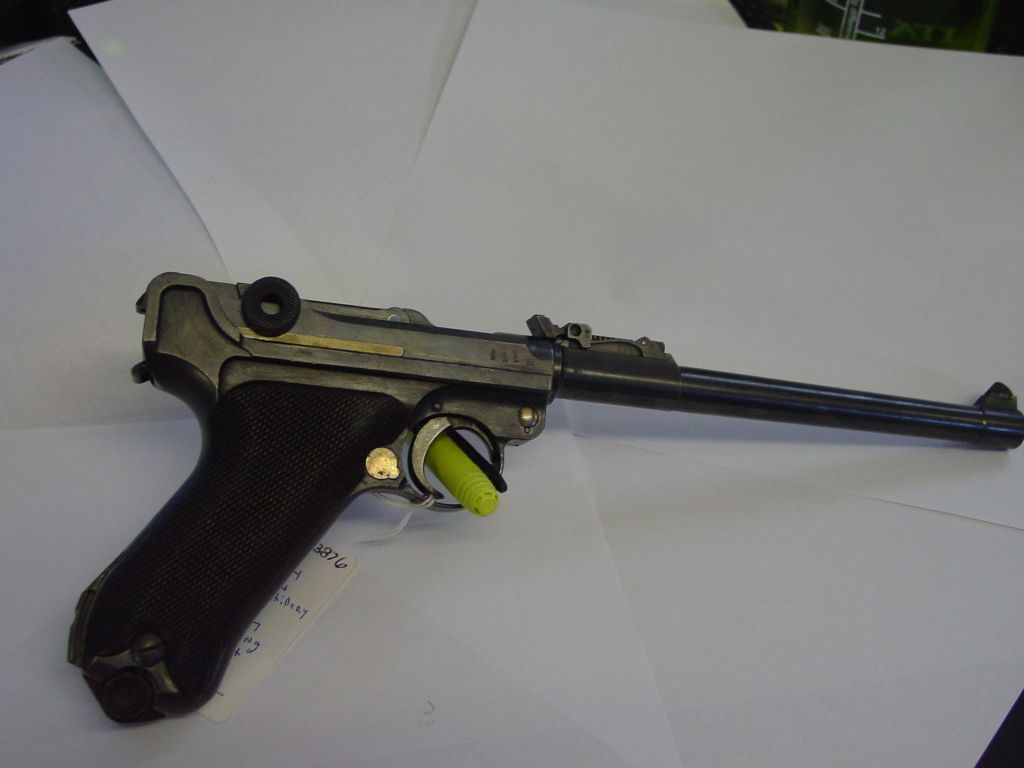

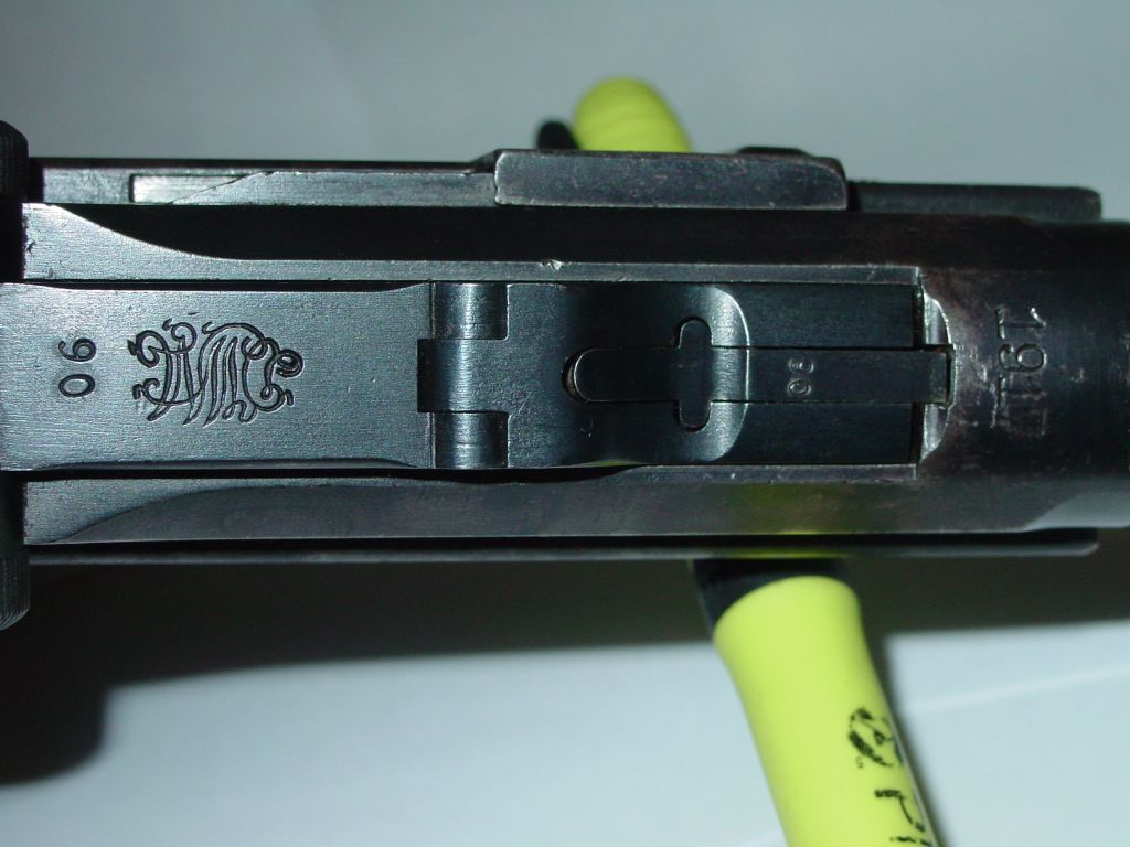

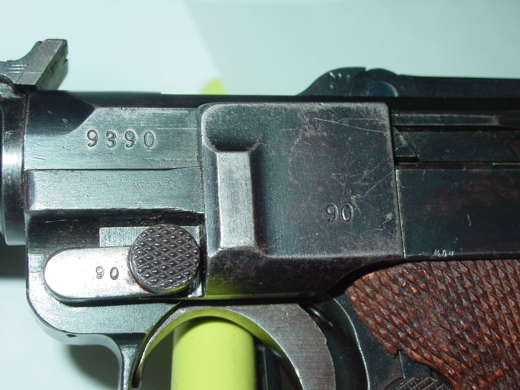

Okay thanks for all the help so far. Here are pictures of the first one my
log # for this gun is #43875.

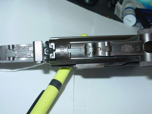

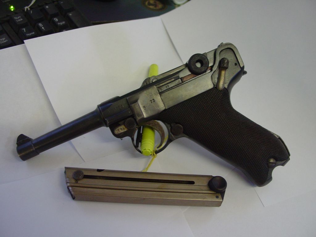

This one is #43876
rdgs is offline   Reply With Quote

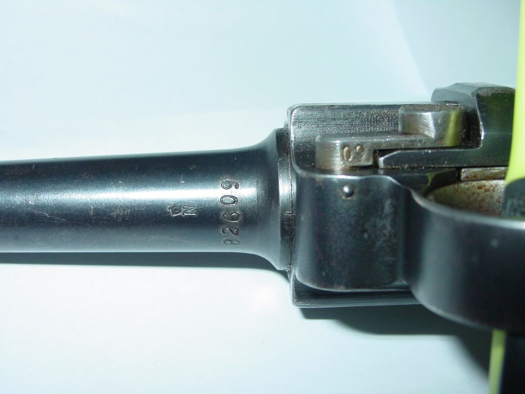

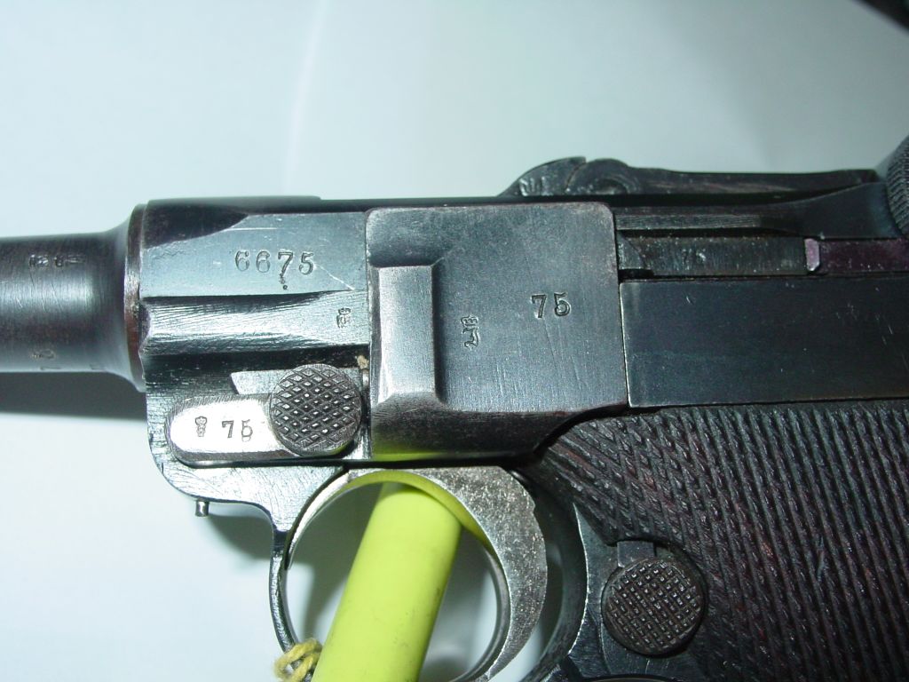

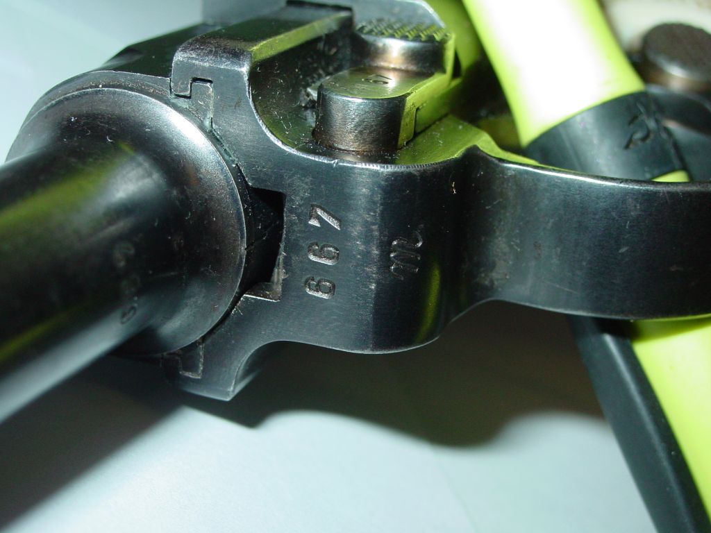

Okay this one is the 7.65 my #43860

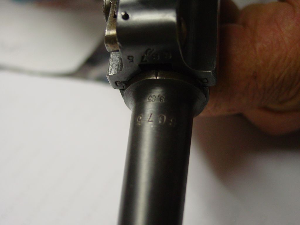

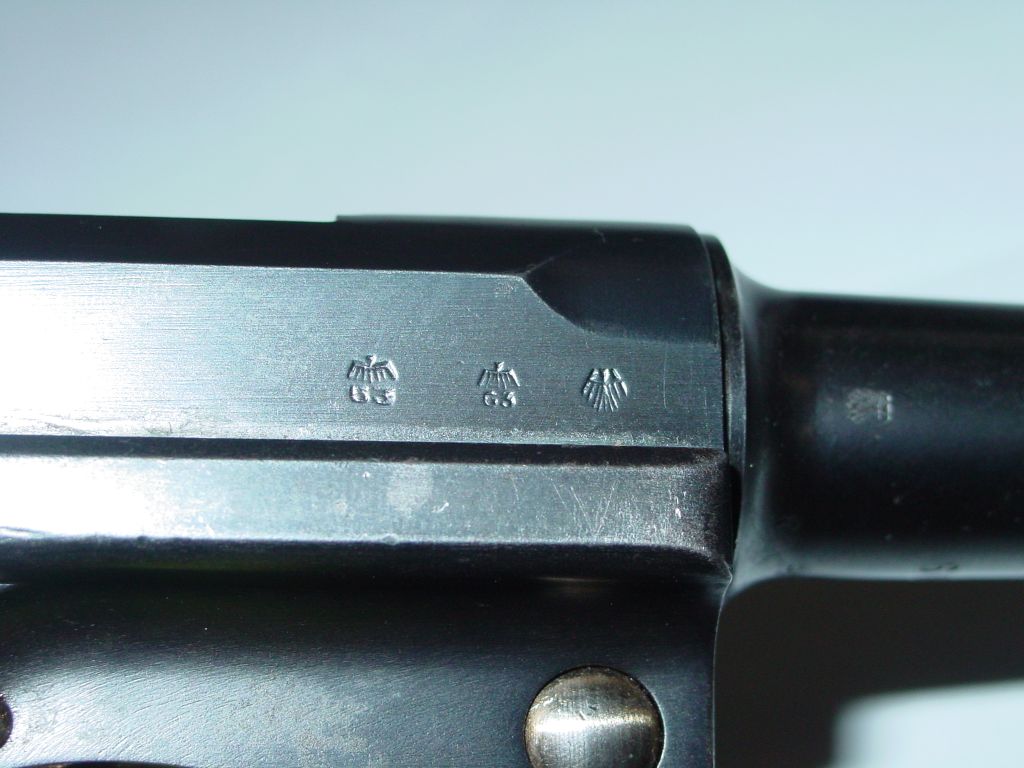

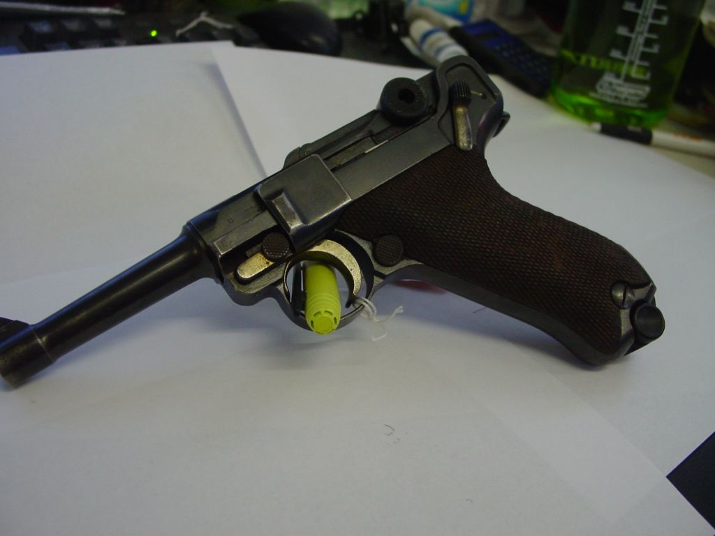

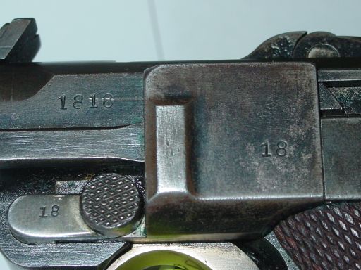

This one is 9mm dated 1918 all #'s matching
Unread 06-28-2008, 11:20 AM   #10
rdgs
Join Date: Jun 2008
Location: Pa
Posts: 8
Please let me know if I've listed the pictures above okay or if there is some other way I should be doing it. I'm not very computer friendly so any help w/that would be appreciated!! I do have pics of the Luger w/the Ivory grips but I will wait to make sure the pics above are okay.

I really like the unusual unit applied red nine; I havent seen one with that shaped bottom before. A cool anamoly.

Do you believe that would have been done at the factory? The inside of the grips has the 18 from the serial #.
Unread 06-28-2008, 11:38 AM   #13
"Do you believe that would have been done at the factory?'
Nope, a field armorer would have added it by directive. The traditional European 9 which looks like a lower-case g.
Unread 06-28-2008, 04:01 PM   #14
I believe that these two artilleries are currently being offered for sale by a gun shop in Gettysburg PA. I first caught on to them on Gunbroker.com with no photos and a starting price of $.99 and a buy it now of $5000 each. Out of curiosity I diverted from a trip to Allentown some months ago to look at them and asked at that time if there was any room in the price. I think that I was told that bottum dollar was $4800 or something like that. I thanked the nice person there and went on my way.
I did not take the pistols down but they did look good. As Tom says, the red nine is a very pleasing variation indicating company armorer work. I would place that pistol at a high of $3000 because of the grips but keep in mind that there are few who would pay that premium for the unique grips. The other artillery is perhaps $2000+ if you are patient. The P08 with ivory grips is an $800 pistol.

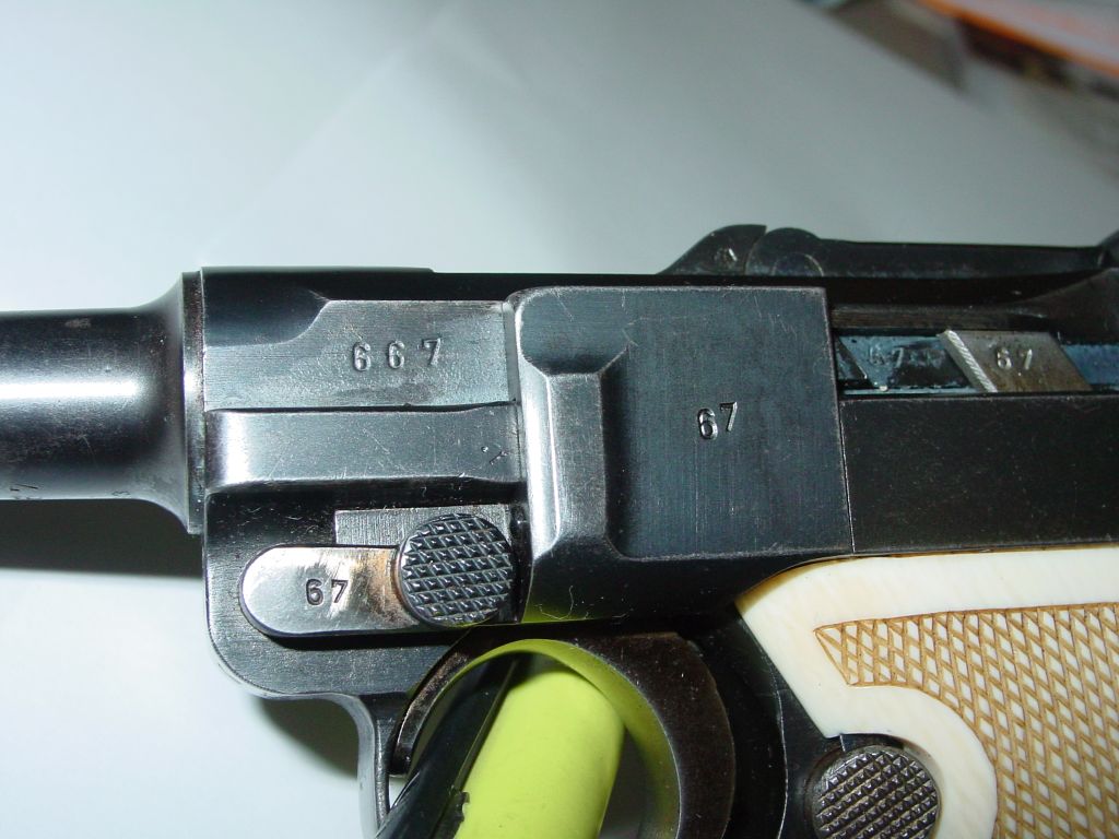

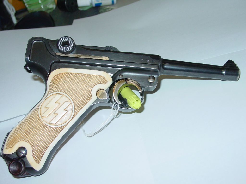

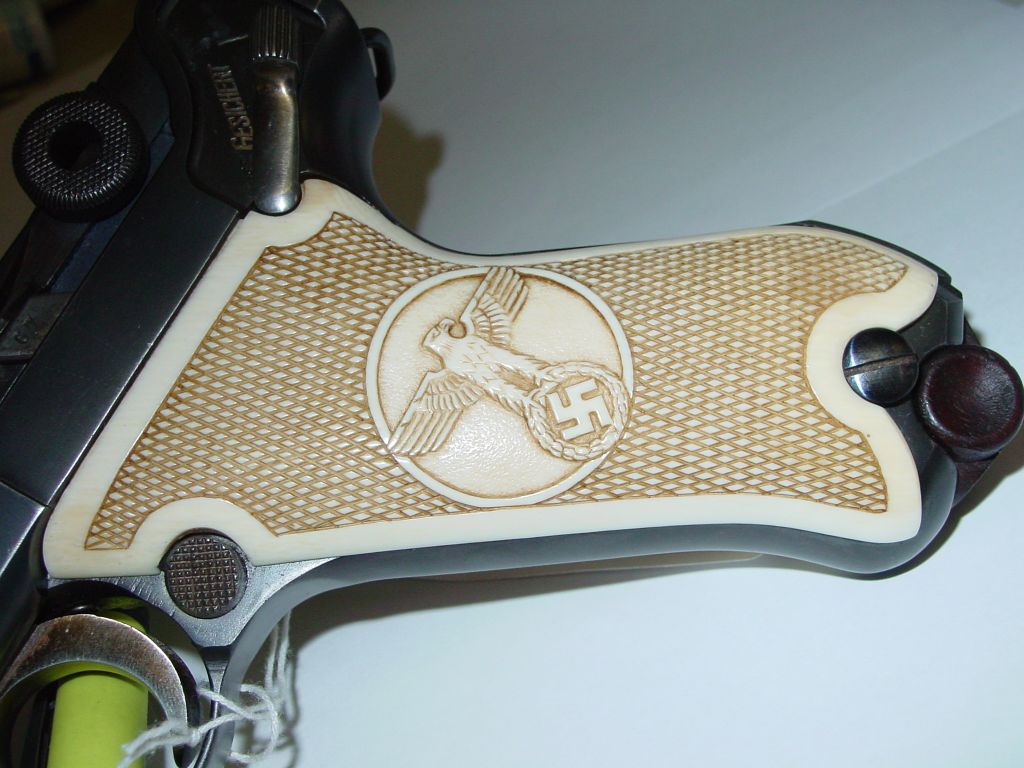

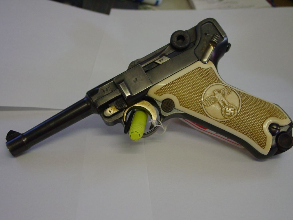

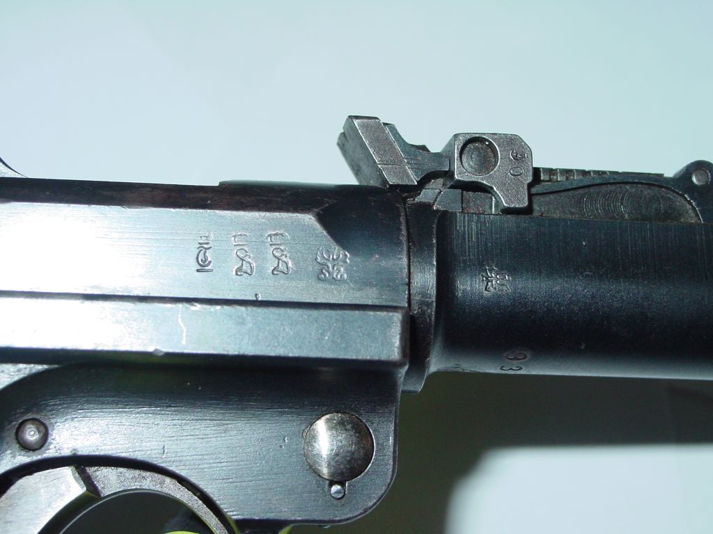

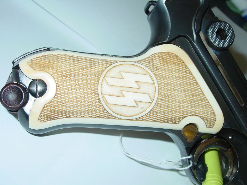

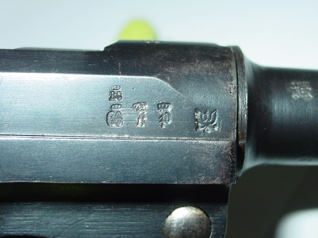

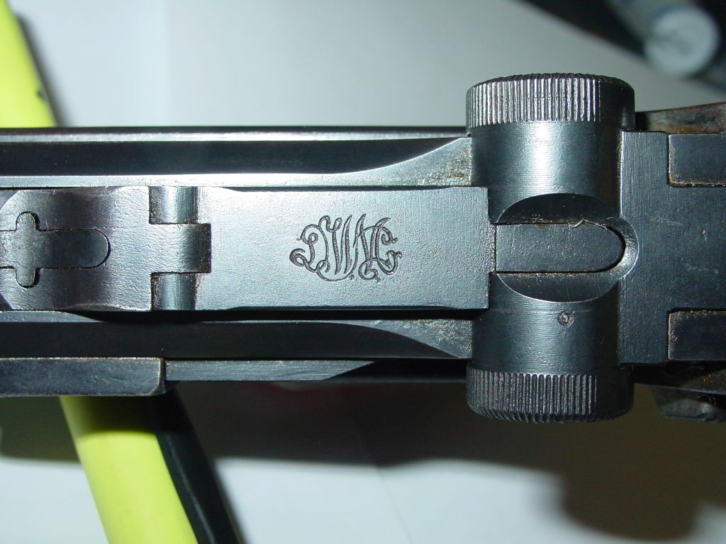

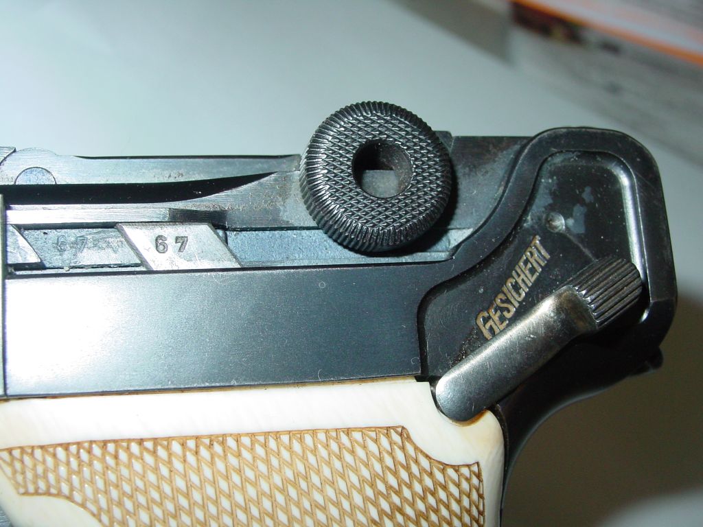

Okay so here are the pics of the 1936 S/42 9mm w/the ivory grips
The last pic is intials that are on the underside of the grips.
Unread 06-30-2008, 02:30 PM   #16
Thanks: 2,078
unless renumbered or reblued the ivory grip one is worth a bit more. The grips, if real ivory are worth less to a collecor and more to someone who wants an obvious swastika symbol on their luger.
Unread 06-30-2008, 05:14 PM   #17
These are very fine grips for those who like this sort of thing but I do not believe they are ivory. They display none of the ivory charecteristics. Cracking, linier strata and the mellow color seen in genuine ivory.
Spectacular Police Eagle though!
Have you tested them?
There is a very simple test, easily done to tell you exactly.
Unread 06-30-2008, 05:39 PM   #18
Tac, Yes! If it smells like plastic it is..if it smells like burning hair it is ivory. Just a slight touch with a needle or pin heated to red hot with a candle or match on the back and a puff of smoke..enough to smell. Easy enough for anyone to do and foolproof.
Unread 06-30-2008, 07:13 PM   #19

Who was it that use to make these? Use to see them in the North East shows many years ago. Always had a table at the Baltimore show.
Well, I don't think they are real but I sure would like to see Tac skate backwards
Vern
Unread 07-06-2008, 12:21 AM   #20
Big Norm
Location: SE Michigan
Posts: 1,864
Thanked 6 Times in 5 Posts
Hey Vern, I'm with you on watching Tac skate backwards, blindfolded and around the CN tower while munching on some ivory grips with sauce on them. Do you have any idea where we can hire someone to make real ivory repro grips and substitute them on this gun. (Hee! Hee!) By the way, whats the CN tower?
Joking aside, some people do go crazy over unusual grips. I know that I have a pair that I regard as 'Trench Art' that are real neat. Both sides of these original wood grips have a two inch Prussian Eagle nicely carved on them. I had them on one of my chamber dated 1914 DWM artilleries and have long debated about taking them off because they are so cool.
Then again, I have a set of grips with some real neat stags carved on them that I got with a commercial Luger that I bought. Maybe I should start a side collection of various Luger grips.
I have also seen guys at gun auctions and estate sales go nutso over grips with various nazi symbols and coins. Now I am not saying that the grips in this thread are either original or even ivory. In my heart of hearts, I believe what you said about seeing some seller at a gun show selling these type of grips. But then again, it keeps going through my head that General George Patton had ivory grips on his pistols.
Big Norm
