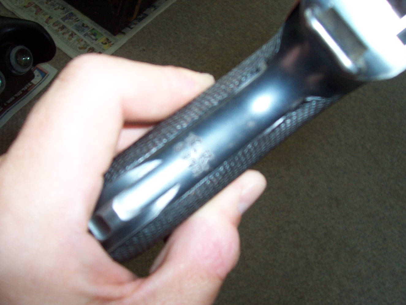

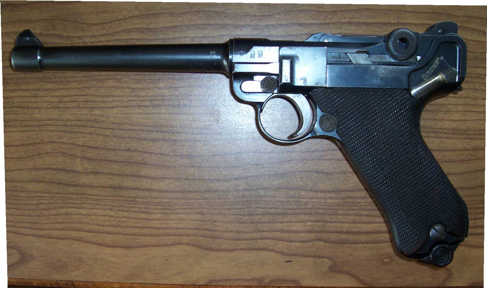

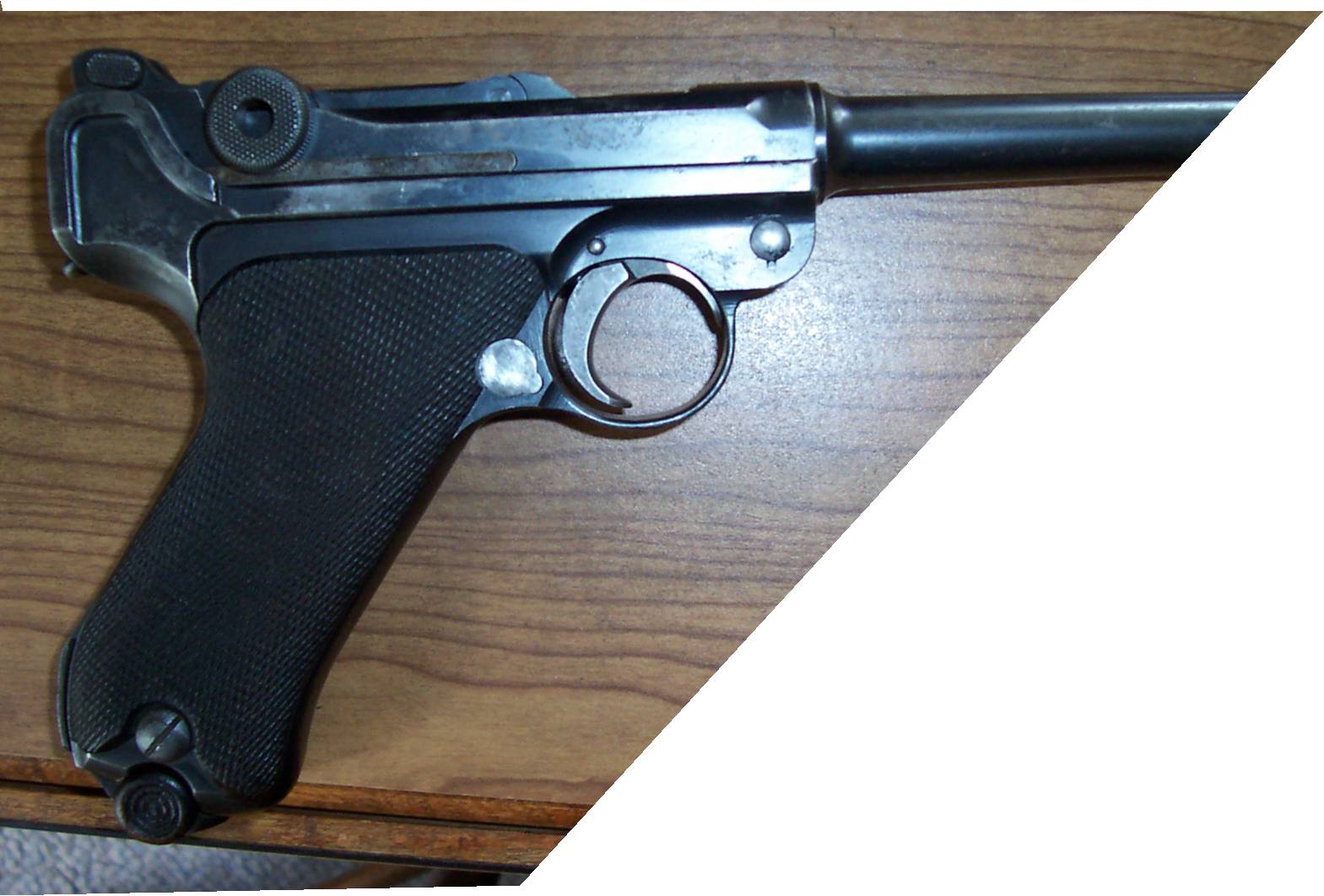

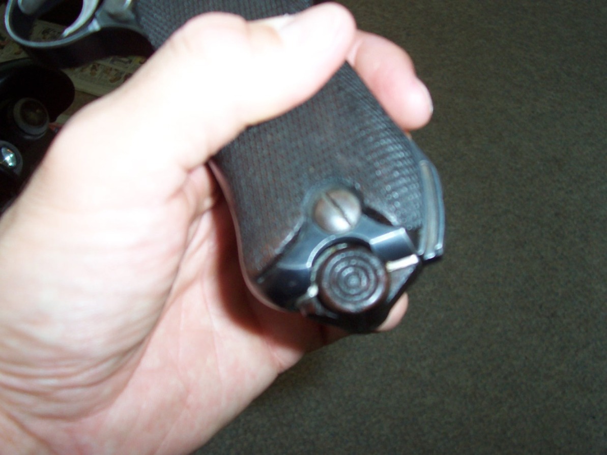

Here of pics of this Luger I posted about. It is from a living vet. It is his luger. We broke it down and all the numbers on the inside are matching from what we could see. All the outside numbers match as well. The magazine had a two digit number that did not match though. It is a DWM maker.
P.S Damm. It won't let me upload my pictures. They are too big. They are on gunboards under the military pistol forums same id (quark). Can I e-mail them to an expert so they could look at them?

clearer photos of the left side and rear markings are needed.
Not to doubt your friend, but lots of fake navies out there. Is the barrel matching (I ask because of the 4 inch barrel shown in the pictures).
it looks like a nice rep piece, probably worth $2000-$3000 if all matching, as its condition looks a bit rougher.....

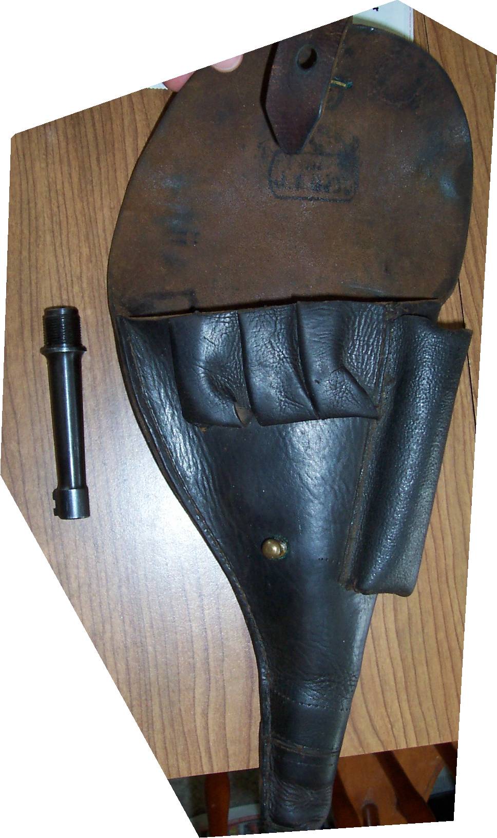

Yes, The six inch barrel is mathing the rest of the pistol. He said the 4 inch barrel was picked up at a latter time and does not beylong to the navy luger.

Here are the photos sent to me... the same one's that appear on Jan's forum.
As Ed said, they are not quite clear enough to determine originality, but they are worth a look. Unfortunately, their phsyical size will distort the discussion frame, but all the detail that is visible in the photos will be seen here. I suggest you take some better photos... try and see if your camera has a macro mode. take the photos outside in good light, but not direct sunlight, and make sure they are focused. Clear photos of the stamped areas are essential to a good identification.
A very unusual holster... looks like it was made from parts of a four inch holster that was extended to accomodate the 6 inch barrel.

Your gun looks technically OK, It is what we call a 1908 variation , long frame with out grip safety.
These guns fall into a specific serial number range.
Could you please tell us what the serial number on your gun is, include the letter suffix if any under the SN as this is important. The suffix should be on the frame and bottom of the barrel.
The back edge of the left grip looks a bit strange to me and I am wondering if this gun might have had a grip safety at one time?
All of your pictures are just blurred enough to prevent us from telling you all is OK. You have come to the right place for help but understand we can not see the guns details. Your off to a good start, do yourself a favor and complete the review before you purchase.
