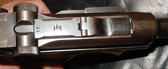

BYF 41 non-matching, seller claims excellent mechanical condition, $700. It's what I was looking for, a shooter from WWII with Nazi proofs. Is that price too high? How does the gun look? Opinions? Thanks guys.

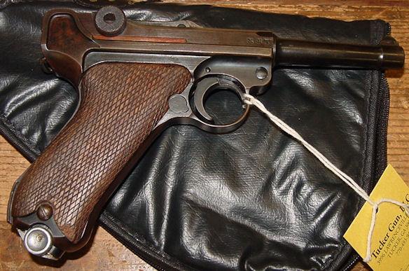

Second pic:

It doesn't look abused to me, so may make a fine shooter.
Prices, have just gone crazy lately, I don't think $700 is all that bad. You could have a very long wait to find one in as good a shape and cheaper. They are out there but people are parting them out to make more money.
A couple of months ago I sold my two Erfurt shooters for $500 each, they were buffed/sanded to death guns with almost no finish left of the cold bluing that was once applied. They sold very quickly; sure I only had $400 and $450 into them and made a little money but I think I could of made more. Now I am without a shooter luger and am faced with much higher prices to replace them.
Do you have access to the gun?
Make sure your getting an action that is not binding, the barrel looks replaced to me and that is good for a shooter but if they twisted the frame getting the old one off, it will be a pain to get it straighten again and cost you more dollars.
Get a return policy.
They are not going to let you shoot it, but you will be able to quickly tell if there is sever binding by cycling the action by hand and inspecting for internal ware.
My two cents worth

The upper receiver may be from a byf 41, but the lower receiver (grip frame) while manufactured by Mauser is not a 1941... the P.08 that is normally stamped on the left side flat is missing...
The grips are horrible and don't even match each other. The left side checkering looks like it was done by a convict with a contraband knife...
I think $700 is a little too high for this one... take the guy less in cash and see if he will deal. If it shoots okay, some new grips would perk up the image a little, but I would not invest any money in refinishing it.
Let us know how you make out.

You're certainly a gentleman. I would classify this gun as a lot of loose parts flying in close formation. Assuming that the magazine catch is fully engaged, there seems to be an excessive gap between the magazine bottom and the frame. Whether this is due to wear on the magazine release and/or the slot in the magazine body is hard to tell, but it could indicate a feeding problem which hopefully, didn't result in "throating."My opinion is that any money invested on improvements would ony compound a a situation in which the price is at least twice the realistic value of the gun. I strongly agree that cash can work wonders and I wish him luck.

The whole shooter Luger idea is an interesting study in value... First, it has to have a certain negitive degree of faults or condition to even enter this arena.... While matching numbers are always desirable, if it is a shooter, some serious cosmetic flaw, or lack of condition has already rendered this point to be nearly moot... So lets take the very best case scenario for a shooter, either a very nice original condition, either matching or non-matching... with, lets say a big nasty rust spot on the grip frame, or receiver.. I only used this for an example because I think we all hate rust equally... The pistol, to me, at this point, is only worth the retail value of the sum total of it's sellable / useable parts.... so lets break it down.... 75.00 to 100.00 for each the barrel, grips, sideplate, clip, frame and/or receiver, and small parts... maybe 125.00 for the toggle train... give or take 25.00 here and there depending on condition... it would seem that around $700.00 would be near the top end for any 4" barrel shooter, everything being pretty nice... Now, lets take a gun that is all buffed, reblued, rusted, or otherwise ugly to all but its mother! The parts can barely used for what they are now doing... it would seem that even $400.00 is a lot to ask?? I opted for a nice shooter, all made from byf parts, that were also nice... some assemblies match, some don't, but condition is all important to me..My shooter probably is at the $700.00 mark... but I would find it hard to ask more if I was going to sell... just a little different way to look at it, best to all, til...lat'r....GT

I must say, it's absolutely amazing how knowledable you guys are to be able to pick this gun apart with just two pictures. Per the seller, it only has two different serial numbers on it, so it doesn't sound like a total mismatch.
Grips would be the first thing to go. Are new grips expensive and hard to come by? How would you rate the finish on this gun compared to other shooters? I'll see what I can do with the price, but it sounds like I shouldn't lose too much sleep if this one falls through. I just got my first Luger book in the mail today, i'm trying to learn as much as I can asap so I don't have to post every Luger i'm interested in for you guys to critique for me
