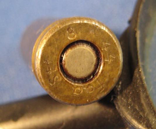

I found a few rounds of old 9x19. Could you tell me something about it? who made it, when, and what's the meaning of the markings? or any info.... thanks!
P.S. sorry, the quality of the picture is not super:
Top is "8"
Bottom is "faa"
Left is "st+"
Right is "44"

faa is the maker's mark: Deutsche Waffen- und Munitionsfabriken, the Karlsruhe division (DWM).
8 is the lot number, 44 is the production year (1944).
St+ shows it is a steel case, loaded with the improved coarser powder.
So it's original WW2 ammunition, made by DWM for the German army.

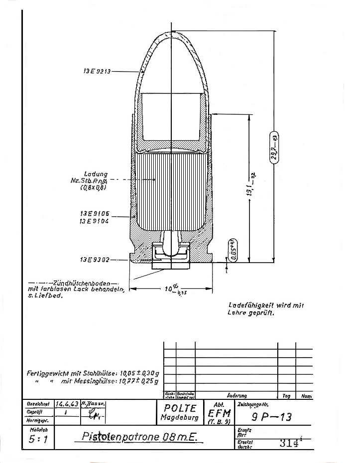

This is a recent touch-up I did of a design drawing from one of the German munitions manufacturers Polte of Magdeburg.
I used a copy from Lewis Curtis (http://www.gigconceptsinc.com/RefInfo9mmP.html) as a basis.

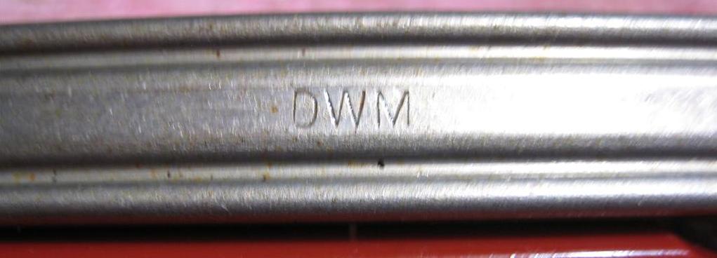

No wonder those ammo came with a DWM marked clip.

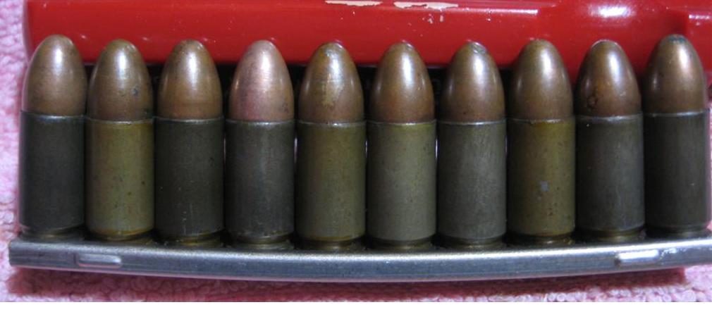

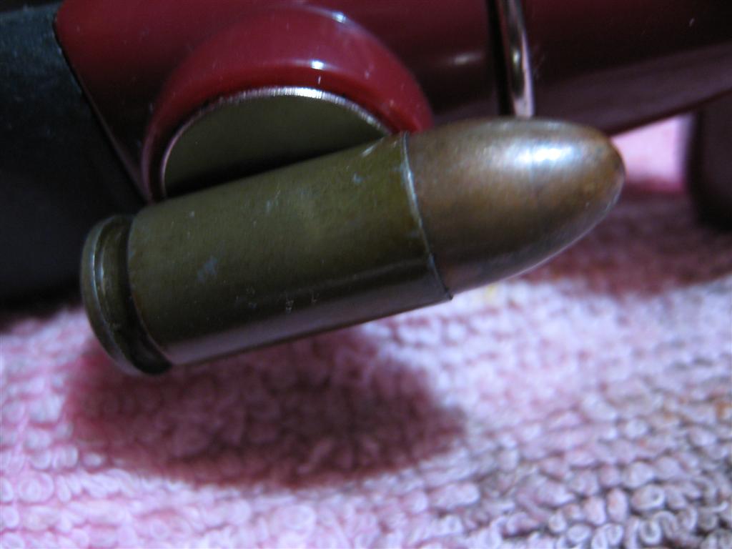

I just tried a magnet... yes, it's steel. The color of bullet, hard for me to tell, pictures below show pretty much accurate color in my eyes.

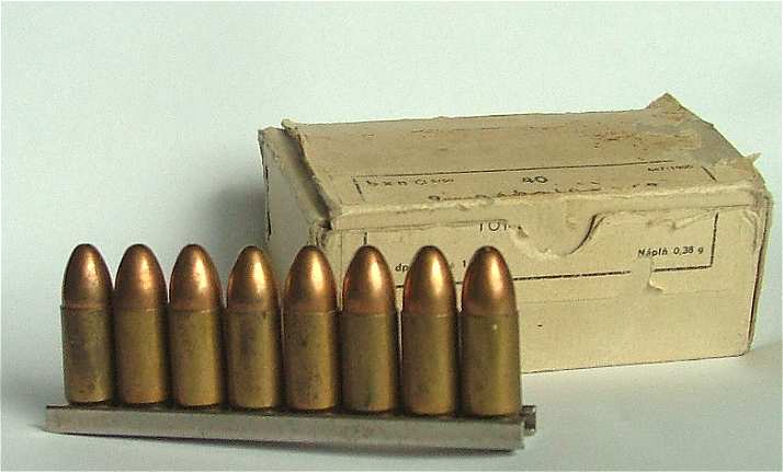

Not too common to find late-war German 9mm rounds on clips, may have been a later combination. Normally they were distributed without clips in 16-round cardboard boxes, enough to fill 2 magazines. The combination of clip and rounds can be explained (this is mere speculation on my part) by use in a 9mm Mauser C96.
I also have a boxed set of steel bullet copper washed 9mm rounds on loading strips that were produced by Sellier & Bellot shortly after WW2.
The German made bullets shown in your photo are copper washed which is in line with the 1944 date. Most 1944 dated bullets in my collection are copper washed rather than painted black.
