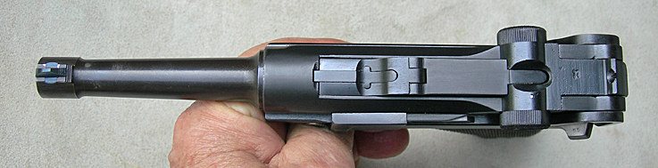

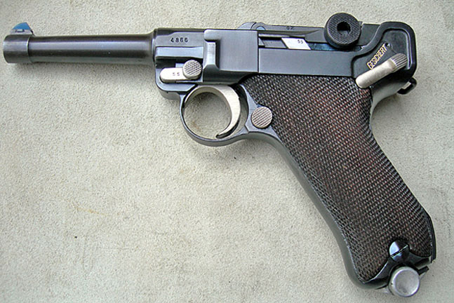

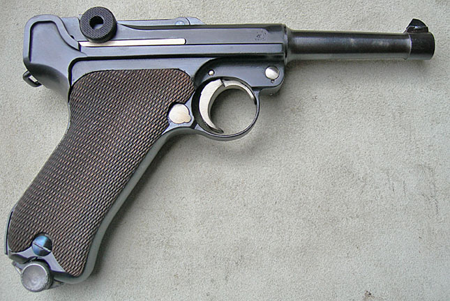

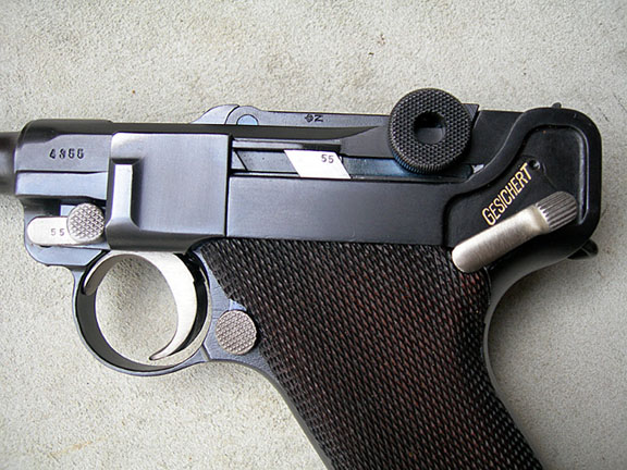

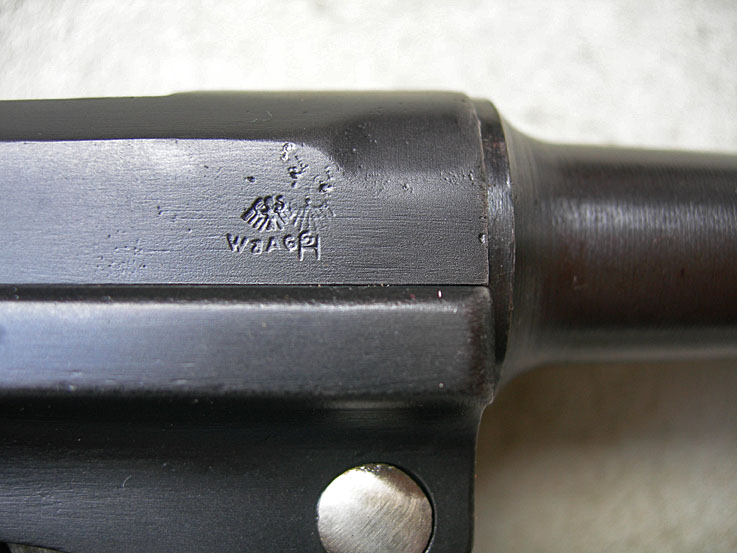

This is 9mm, no date, blank toggle, SN 4355e. The take down, safeties, trigger, bottom of the sideplate and left grip are numbered 55. No numbers on any other parts. The bore is pristine. It has been restored by Thor.
According to Costanzo, the proofs on the right receiver, WaA66=1933 Simson military proof, and DE H=1933 Simson Heres acceptance mark.
The SE 823 on the bottom of the bbl are "independent manufacturers code" for suppliers of bbls. The 8 is the month (August) and the 23 is the year.

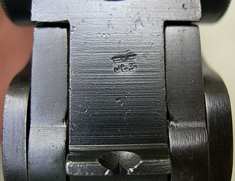

The breech block has two DE6=Simson 1923-25 military parts proofs; the middle toggle has a Crown lazy N and the rear toggle has SE Jt3. I couldn't find this exact mark in Costanzo, but found a similar one that indicated a 1928 Army depot proof.
I believe this gun to be a 1933 Simson rework using a conglomeration of parts. Would appreciate any corrections or comments to help in identifying it.

You have brought us here an example of the places in Costanzo where current research and understanding have displaced his speculation.
The WaA 66 is an acceptance mark of the Heers Waffenamt. It starts showing up on 29DWM procured by German police organizations. The Eagle/H mark appears on several 29DWM in association with the e/WaA66; it is most likely the stamp of an individual inspector within the Waffenamt.

The e/Jt.3 on the rear breechblock is the stamp of a Heers Zeugamt (Army Weaons Depot), depot 3, at Ingolstadt. A stamp on such a large part would usually bear a stamp with the entire HZa designation, eg: e/HZaJt.18, for Depot 18 at Ingolstadt. The stamp usually certifies work done aby the depot, such as parts replacement. Without an additional parts manufacturing inspection stamp--such as an e/6--it is impossible to know the parts' origin.

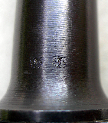

Thanks for the lesson! I have added the bbl proofs picture, I had it, just had overlooked that it wasn't there! Can't find any other marks on it.

Hugh, I believe that the E/823 inspector's mark under the barrel is rather an E/623 indicating a WW2 era Steyr made barrel, that may have been installed by the Army Depot at the same time as the replacement rear toggle link. Lugerdoc
Unread 05-15-2008, 11:41 AM   #5
I think the eagle 623 was brought up on Jan's forum a year or two ago, it "looks" like an 823 but its really a 623...

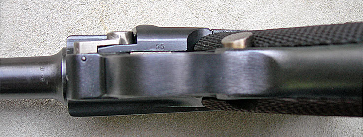

I have added a pic of the breech block marks.
