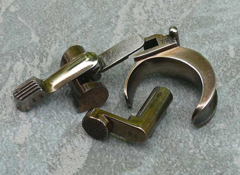

Luger Forum noob here, 1st post.
After multiple google searches I discovered there are waay more "re-strawing is so easy" posts than actual "how-to re-straw" posts.
Got a handle on the theory and gave it a try. Absolutely shocked how nicely small parts color up using a heat gun. (..toaster oven directions got me nowhere, almost gave up).
Not molesting a collectable Luger.. picked up one of the Russian battlefield pick-ups back in the early '90s. Protruding frame rails had been very crudely filed when refurbed.. minor pitting throughout, not so minor pitting in a few areas, orig grips replaced by the cheesiest plastic grips I've ever seen. Numbers matching though (except mag) and the bore looks serviceable. Always intended to make it a nice looking shooter. Just getting around to it.
Thanks to Luger Forum this pistol is making progress.

Hmmmm, procedure for photos is a little different here. Just snapped this Q&D during lunch, let's see if I can make it come up.
Colors not looking too defined on my monitor. More "colored" looking in hand.

Danny,
Hot damn! (no pun intended....)
I like your results.... I too have been looking for a way to straw parts on my shooter and it seems you've got the job done! I can't wait to give your method a try.
Just curious: What type of surface did you put the parts on before you applied the heat gun?
Did you "quench" them once the desired color had been reached?
Finally, did you apply heat to all the parts at the same time or did you heat them up one at a time?

My small bits were blued, so I pulled on my nitrile gloves and covered each part (one at a time) w/ Naval Jelly rust remover gel. Blue melts off immediately, used a stiff bristle brush then 0000 steel wool while Naval Jelly was still covering the part. Each part took only a minute or two.
Used sequentially finer sand paper (400 to 800 grit) to smooth out pitted areas, taking care to leave sand marks all running parallel to original sanding or filing direction. Did a final polish w/ semichrome and 0000 steel wool on areas I wanted to "shine up" a bit. (All work by hand to remove absolutely as little metal as possible)
Once each part looked good to me I cleaned w/ spray brake cleaner & dried completely. (clean nitrile gloves on again) I held larger parts w/ needle nose pliers, smaller parts w/ tweezers, and warmed each one up (taking care to heat the entire part as evenly as possible) w/ a cheap paint stripper type heat gun. Only took 2-3 minutes for each part to go from cold to hot enough to begin coloring up.
I've read that 3-in-one oil works well to quench parts. I had an opened container of brake fluid on the shelf though.. been open too long to use in the car, so.. Sure enough, it did fine. Just filled a glass tumbler half full (don't tell the wife) and dunked each part in once it was a nice honey color.
The absolute beauty here is that this colored surface is so very thin that it's easily polished off if you end up going darker than you intended. A polish w/ semichrome brings you right back to bare metal to start over again if you need.
Obviously wear proper eye protection, work only in a well ventilated area, don't stick the heat gun in an eye, carry an umbrella at all times, blah.. blah.. blah..
Honestly, life sized in the hand these parts look nicer than they do enlarged on screen.
Anyone with enough sense to know which end of the tube the round comes out of can to this.
If I can do it...
